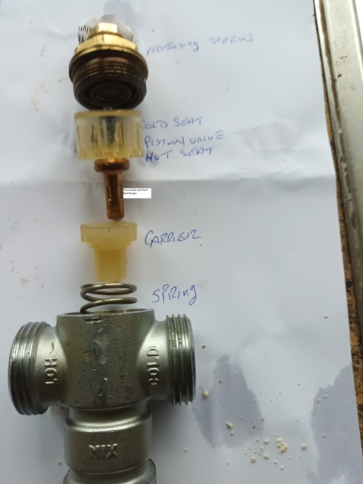

I am commissioning my Wunda UFH. All the flow rates have been set up as per the design.
No matter what I set the blender to the flow temperature rises to 50c and drops to 30c as the boiler cycles. In addition if I set the blender to minimum the flow rates on each circuit drop to below 1 L/m from 2.1 and 2.5.
With a remote thermometer the flow temp of the pipe from the boiler as it enters the manifold is about 48c. The 2 flows on each circuit are the same. It's as if the blender isn’t doing anything. The floor is getting above the recomended 27c.
Wunda Tech Support are going to send me a new blender but they say the recommendation for the pipes from the boiler are 15mm and I have 22mm. I'm only using 2 ports on a 4 port manifold with a combined UFH loop of 220 metres. They say this maybe overwhelming the manifold and I should replace the 22mm pipes with 15mm
Anybody else had this problem?
What is the boiler minimum output and make/model?. even if averaging a dT of 10C and a flowrate of 2.0LPM per loop then the UFH demand is still only 2.8kW.

Presume boiler flow/return piping to manifold connected correctly?, the blender does seem to be moving a least manually since the flowrates change even though they shouldn't, the TMV shuttle should throttle off one side flow and increase the other side depending on mixing requirements.

This is a fairly typical example of how a TMV works, its far easier for the shuttle to jam/stay in the cold position as the spring pushes the shuttle to open the hot side port and close the cold side port, the hydraulic piston can exert tremendous force to close off the hot side port so far more likely to jam in the cold position due to a sticking shuttle in the valve body O ring.

Thanks everyone for your suggestions. Lots for ne to try, plus a replacement blender valve has arrived. She who must be obeyed has decreed no more UFH work until Monday. I'll provide an update on progress next week
If you wish, you can do a few tests on that new blender valve, turn it to minimum and pour some cold water into the mixed outlet, water should exit from the hot port?, increase the water temp to a few degrees above the minimum setting and see if no water comes from the hot port now.
