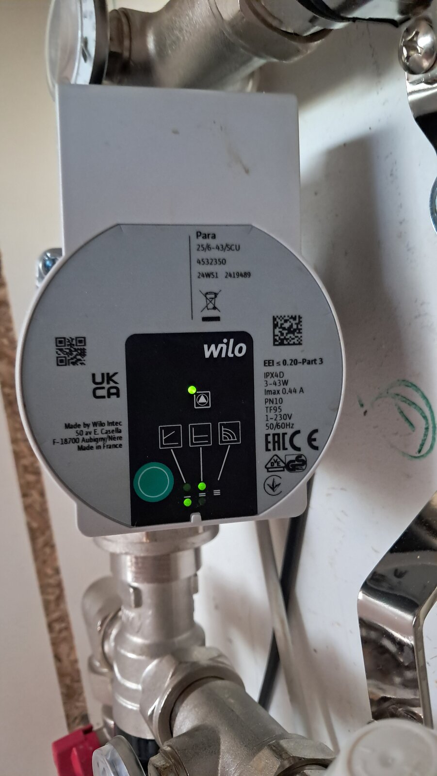

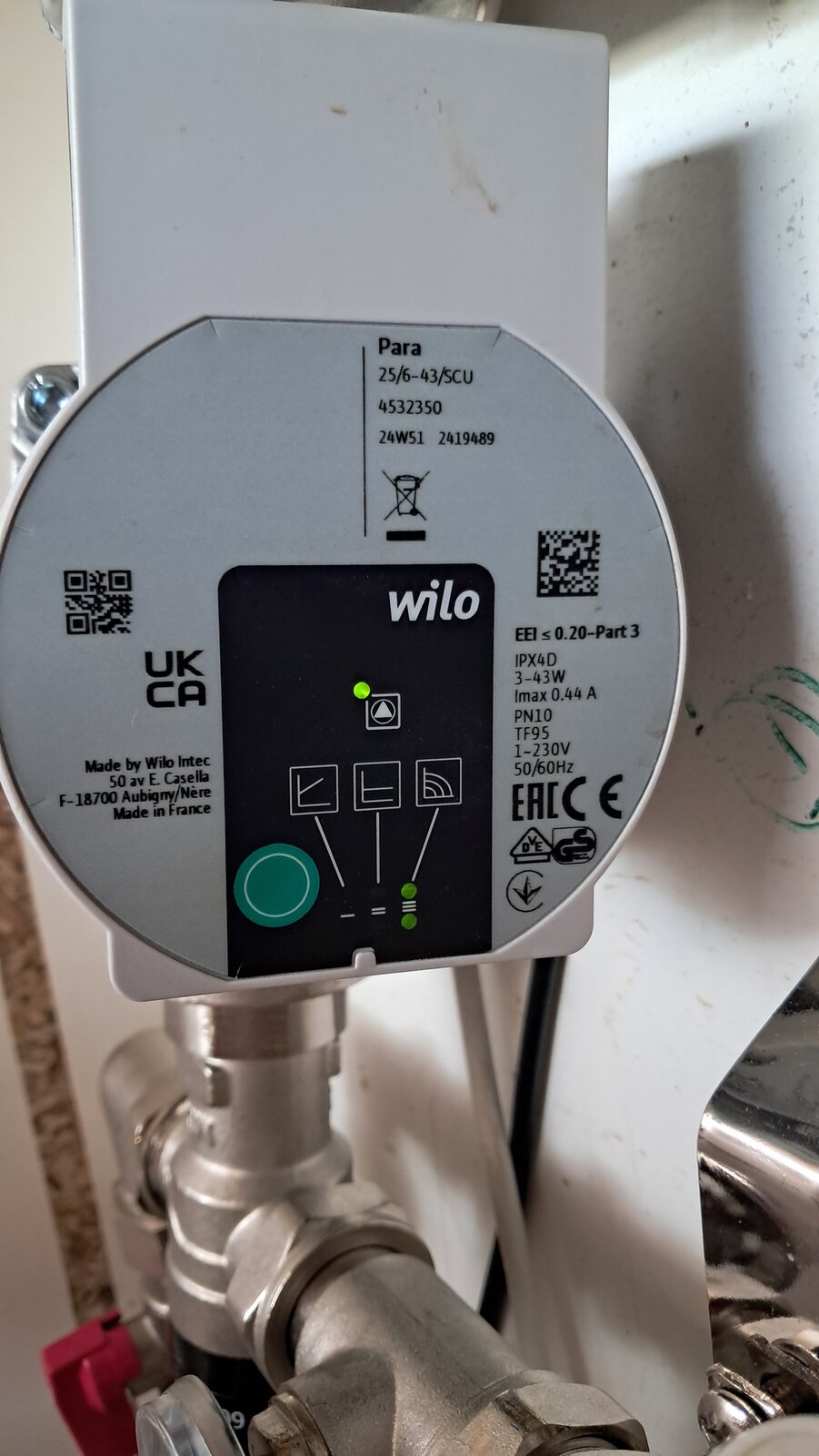

I looked at the pump Wilo-para ma 20250511_105809.jpg20250404_093218.jpgnual but to be honest I don't really understand it. It was set as in picture 2(2 leds diag) . I think this variable differential pressure. I cycled through the settings until the pressures didn't drop see picture 2 (3 leds in row) I think this is constant speed. Everything seemed to be working OK. Blender set to minimum water temperature not going above 35 loop pressures maintained. You can hear the pump so not sure I have got the correct settings.
I'll contact Wunda on Monday and see what the pump should be set to.

I looked at the pump manual but to be honest I don't really understand it. It was set as in picture 1. I cycled through the settings until the pressures didn't drop see picture 2. Everything seemed to be working OK. Blender set to minimum water temperature not going above 30. You can hear the pump so not sure I have got the correct settings.

Photo1 shows the pump off, not running, IMO.
Photo2 shows the pump running in constant pressure (CP) mode on setting 1 (minimum) which may be a little low, suggest changing to setting 2, still on in CP mode, CP mode should work quite well with a mixture of CH&UFH and is certainly recommended if running on UFH only.
That pump may (like my Wilo Yonos Pico) show the power in watts W and even the head in M, post the readings if it does (+settings).

Setting1 on CP mode will give a constant 2.0M head which should be sufficient to circulate 2.0LPM/loop
Setting2 on CP mode will give a constant 4.2M head which should be more than adequate to circulate 2.5LPM/loop or greater if required.
Setting 1 the loop flow rates dropped slightly
Setting 2 maintained the loop flow rates
However the minimum temperature was 40c. I changed the blender and it started to control the temperature of the water. Changed the pump setting to the original and the flow rates dropped. Set it on continuous and setting 2 for the
When I took the cap off the blender the cap was stopping the knob from touching the stop. The new blender has a washer between the cap and spindle so the cap touches the stops.
