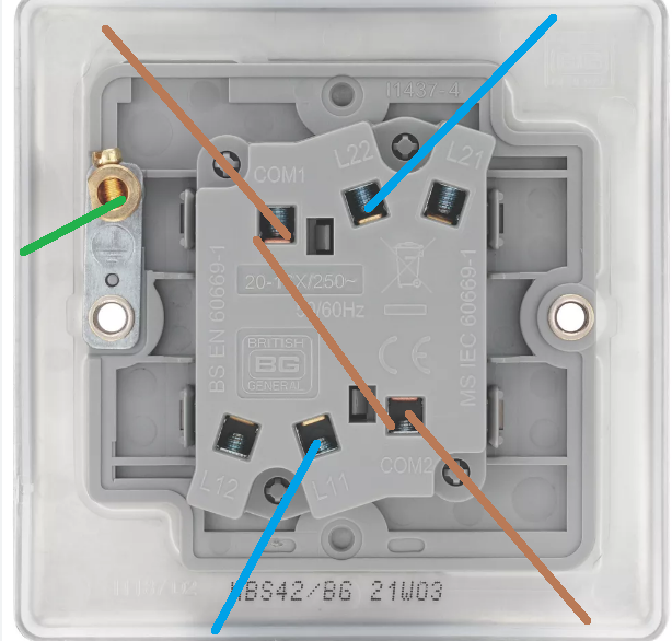

Hi all,
I have a dual dimmer switch in my living room for 2 ceiling lights. I am using LED light bulbs and so the dimmers don't work without the lights flickering so I wanted to change the switch to just a normal on off switch. I removed the old dimmer, wired in the new switch in the same way the other switch was wired and now I am having an issue with one light that refuses to turn off. On the picture it would be the light associated with the switch on the right. Any ideas on why this would be? The dimmer switch worked ok like this. the below is a crude paint sketch of the wiring in the back.
