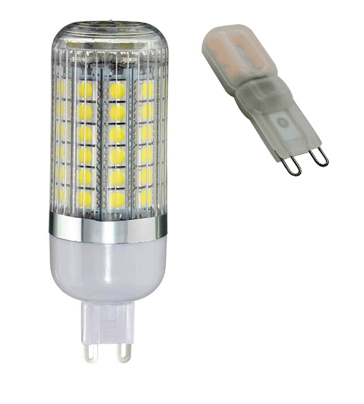

The shimmer when on is a reaction between than lamp and the switch, even in the days of tungsten the coiled coil of wire forming the element has been known to cause flicker, with LED often there is a large capacitor to stop this, G9-comp.jpgthe capacitor in the larger lamp was nearly as big as the smaller lamp, but both are G9 lamps. The problem is there is nothing on the lamp to say how much smoothing is used, I like the GX53 but have not got any fitted, but likely if one is tungsten the other three will work OK.

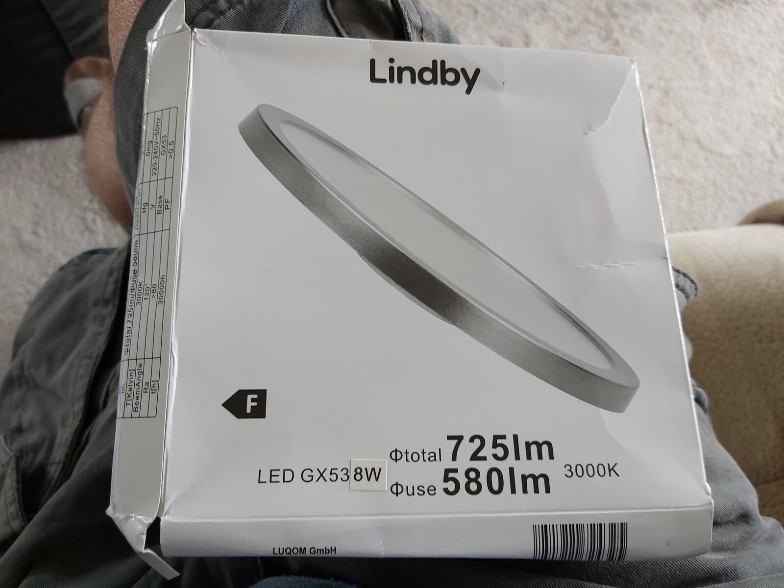

Firstly, I suppose the fitting came with the 4 GX53 lamps already provided?

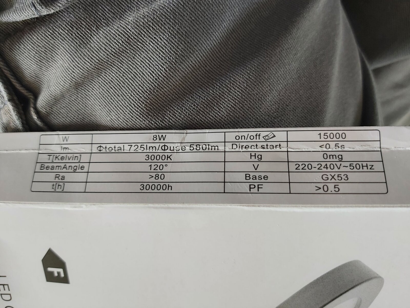

We’re they in separate boxes? Let’s see a photo of any logos on the boxes. And provide a link to the product description.

Lamps were provided in separate boxes - see attachments.

Not sure about Lindby origin now, they maybe German or European; the light was quiet expensive!

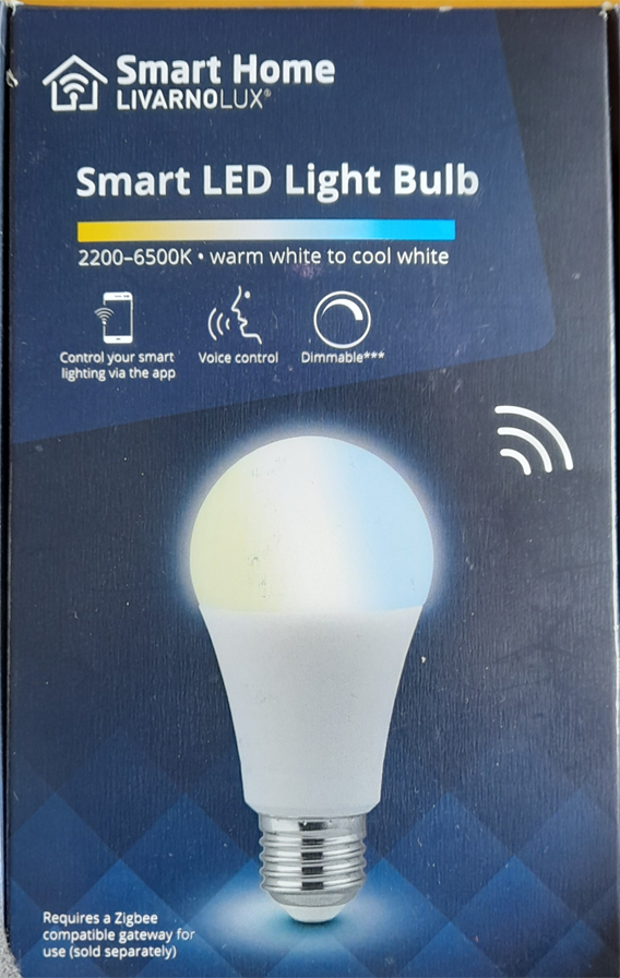

1658844623863.png This package shows
it also says

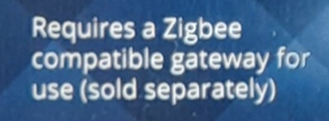

another bulb I have shows 1658843537816.pngbut it does dim with an app, but one does need to read the package carefully even with 1658843329464.pnglogo it does not always mean you can use wave form chopping dimmer switch.
The bulb shown does say in many places that it needs a zigbee controller, but there are many ways to dim a bulb. But I see nothing on the package you show to say it can be dimmed, I know the default should be if it can't dim needs the logo to say so, but can't see anything to say they have to be dimmed with a wave form chopping switch.
The actual light fitting sheet info shows a L/N connection & simply states "supplied bulb dimmable via wall switch" but fails to inform which type of wall switch is required! Agree, if a label shows a lamp is dimmable it should be easily achievable IMO but what do I know. I appreciate not all LED's are dimmable but never imagined there could be different types of LED dimmer switch needed or that it could be complicated, I just thought it would just be a case of buying a more modern dimmer switch & that would work! May be easier if I just resort to replacing the dimmer with a simple on/off switch!
