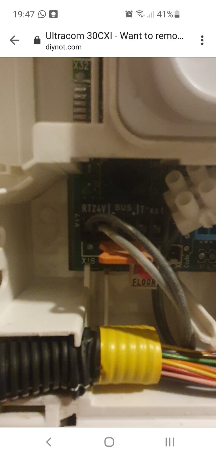

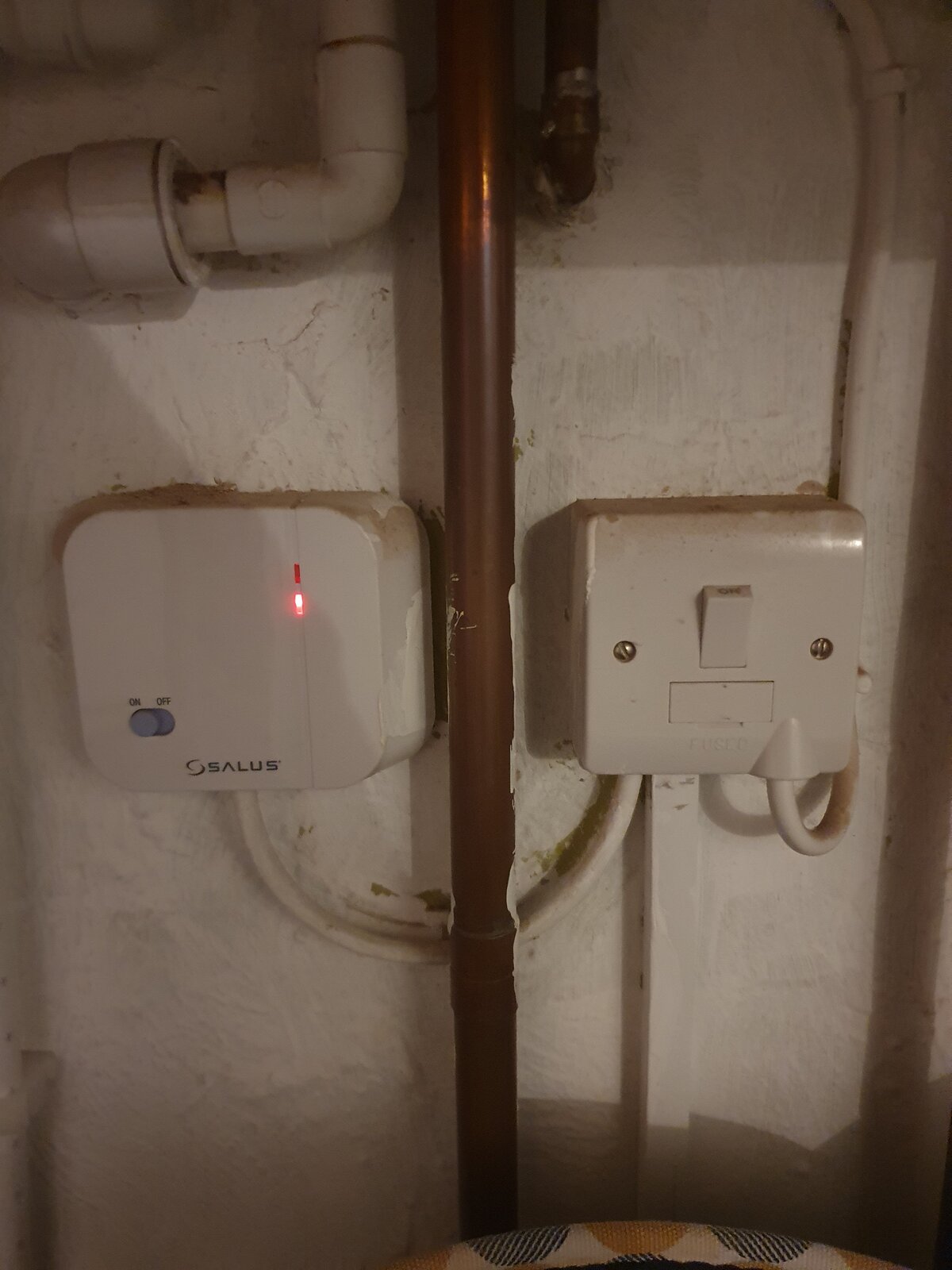

I have inherited a Glowworm Ultracom 2 CXI. It has a receiver for a Salus Thermostat wired into it AND a time clock on the front. The Salus wireless thermostat has never worked. No matter what we tried the boiler would never get a signal to turn the heating on. We tried setting the time clock to permanently on but the Salus thermostat did not override it. So instead we just used the time clock on timer.
I want to install a Nest stat but need to know how to disable the time clock so that the Nest will actually work.

And the wires simply move from the Salus receiver to the terminals at the Hive receiver that have exactly the same function. From your photo it looks like a Salus RT500RF So:
Salus N = Hive N
Salus L = Hive L
Salus Com = Hive Common (1)
Salus NO = Hive NO (3)
You will have to leave the boiler timer set to be 'on' 24/7, and then the Hive will take total control.

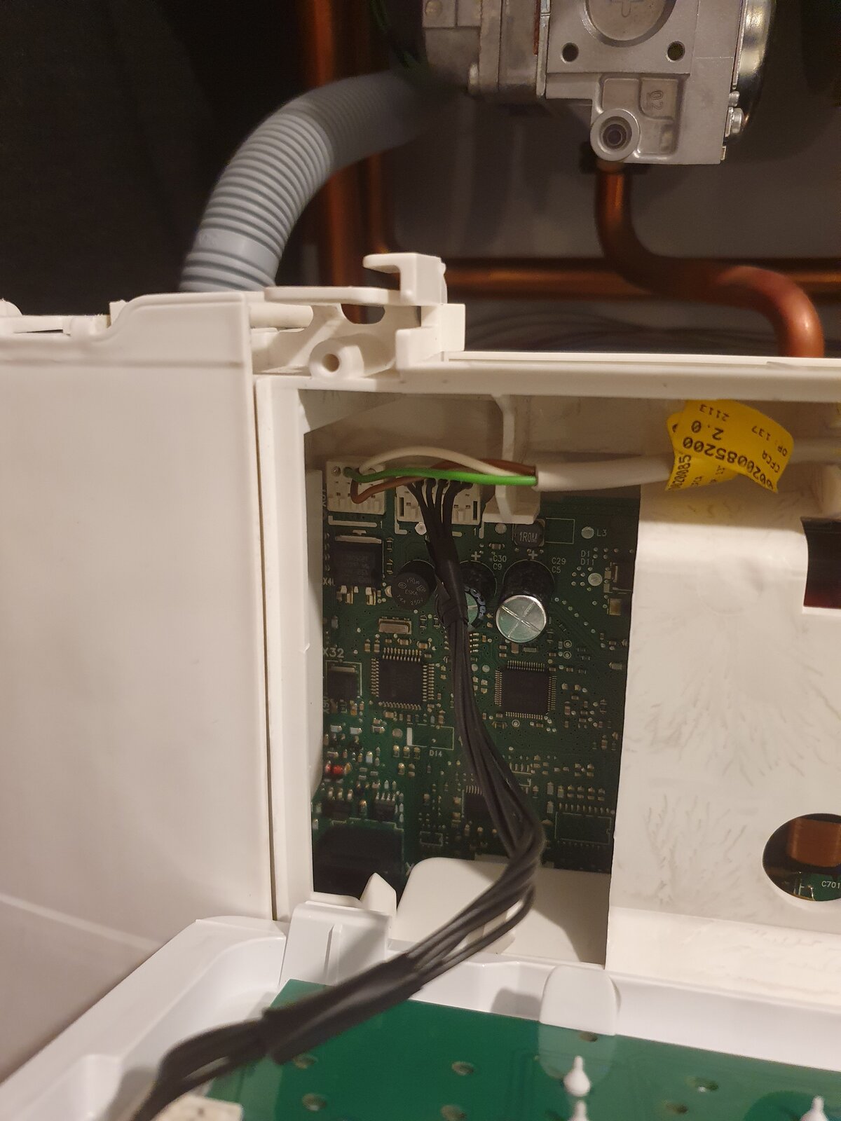

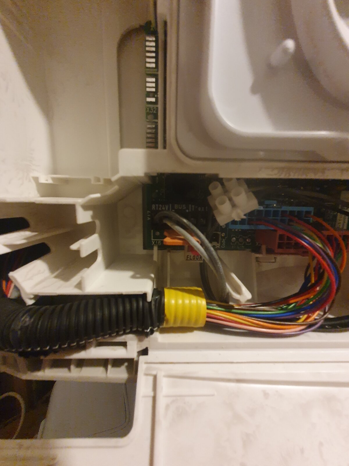

Be carefull what you are doing , looking at your pics of the boiler end , there are no wires in the 230V thermostat switching terminals, so looks like the boiler is wired 24V switching, DO NOT make any links or you will damage the boiler

No it is perfectly normal to wire up using 24v terminal, I meant do not put any links in your nest wiring, many posts on here will show links being used, dont copy them , yours is not wired the same as those
If you are just swapping the existing Salus receiver for a Nest receiver, like for like, exactly as it is now, it won't be a problem.
Reading that again, If I understand it correctly, only the boiler timeswitch turns the boiler on and off. The Salus does nothing. If that is correct, the Salus receiver will actually be permanently 'on' [As the two devices are wired in series, the timer and the Salus would both need to be 'on' at the same time for the heating to operate]
However, it is unusual for a Salus receiver to fail in the 'on' position, normally they fail in the 'off' position. Therefore I suspect that if it has failed in the 'off' position someone may have bridged the Salus wiring to get the heating to work.

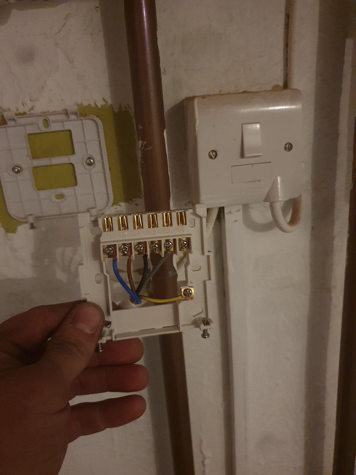

In the back of the receiver, as well as the N & L mains supply, I would expect to see one wire in the 'COM' terminal and one wire in the 'NO' terminal. If yours is different, say for example there is a link inserted between the COM and NO, terminals, or that there are two wires in one of the terminals and nothing in the other that is what has happened.
If you do find anything unusual, and you need further assistance, post a photo of the wiring connections at the back of the Salus receiver.
So having bought a standalone Hive, I have wired the reciever up as was told above, it's all working, as in the thermostat is sending a signal to the reciever correctly, but my boiler completely ignores it just like it did on the previous thermostat.
I have attached the wiring photo for the Hive receiver.
I have tried the boilers time clock on permanent on and permanent off and neither setting allows the hive to take control.

Those connections for swapping a 4 wire connection from Salus to a Hive single channel version look good to me.
However to assist further, we would need to know what each of the 4 wires are physically connected to at the other end. The L & N would appear correct if the receiver is working, but what are the black and grey wires connected to?
I have seen installations where the thermostat was left over from an old installation and not actually connected to a new boiler at all, or a faulty thermostat has had its wiring altered to bridge it out of circuit and keep the heating on. From what you describe the second would seem more of a possibility in your case.
Just a note of caution. If you have to open up a sealed part of the boiler to access the wiring terminals to check, this is not a DIY job. It should be done by a Registered Gas Installer (RGI) who can carry out the necessary safety checks afterwards. However, looking at your photos it would appear not to be the case to me, but my skills are electrical, not gas related.
