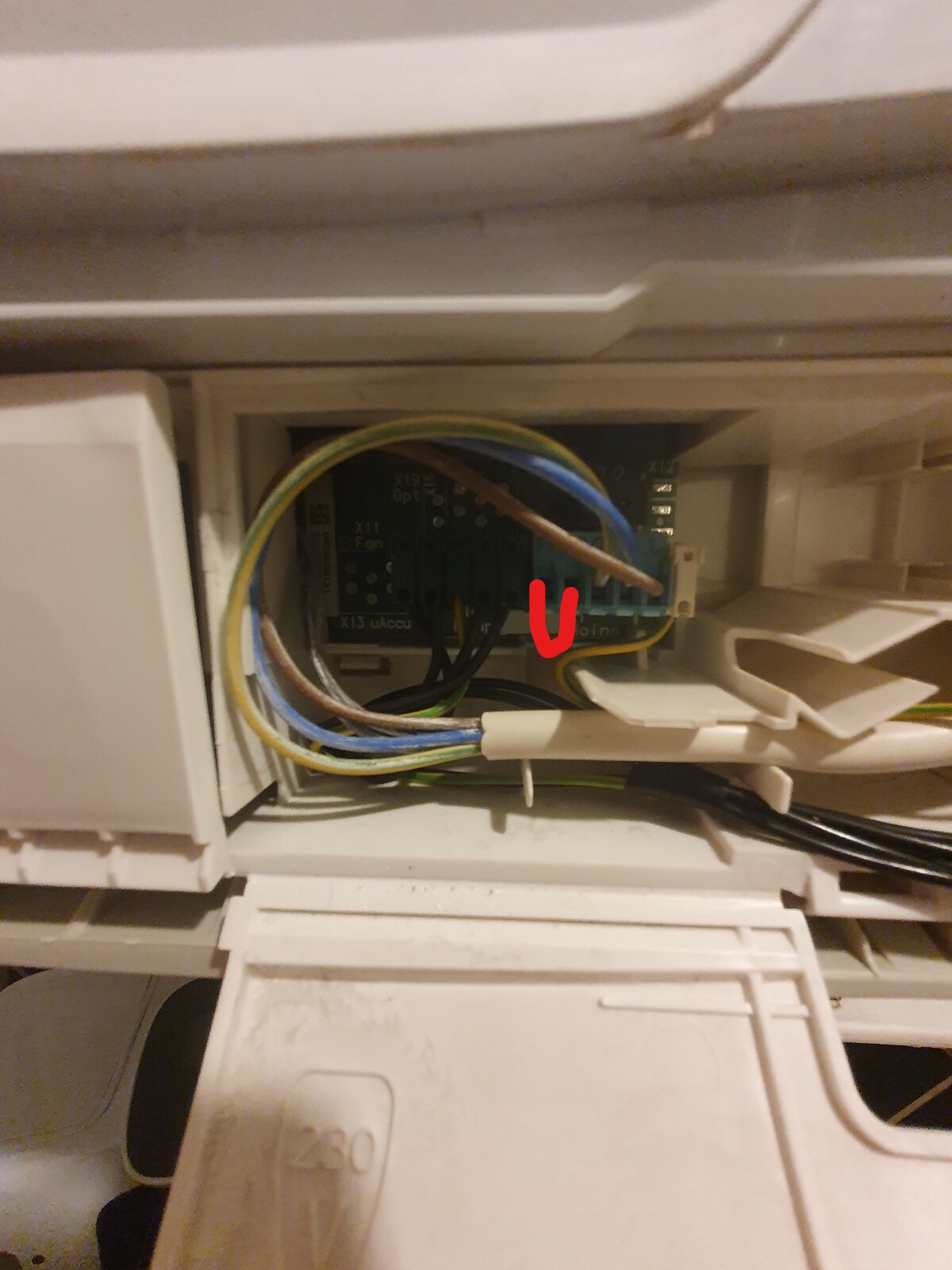

Thanks, I can see that one a bit clearer. So to confirm just the black and grey wires are in the RT 24V terminals, and nothing else. If so, that is correct. It doesn't matter which way around they are.
Looking at connector X1. Is there anything in FP or RT?
fit a short wire link as shown between these two terminald (with the power off) then turn power back on and try your hive now

that link wont have any effect on the hive and receiver, post a pic of the time clock on the boiler and remove that link again

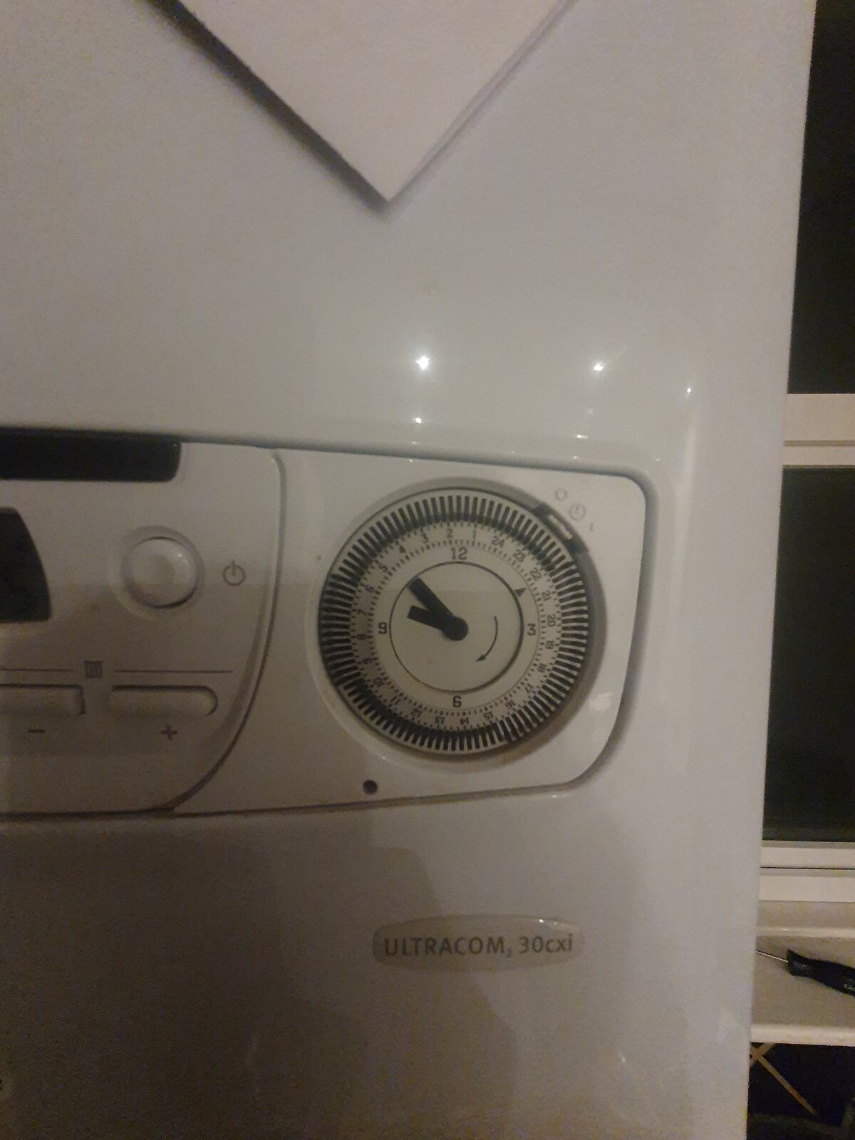

I Ihaveremoved the link wire and attached a picture of clock

You have already been told you have to set that clock to constantly on , it isnt , move the slider to the I position
Yes I did this. I said before it in all three positions, off, timer and on.
I only moved it back to the time of day setting because that's how we have to run it since the hive isn't working.
