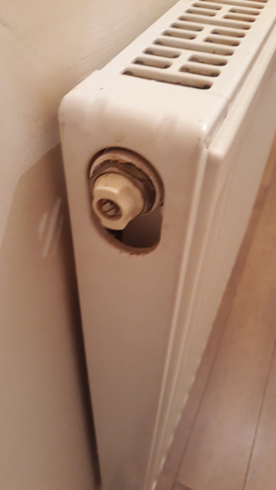

Hello, When i turn the Key the whole lot turns (metal part and the white section).but nothing happens. In the Bathroom I am able to bleed the rad and the metal back part remains still.
Can you tighten the hexagonal part with a spanner and then try it again?
Hello, well with my son holding the spanner and me with the key and jug we managed to bleed off the two noisy rads but alas they were only quiet for a few hours. With one of them we could not hear anything abd just had water coming out - any ideas on that? Maybe we should do it for much longer or could there be another reason they make such a noise? Thanks!
What noise is that, it wasn't part of your OP that they were making a noise. If you can describe what they are doing?
