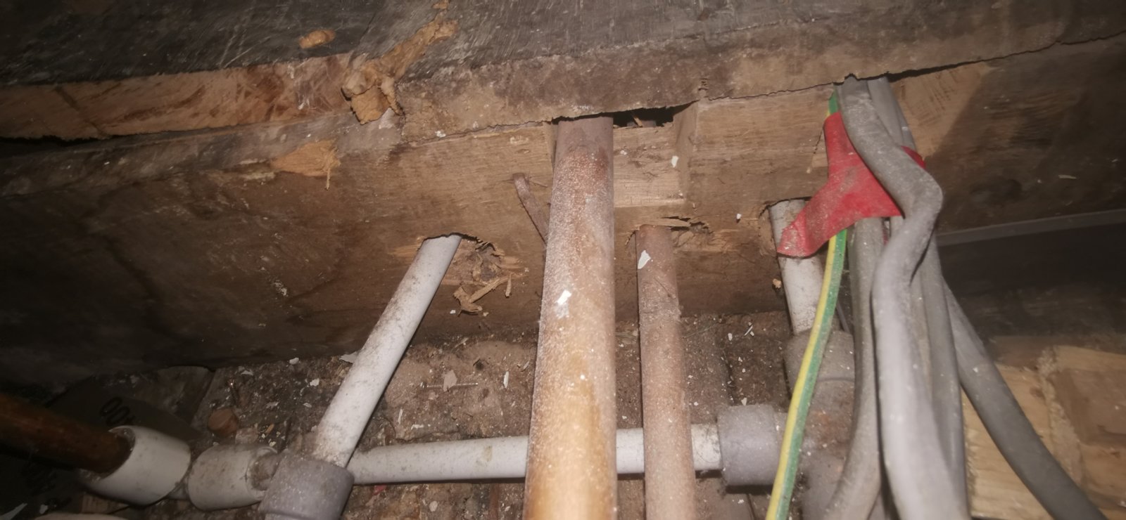

I'm on to the bathroom, not a huge space, approx 3m X 3m. It has old hand cut elm boards of varying sizes and elm joists every 35cm. The board are beyond saving due to moisture and water in that room for many years, and poor maintenance, so I'm reluctantly lifting them to replace with 21mm PTG boards.

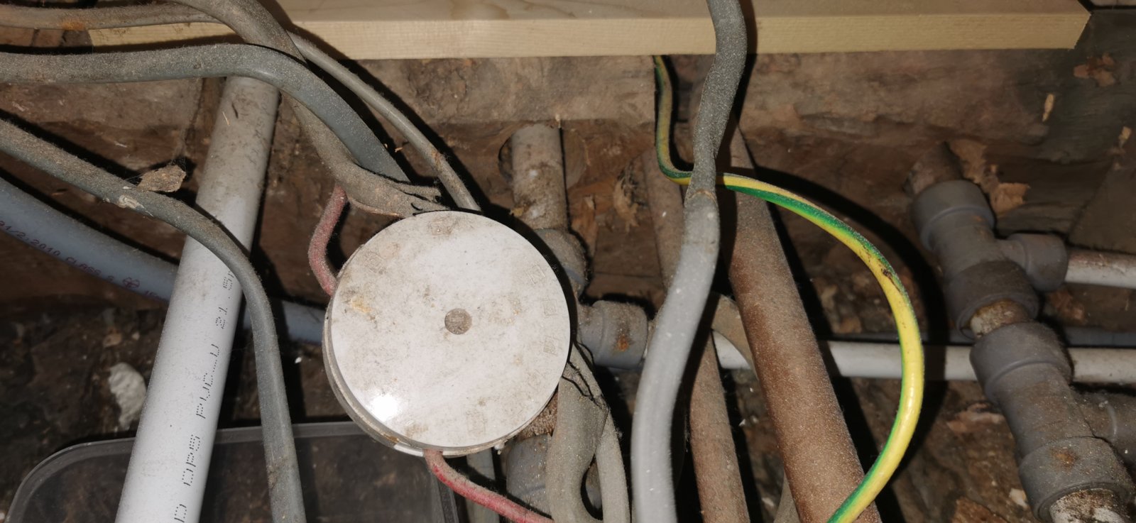

We know it's been messed around with, and not to a very good standard, so it came as no surprise that every joist has been butchered for utilities. I had planned to sister the joists to level them up and remove bounce, bit it's just not possible. I've got enough space to add some long one metre metal straps with bolts and an epoxy resin paste on either side of the joist, but I want to check if you think this will add any value or if it's a collosal waste of time and energy.
The floor has a bit of bounce, but no other signs of splitting, despite not much wood left on some ends(!). The floor must've been like this for 30+ years - and the joists are rock hard, to the point of being tricky to get screws in.
I'd value any comments and suggestions.
