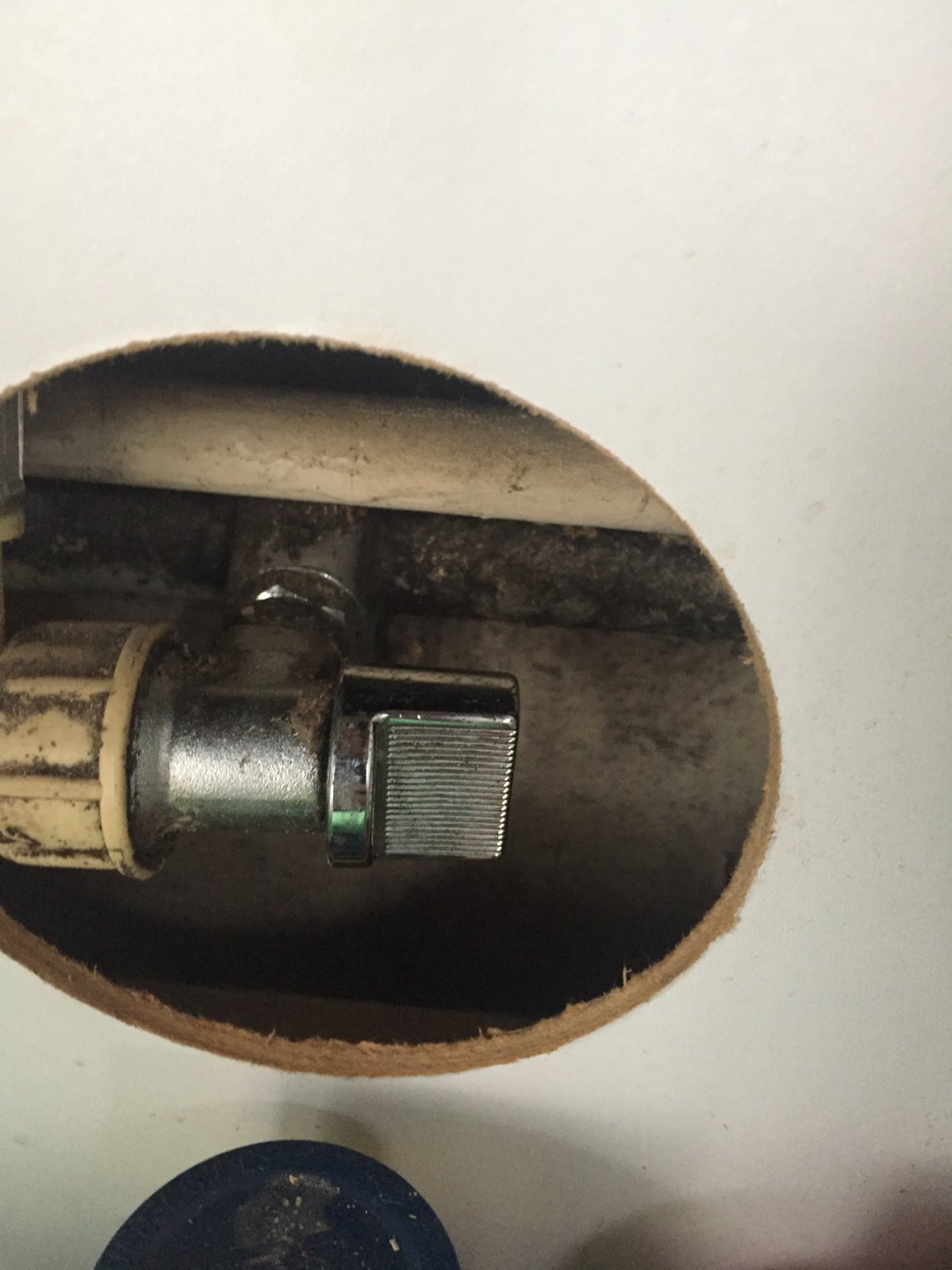

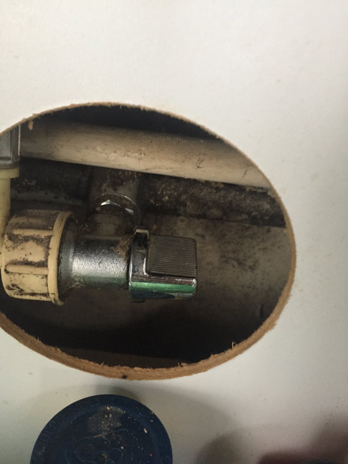

Outside tap is leaking. Probably washer, but can’t turn supply off using isolating valve in kitchen. See pictures below. Turned tap clockwise as far as it will go, but water still coming through tap. Have I missed something?
Thanks for your time.
It's a nasty self-cutting tap - the innards have probably failed. Turn off the mains supply to replace the outside tap washer.
When you have time, replace that dreadful piece of carp (the self-cutting tap) with a proper isolator, double-check valve and drain-off point.

Looks more like a washing machine valve, to me !
You don't "keep turning" it. It closes when the handle is at 90 degrees to the the body. Quarter turn tap.

On hols, but bruv staying at house. V mysterious in that we seem to have a problem with stopcock as well as isolating valve. Ie with stopcock and outside tap off, water still dripping through main body of tap! Not withstanding problem with isolating valve in kitchen, shouldn’t stopcock have stopped drip completely? Bruv now going to turn tap on with stopcock off to see if that clears any residual water in pipe. Also, if there was a problem with stopcock not closing, wouldn’t that cause other tap in kitchen to drip? Not the case apparently?
Thanks for your ongoing help. Will probably get plumber to look at on return, but main worry is long term impact of water stain on outside wall.
Why not fit a blanking cap nut onto the garden tap until sorted properly , most garden taps are 3/4 bsp threads . re your stopcock , when this is closed , there will still be quite a lot of water in the house pipework which will need to be drained out before drips stop.

Thanks again. Should have added that leak is between tap and supply pipe. Think this is more gland than washer? Also blanking cap no good here? Finally re stopcock: take point about time needed for water in system to drain even when stopcock off. However, main sink taps not dripping when on, but outside tap off. Back on Sunday so will investigate then. Can you reassure me that no damp likely in these circumstances? (big curve shaped water stain on outside wall?

Appreciate this is just about a garden tap and about 1 on a scale of 1-10. However, trying to get my head around this glitch with stopcock. Situation is that stopcock is “closed”, but water still dribbling from outside tap (been doing this for a week so not just emptying water in system) How can this happen when sink taps have no drip in on position and when supplied by same stopcock??
Going mad understanding this.
if you mean the garden tap is at fault, might be a worn-out tap washer, or a slipped retaining clip. If the washer wears really thin, it can allow internal parts to move out of position.
start by taking it apart and changing the washer, screw the internal parts back if loose, resposition the clip if there is one and it's come out of its groove.
Most likely this will fix it.
If not, a replacement tap will probably cost you less than a tenner.
