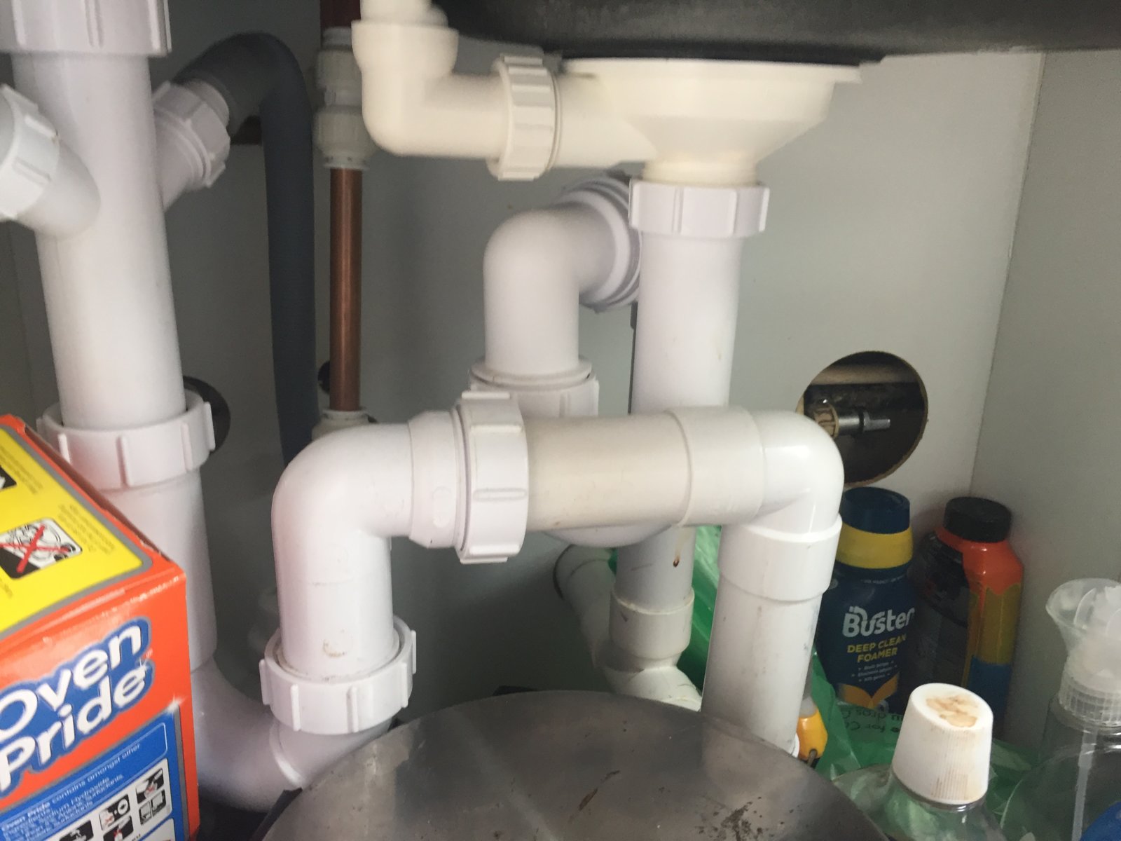

Back home now. Obvious problem with outside tap- crack. Have bought replacement and want to replace dodgy isolating valve at same time. We had new kitchen about two years ago and only have circular inspection hole in back panel of cupboard under sink. See photos. It would be easier to remove and replace if aI could remove said panel. Should that be possible?
The back panel of a sink unit is usually just hardboard, sometimes thin chipboard. You can cut a big hole in it. A multicutter might be safest to avoid cutting anything unseen behind. If you make a square hole it will be easier to fit a removable hatch cover later.
The back panel keeps mice and draughts out, and adds a tiny bit of rigidity, but if the cab is screwed to the wall and/or the worktop, that will hold it steady.
Thanks. The problem is that the panel covers the area where the supply hose goes through the wall to the outside tsp
