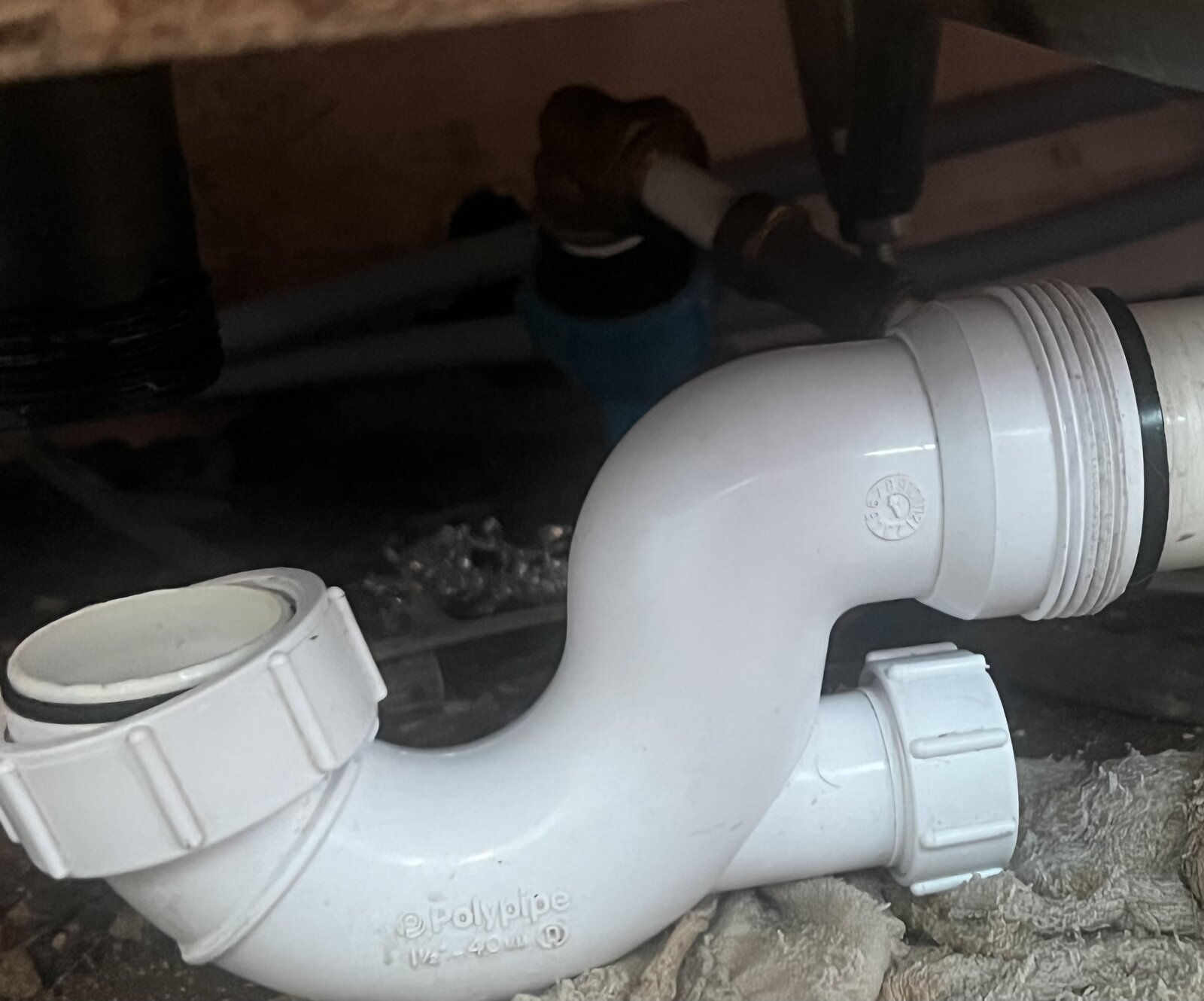

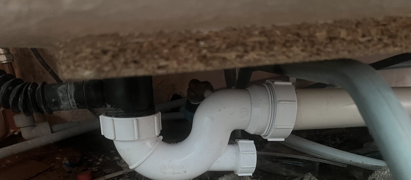

Can someone help me, I took this apart as it was blocked but now it won’t seal properly and it’s just leaking. What can I do

Where is it leaking from? Check t he rubber seal at both ends, nice and clean without any squeezed/twisted sections. Attach the section to the bath waste loosely, do the same with the seal and nut that connects the trap it to the pipe, then tighten the waste nut up first so it sits nice and square, hen the nut at the pipe.
