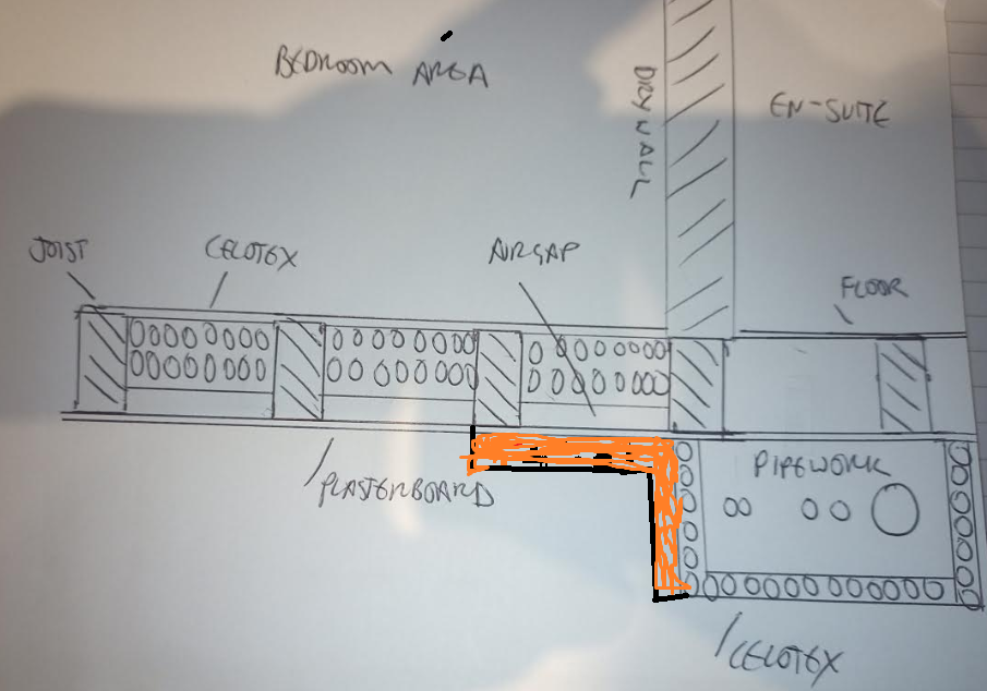

Thinking about putting Celotex or similar under my bedroom/en-suite floor. The room is over an unheated garage.
In the bedroom there is only one rad to worry about, so that's not a problem.
But I'm thinking about all the water and waste pipes and the shower trap in the en-suite.
This trap is the Mira rectangular type.
Although it is impossible to insulate the room completely from below (ie under the garage ceiling), it is possible to insulate just the en-suite from underneath.
Is this a viable proposition?
Cheers folks.

Sadly, the garage ceiling is intact.
I will have complete access to the floor void from above.
The thing that bothers me is that I would have to remove insulation where the shower trap is going. I'm trying to completely (or as completely as I can) isolate the cold space below from the warm above.
Hence the idea to insulate all of the bedroom from above and ally tape over the joists, then insulate the en-suite (which is formed from a corner of the bedroom) from underneath, fixing the Celotex to timber battens, making sure to overlap from below the insulated area in between the joists above.
This the leaves the floor void under the en-suite free of insulation and less hassle for plumbing.

This spectacularly rubbish drawing gives an idea of what I propose.
My only stumbling block is what to do if the en-suite does not finish on a joist....

If I understand you correctly, I can't insulate the whole floor area from below as there are pipe runs front to back on the garage ceiling for the combi, which are spaced off the ceiling.
There just isn't the headroom.
But I am able to insulate the en-suite floor from below.
But as I say, I'm unsure how to proceed where the en-suite floor area (insulated from below) borders the bedroom floor area (insulated from above).
Right, hope this works??
The timber beam between the two rooms is a reasonable insulator, if you "add" some further insulation as indicated Red [or nearly Red] in this position it should reinforce the overall insulation in place.
Sorry but I copied and used Win Paint to try this out, I do not like Paint.
Ken

And if that drywall returned across the joists (rather than along the joists, like the one in the diagram) to complete the partitioning of the en-suite off from the bedroom, how would you finish off the insulation "box" underneath?
What's going on with the insulation above, and the wall of the room?
Just want to make sure the most effective place to work is below the room!
