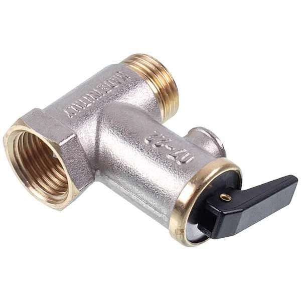

That sometimes creates a bit of confusion as one might think that the pipework itself can accomodate the expansion, say ~ 0.3L with a 15L cylinder but it must have no restriction right back to the mains like a PRV or a NRV, its only, IMO, to ensure hot water doesn't come out the cold tap. A friend of mine had a 10L with its own PRV, see below, (pressure relief valve) which would start feathering very shortly after he switched on the heating element, he found a PRV (pressure reducing valve) on the mains and just removed it as his mains pressure never exceeds 3.0bar.
The cylinder had a Ariston 571730 combined PRV & anti syphon valve.
The cylinder had a Ariston 571730 combined PRV & anti syphon valve.View attachment 420551

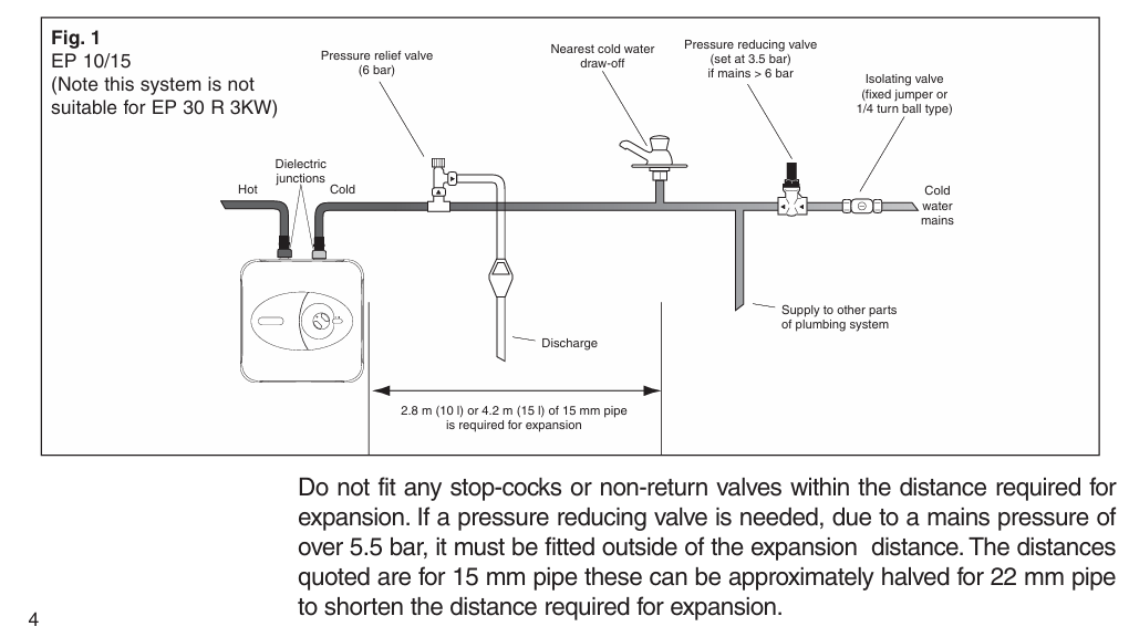

Diagrams in the MI's are usually very good and explanatory.

I'm not so sure about that, the schematic below shows a pressure reducing valve but not a expansion vessel, the 2.8M or 4.2M required for expansion might give the impression that no expansion vessel is required, also the statement below can lead to confusion, IMO.

That Ariston 571730 combination valve is interesting in that apart from its pressure relief valve it also has two spring loaded valves in the inlet, one opens inwards to admit mains water to the cylinder, this valve has another smaller spring loaded valve inside in it which opens outwards back into the mains, it opens at a differential pressure of 1bar, if the mains is say 3.0bar, then the cylinder pressure on re heat will rise to 4.0bar before it opens, presumably its designed to keep the cylinder full of water during a mains drain down.
