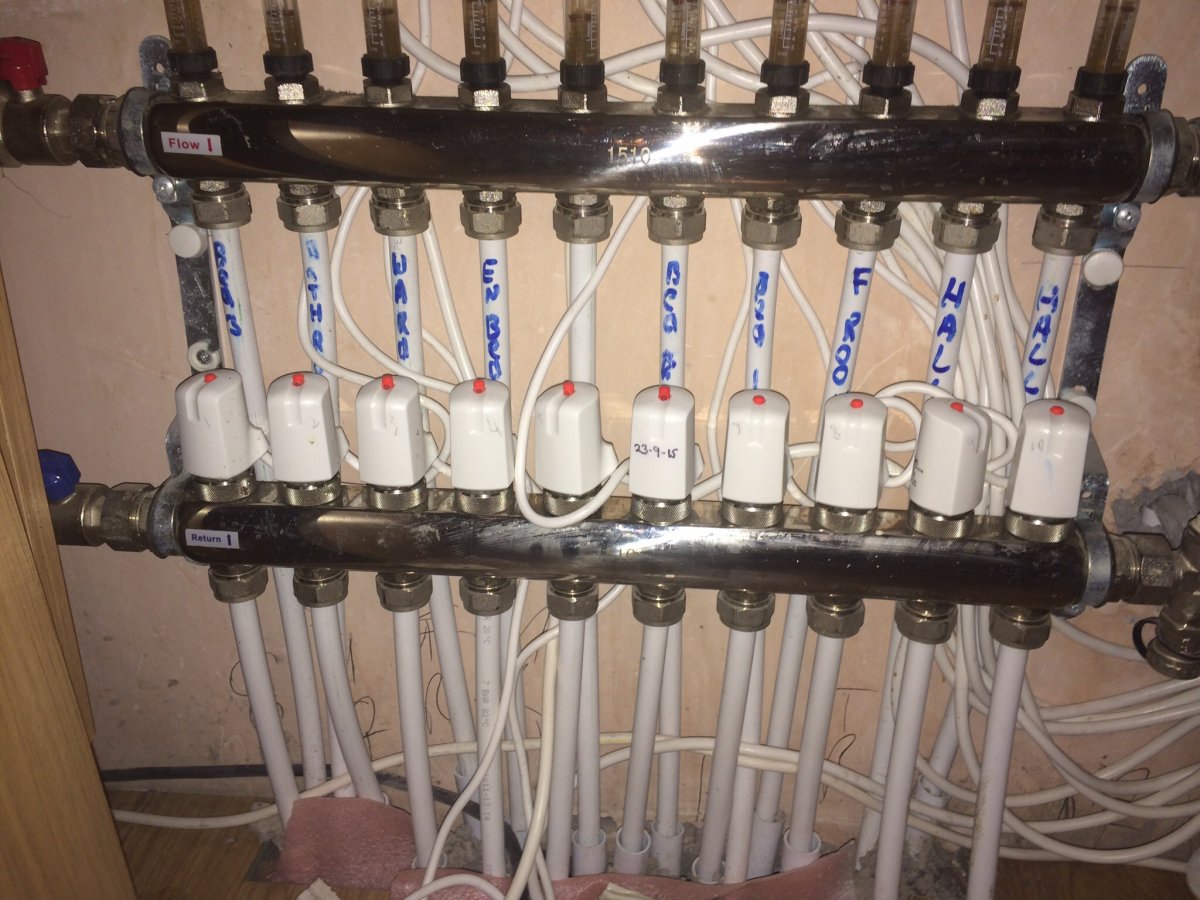

Underfloor heating, one room not heating up

The original installer of the UFH system asked for this to be done 3 years ago as him and the electrician started to blame each other for the issue not the latest firm to come out

Still not clear about this. Have you recently removed the actuator for 24 hours, or as long as it takes, to confirm the room does still get some heat?

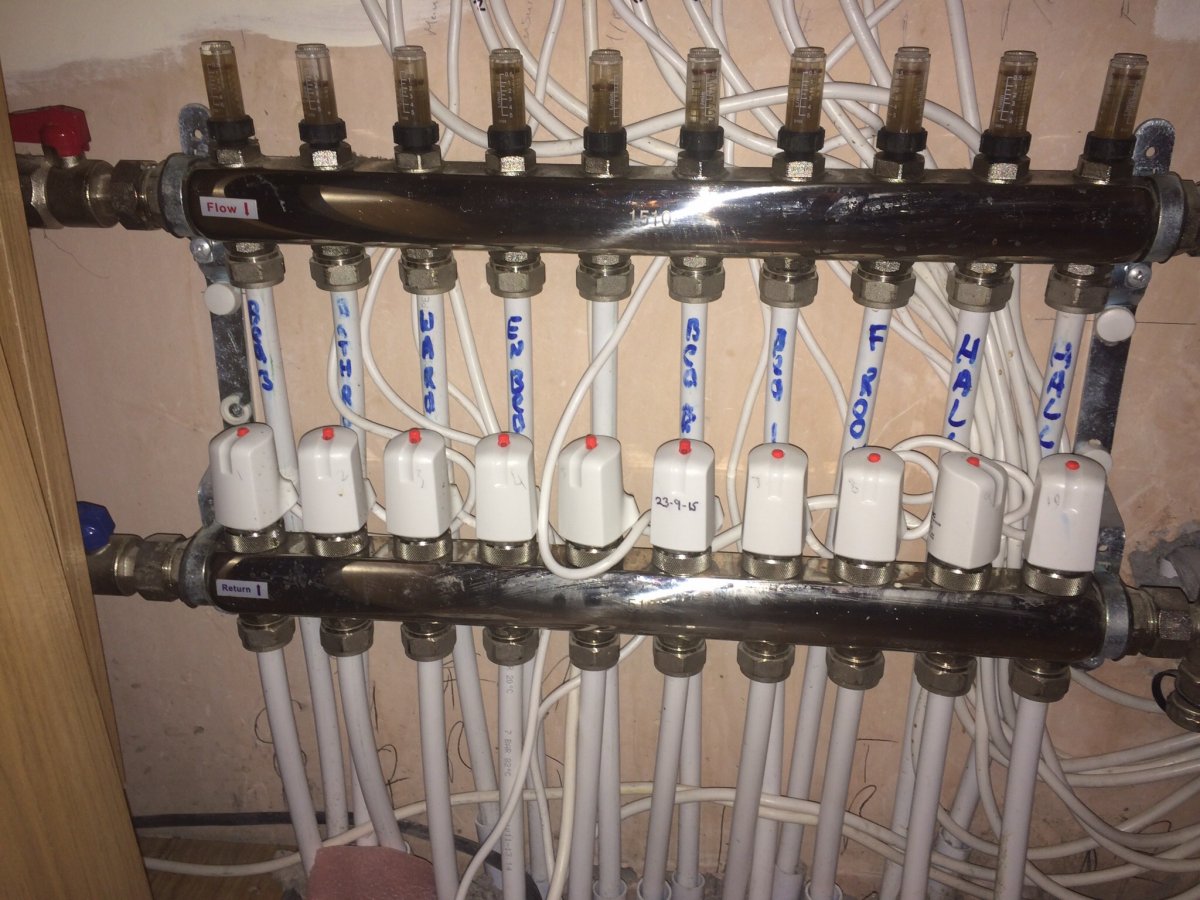

-No heat in room told to get actuator changed
-Still no heat in room so I removed actuator and and heat went into room
-told then the thermostat must be faulty so had to change that
- once thermostat changed heat stop going to room with actuator on or off
- the loop was purged and a new boiler installed last Saturday, could feel minimal heat coming from floor by late afternoon but went back to no heat by evening even though heating ON all Sunday, and all week...still nothing.
I think your talking about the wee red valve on top on the actuator head, if so Yes, when the heating is running it is always up.

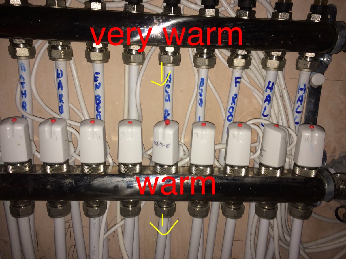

Not sure if this makes any difference. I switched all upstair zones off except the room not heating. As you can see actuator pin up. One pipe is hotter than other.
