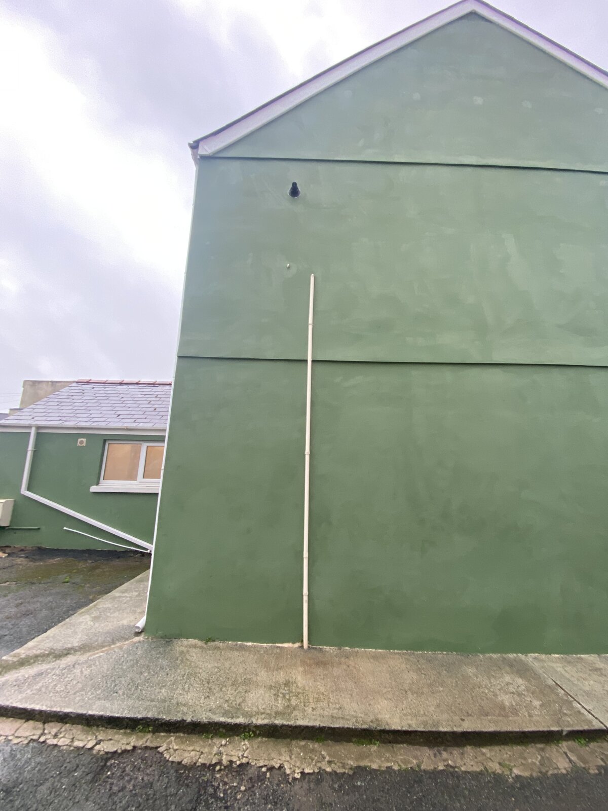

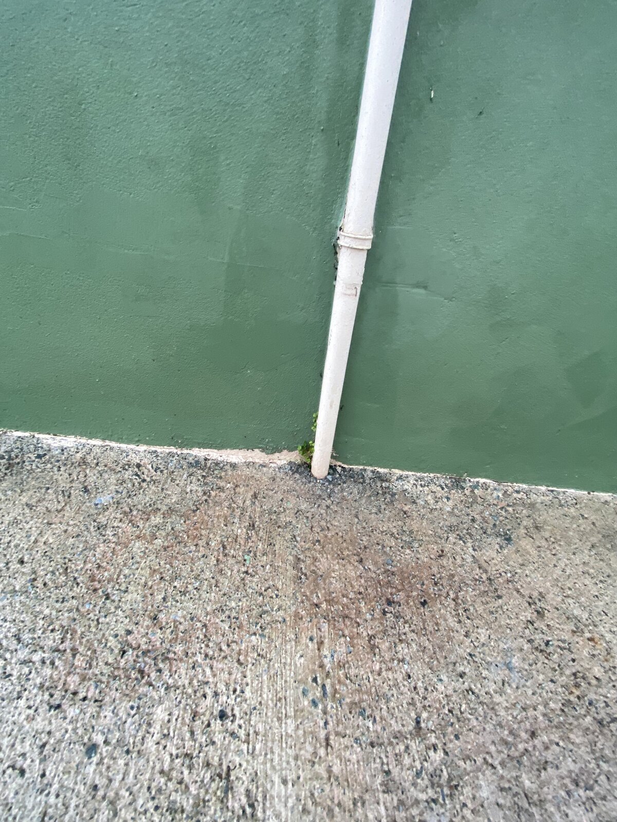

Hi All,

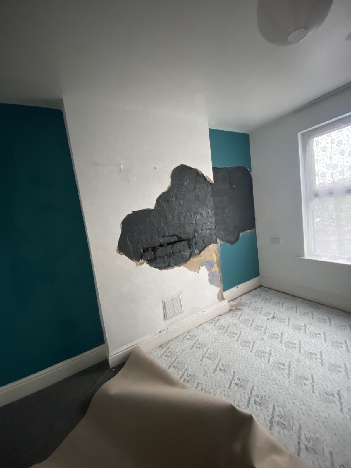

I have been experiencing damp issues on an internal wall so my builder has been here today as part of the work.

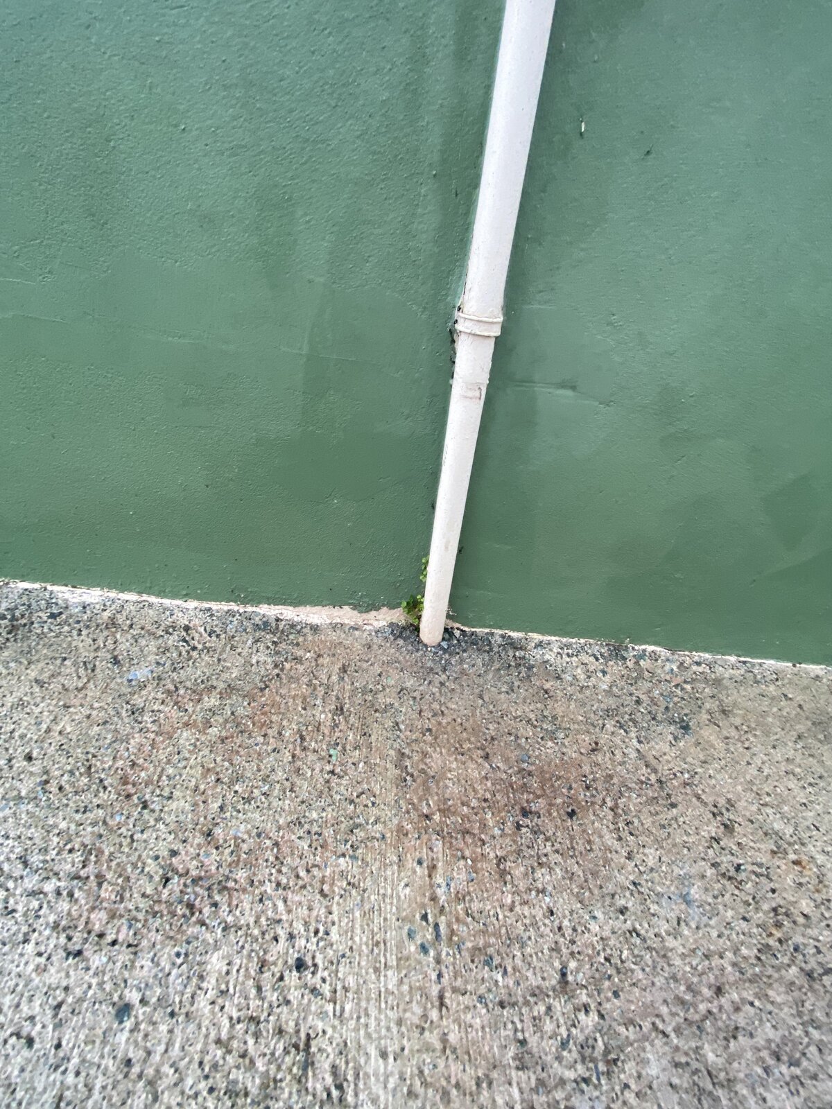

While he was here he has pointed out that my mains gas combi boiler condensing pipe it below ground level and we cannot see the location which it drains too.
None of this seemed to be concerning until I mention that the wall being repaired for damp is directly behind this pipe and the room has had a failed floorboard joist previously.
The boiler was fitted in 2015 by BG who have given several home care service reports (most recent 2022) stating the system was safe etc.
Could this condensing pipe be the source of these damp issues?

It's advisable not to have external render down to ground level, it should stop short, say 150mm (min) as it's possible to 'bridge' the DPC (Damp Proof Course) and can introduce damp.
I see there is an air vent on the chimney stack in the room, but there is no chimney on the roof, presume this is capped off, so there is nowhere for warm moisture laden air to vent to, it's common to put a ventilated chimney cap on the chimney pot, this maintains air flow.
What is the dark grey paint on the internal room photo?
I this a solid brick property or is it cavity walls? Do you know year of construction?
I'm guessing solid brick.
could it be the pipe fixings letting damp through the external render?
Yes it’s solid brick.
The grey is some kind of primer that my builder it using to plaster over.
It’s fresh on today.
His worry is that the exit of the condensate pipe is not at all visible.

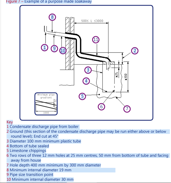

In cold weather, when on central heating or hot water, condensing boilers can produce up to 1 litre an hour condensate which is acidic and needs to be disposed of. If no drain nearby, then a soakaway full of limestone chippings. They should be checked and replenished yearly. They eventually go to mush because of the acidity of the condensate. The soakaway is recommended to be 500mm from the building. Yours is not visible. Maybe your downpipe is connected direct to a drain. Unlikely to be the cause of your internal problems.
One question with that condensate would be, has that concrete base been laid after the condensate pipe was fitted?
If not then I fail to see how they've managed to get to a hidden drain gulley or a purpose fitted soakaway container filled with lime chips into that ground, or even just dug out the ground enough to get lime chips into that to ensure a correct soakaway, never mind that it isn't to standard being far enough away from the foundations, looks like they may have just cored a 35mm hole and then just stuck the pipe into the ground.
Is it the cause of your issue though, depends on what's under there and does it actually run/soak away
