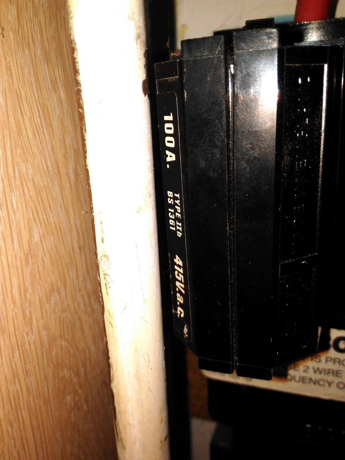

Ah thanks for the pointer. I had assumed that the printed ratings on labels would match the underground cable. Here is a photo that the neighbour allowed me to take, what do you think?

If I am understanding this correctly, this fuse is to protect the circuits downstream, therefore it tells us very little about the capacity of the underground cable, which could be 50A for example, am I right?
It will certainly protect cables downstream of the fuse - but they (other than those to/from the meter) would, in practice, have local protection, anyway.
I think that, in practice, the main reason for existence of the fuses is to protect the cables and network upstream of the fuse from the effects of faults downstream of the fuse. Quite apart from the cables, were it not for cutout fuses, a fault in one installation which took out the substation fuse would also deprive many other installations of electricity.
Yes.
If you mean the cable to your premises from the main in the street, then sort of.
It's likely to be more than 50A as the suppliers have different rules. Their 16mm², for example, is used for 100A supplies.
Typically fuses are there to protect the cable down stream from them.
However in the case of incoming cables, they often also in effect protect the incoming cable. As said, its quite likely your neighbour has a 60 or 80 A fuse in that 100A rated cutout.
