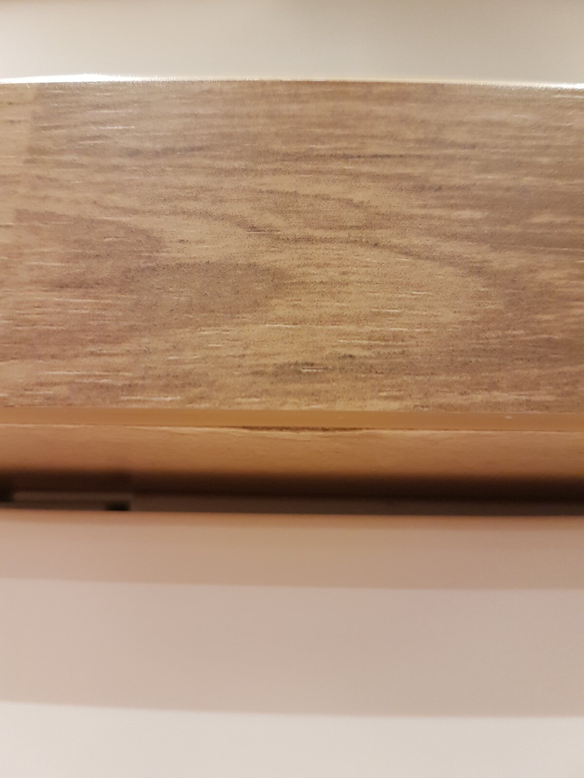

I've realised too late that the plastic stick on piece that I stuck under my laminate worktop above the dishwasher to protect it from condensation - I should have also done this next to the sink.
Now after a couple of drips have not been wiped away quick enough, a tiny section of the underside of the worktop is starting to expand after water ingress. See photo.
What can I put on this bit straight away to protect it from further damage? And afterwards can I stick a protective piece over it and the rest of that section below the sink? Will future drips hit the expanded bit before the protective piece, meaning it needs another type of protection?
Many thanks
Colour matched silicon. May still expand though . Foil tape is easy to apply, ideal over appliances .
"Paint" it with wood hardener. This will both seal it and incorporate any moisture still in the chipboard into a polyurethane binder.
Wood hardener for rotten wood? That sounds like it will do what I want. Then hopefully I can put the tape/plastic condensation barrier over it and the rest. Many thanks!
It's a polyurethane compound, so moisture in the worktop material will draw it in and also acts as an activator.Wear gloves and put newspaper on the floor! This stuff turns skin black on contact (takes 2 to 4 days to scrub off) and use a cheap brush as the brush will never be the same again
Ok so slight problem, I've panted the wood hardener on the problem area and a fair bit around it too. 24h later it's still really sticky to the touch - what's gone wrong?
Possibly temperature. Wood hardener is a polyurethane compound in the same way that Gorilla glue and expanding foam is, so it won't work at low temperatures and it won't work in extremely dry environments. Is it too cold? Alternatively, try spritzing a little water onto the hardener. If it activates then you know your worktop is bone dry
Many thanks, I'm pretty sure it's not temperature, never gets below 16 degrees in the house normally. So perhaps it's too dry, I'll try a bit of water and see what happens. Cheers.
