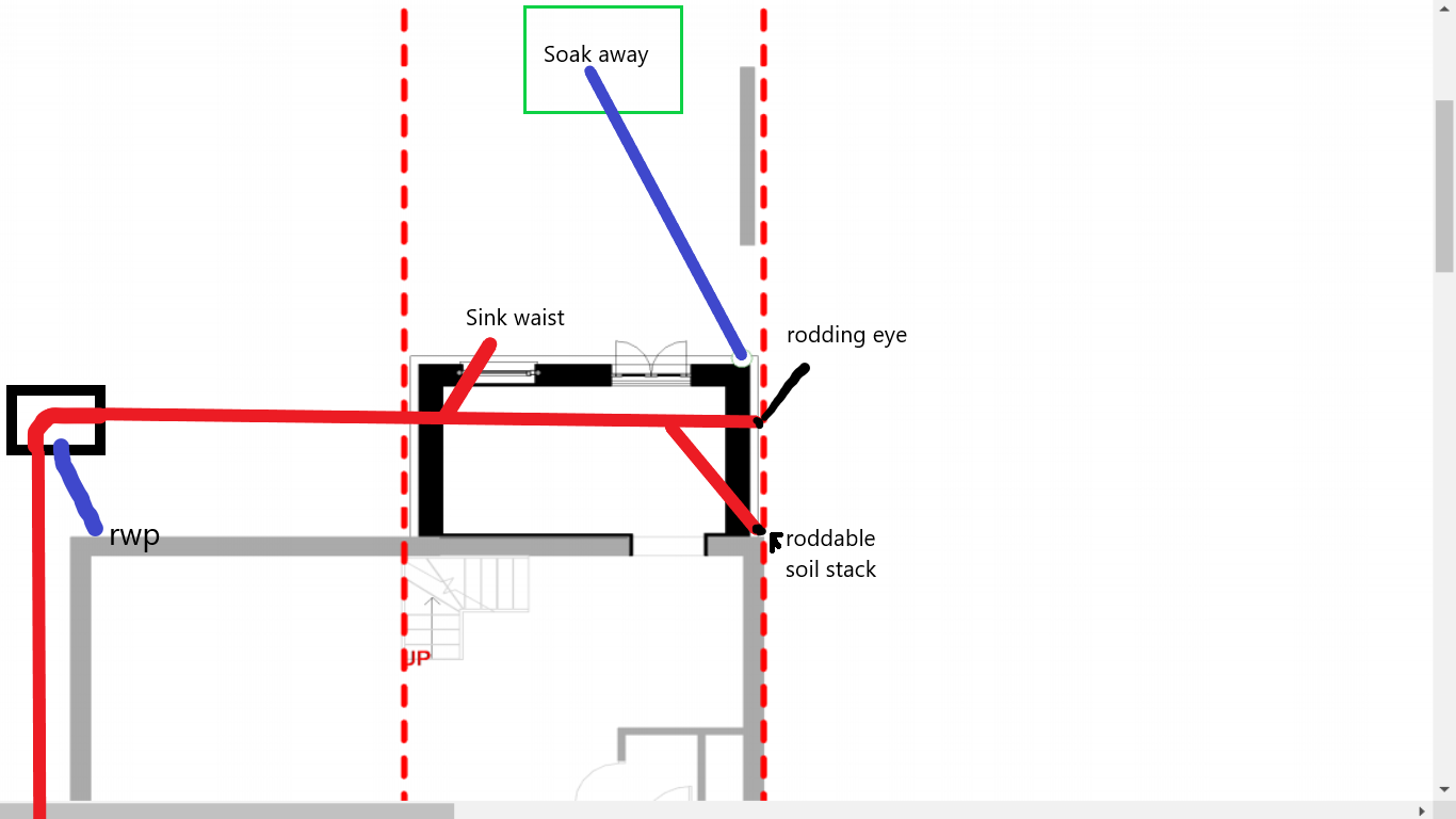

My pipe size is 100mm
its 980mm below ground
and my build to the rear is 5.2meters in length
am I right thinking my building control can sort this matter or do I have to get a build over
If there's no-one upstream of you then its a private sewer until it joins with next doors. So looks like LABC only, don't understand your Paint drawing so not going to comment. Apart from sewers under buildings are best avoided

this has been bugging me all weekend as i don't think building control will allow me to put slow bend/ 30 degree on main line what i am thinking there is a gap off 250mm each side off the extension to allow for the gutter/facia. I think might have better chance this being accepted if i make my soil stack external rather than keeping it internal also (See drawing ) let me know what you think and thank you again for all your info Cheers
