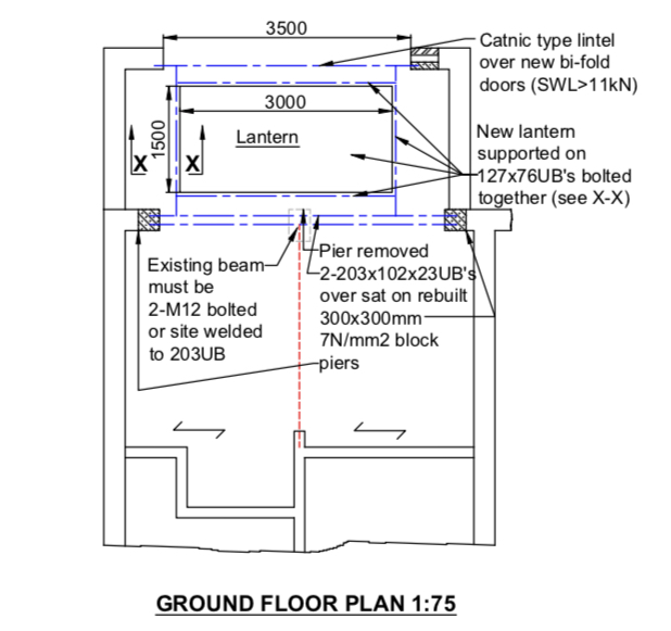

Can anyone provide me with a ball park estimate (to the nearest £1k) for the following work.
- We have an extension to the rear of the property that currently isn't working well.
- Removing pier and installing steel flush into ceiling void (pinning to back wall).
- Knocking out brick at rear of extension and installing bifold doors with lintel above.
- Removing old flat roof and replacing with roof lantern with new fibreglass roof surround.
Please note: As you can see we have already consulted a structural engineer to do calcs. We will also source the lantern/bifold ourselves.
I am also aware of the fact it will cause damage to the rooms upstairs.
I essentially just want to see what the quotes should be around very roughly. I am based in the northwest.
Thank you so much.
I have no idea where the image went. Here it is again. Also I say to the nearest 1k because I realise lots depends on the situation so many people say “how long is a piece of string”. I had hoped my engineer would be able to provide a ball park figure but he flat out refused. Sadly.

In your first post there's another lintel and set of bifolds, plus a new roof and roof lantern.
There are huge a number of variables, hence the responses you've got. Ranging from whether site access is a nightmare through to whether you want a cheap set of £3k bifolds or a decent set for 6k.

By the way, did your SE confirm that the floor joist depth is large enough to completely absorb the 203mm UB?
So you are including the materials (lantern/bifolds) if so then the £20k isn't so scary.
The SE said there will be 8inch beam going in and it might not be flush. I'm okay with it zitting down a few inches just as long as there isn't a huger 12" beam like there currently is making the room look a mess.
