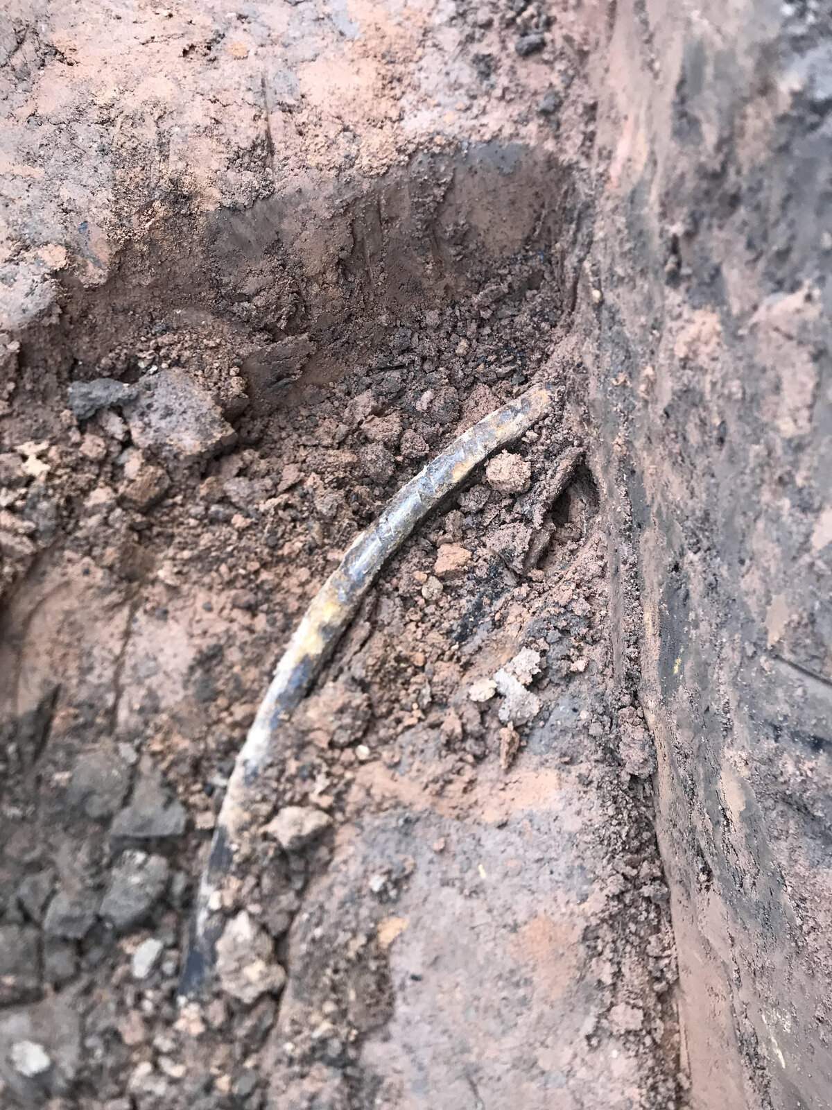

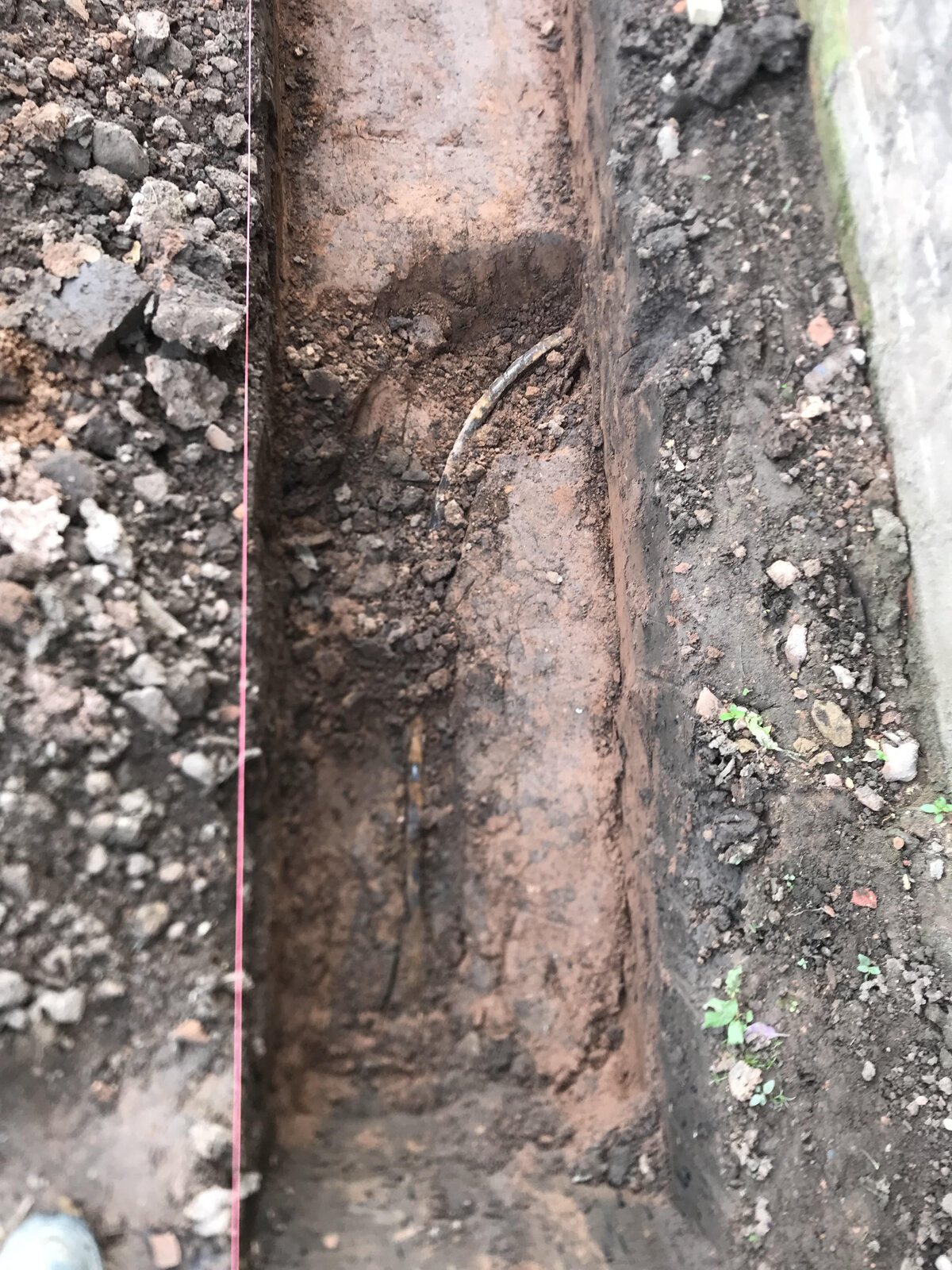

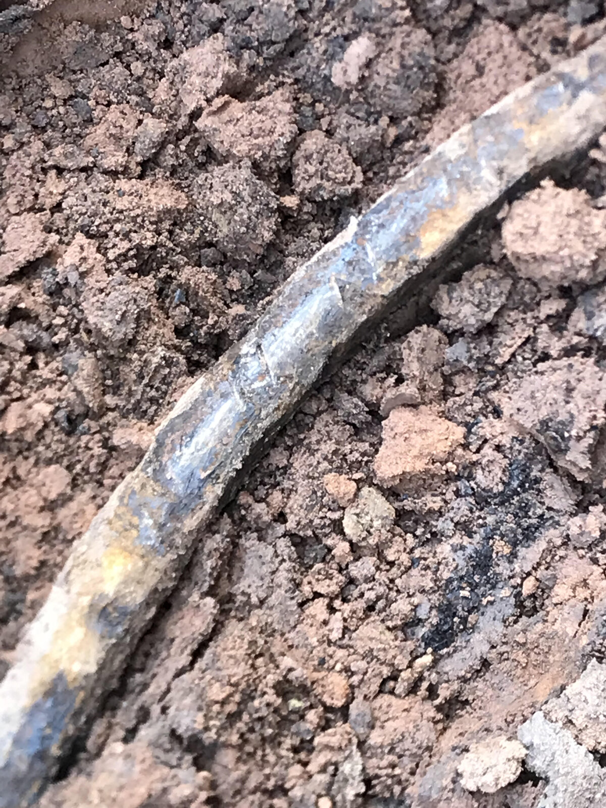

Hi All
hopefully someone on here can offer me some advice, i have found the following pipe or cable in the bottom of my foundations as i have been digging. At first i thought it was the lead water supply pipe (its a 1955 property), but on closer inspection it seems to be banded/wrapped in something, and is showing signs of rust, but also shows up silver if you scratch it. Its not rigid, more "heavy floppy" like a modern armoured cable would be.
my previous experience of lead supply pipes has been that they look like a smooth pipe, not wrapped like this?
any suggestions appreciated from anyone who may have seen similar?
Many thanks

The wrapped steel bandage armour tends to be badly rusted and may crumble or break if disturbed. Goes back to the 1920's I think.
You could ask your DNO if they want to replace it, as you've dug to it.
It's their cable.

thanks everyone for their comments, here are some updates/answers.
The trench is foundations for a new single storey conservatory replacement, it will be the front wall of said construction.
the string line marks the edge of my trench, not where the wall will be built
To the right on the one pic you can just see the existing wall of the old conservatory, which itself was built up from the foundations/walls of some old outbuildings (which would have been original 1955
the banding is steel, a magnet sticks to it (tested last night)

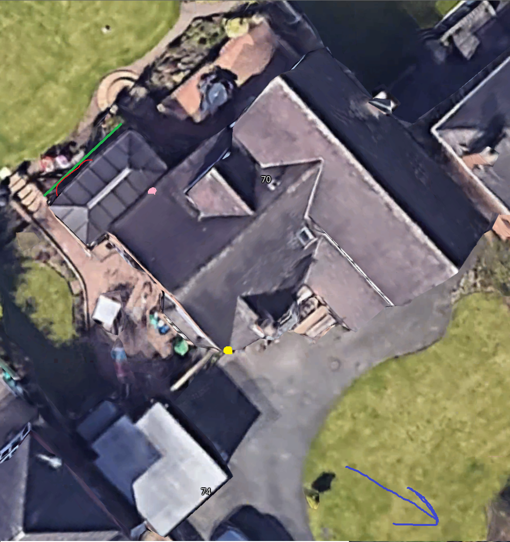

see attached picture.....
  • the green line is my trench
  • the red line is the cable, i exposed a bit more last night and it loops into the trench on the left runs along it and then exists to the right (of the attached picture)
  • the current LIVE supply to the house (and meter/fuse etc) is on the outside front wall where the yellow dot is, in a plastic box, with one of those triangular keys to open it. The supply cable comes up out of the ground there, and enters the plastic box, presumably from the road, which is where the blue arrow points. The consumer unit is on the wall inside behind the meter box.
  • The meter box (and CU etc) are obviously not 1950s, they look relatively recent, i would guess 1980's.
When i reworked the kitchen, i knocked out a doorway at the rear of the house, and there was a empty steel box sunk into the wall (internally) where the pink dot is, the box was about 6 or 7 inches square, looked to me at the time like a extra large cooker switch back box, but i thought nothing of it.
so, I'm thinking that the original supply to the house came from the road, along the side of the house, looped down around the old outbuildings (which were where the conservatory is now) and back up into that box on the kitchen wall. that sound feasible?
