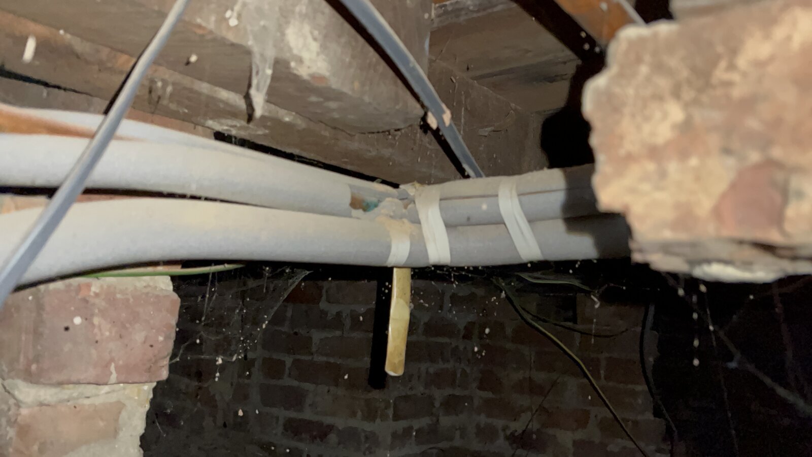

Hi all,
Another issue in my Victorian terrace which I could use some advice on! I was checking my floor joists before overboarding with ply ready for laminate flooring, and I found that a couple of joists (dining room and lounge) are completely unsupported, because at some point in the house’s history someone has completely knocked through the wall in the void to run pipework.
There is a little a bounce to the floor in that area, but I never would have noticed if I wasn’t checking each joist.
I can’t rebuild the wall to joist height and pack underneath since there’s a shi*toad of pipework in the way. I was thinking of bolting both joist ends together, then adding a trimmer each side to the adjacent joists which are pocketed into the wall to provide support?
Would this work, and does anyone have any other suggestions?
Best,
Tom
A vertical post to the ground? slightly Short and bang in wedges
If it is soil below, a post would sink in. Lay a paving slab for the post to sit on.
It looks if there might not be room to get a post in there, in which case an off cut of steel box section under two joists, with a post supporting the steel - like a T
A good shout with the post/T with steel! I have some ballast/cement left over from laying new hearths, so I could use that to set a post in place, or just use a slab as suggested. Doesn’t transfer any load onto adjacent joist then either, and an easier fix than trimmers and bolts etc.
Joists aren’t sistered no, as Harry guessed, it’s just where the dining room and living room joists overlap, they were both sat on the wall before it was knocked through.
