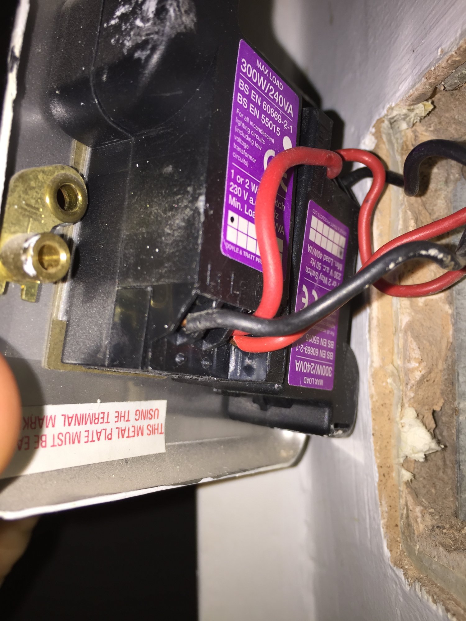

Hi
I have a dimmer light switch that would not turn on first time anymore, but if I gave the switch housing a thump it would come on. Assuming a loose connection in the switch, I turned off the circuit at the fuse box, and unscrewed the switch. A small screw dropped out of the switch on to the floor - it had come from the Earth on the inside of the switch.

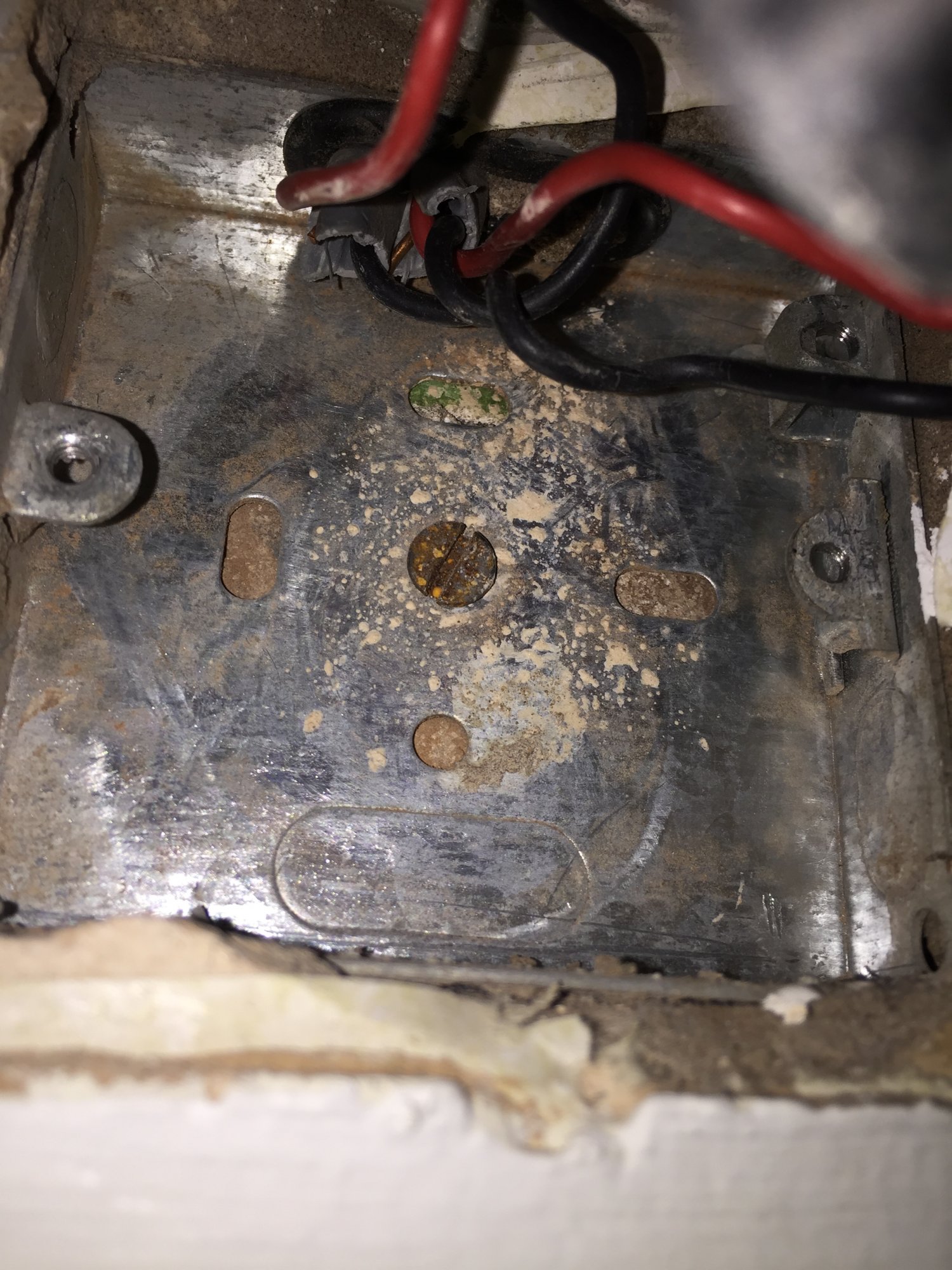

This is a metal faceplate 2 gang switch, housed in a metal back box. There's two black leads, which each attach to an L1 on each switch. There's two red leads, which attach to each C, with a small red lead also linking the two Cs together. There's two bare copper wires cut back about as far as they go but they don't seem to be attached to the back box in any way. The earth screw on the inside of the faceplate (where the screw fell out when I took the faceplate off) has a small piece of copper sitting in the hole.
Not realising I had to earth this metal faceplate, I tightened all the L1 and C (the black wires and red wires), screwed the faceplate back into the wall and turned the power on, and the switch now works first time ever time. Then I got paranoid that it's not earthed, and it's metal faceplate and I'm going to die. So I turned the circuit off again at the fuse box and now I'm here. I've tried to contact my usual electrician but he's not answering. I have no RCD at the fuse box. Is my light switch safe or not?
Many thanks!

The two bare wires are the earth wires. The front plate of that switch MUST be earthed. Thats what the terminal with the earth symbol is for.
You need to terminate the two bare wires on to the front plate, somehow. First of all you need to check that those conductors are connected to earth!
Alternatively, change the dimmer for one with a plastic front plate.

Does this suggest that this light switch was not actually earthed before I opened it, or did my opening it break the earth connection? The piece of copper wire I found in the earth terminal of the switch may have been long enough to make a connection with the back box, but certainly not long enough to meet the two bare wires - and the back box doesn't appear to be earthed so what good would earthing switch to back box be??

You probably didn't damage anything, it is most likely the person who installed the wiring couldn't be bothered to connect the cables. During the changeover from twin to twin and earth cables there was some resistance with some electricians not wanting to use the CPCs. If it is like this in this switch, it is possible it could be like it in every switch, light fitting and junction box on the circuit.
It would do no good at all.
If you are lucky it will be just this one switch and you can carry out the test to prove the earth connection, and then connect the wires into a connector block along with a new 1.0mm earth wire which you can then connect to both the metal switch plate and the back box.
It is essential that you prove that one of the wires is earthed using the test method above. The other wire may not be earthed as it goes on to the next part of the circuit. If there is no proper earth connection, connecting these wires to the front plate will create more of a hazard than before. The bare wires once proved need green and yellow sleeving fitted.
If you find all the CPCs are cut out and want to connect them back in yourself, you must ensure that every single CPC on the circuit is connected, and then you will need to carry out the R1+R2 test above at every single switch and light fitting on the circuit to prove every point is properly earthed before switching the power back on. It's easy to get caught out by a hidden junction box for example.
