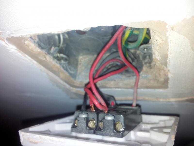

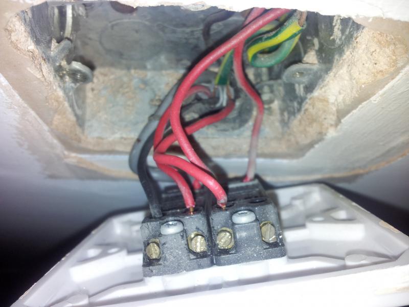

Hey everyone.
I'm trying to find a solution to a light switch issue I have encountered in my house of weird wiring!
I currently have a bedroom light switch which has two switches.
1 switch controls the bedroom light independently.
1 switch is a 2-way switch that controls a downstairs outside light (don't even ask!), with the other 2-way switch being downstairs.
When the switch in the bedroom that controls the outside light is in the "on" position, the outside light can be turned "on" and "off" using the switch downstairs.
When the switch in the bedroom that controls the outside light is in the "off" position, the switch downstairs will not operate the light.
I am trying to disconnect the outside light from the bedroom switch, and leave a 1 gang switch in the bedroom, but as the switch in the bedroom which controls the outside light needs to be in the "on" position, I'm not sure if I can transfer the wires from the switch into blocks that can be hidden behind the new 1 gang switch, but still be "on" to work the outside light?
I attach a picture of the current configuration, but as it's not that clear, this explanation may help.
The picture was taken standing in front of the switch and tilting the top towards me, so the top edge is at the front of the picture
The switch on the right operates the bedroom light perfectly.
This has a red wire in the top right hand side connector, and 2 red wires in the bottom left hand side connector.
The switch to the left operates the downstairs light, and needs to be "on" for the lights to work using the other switch located downstairs.
This currently has a red wire in the bottom right hand connector, a black wire in the bottom left hand connector, and a red wire in the top right hand connector.
It is this switch that I want to connect to blocks and "hide" behind a single switch, but make sure the downstairs switch still operates the outside light.
Apologies for my lack of technical knowledge, and poor descriptions, but any advice on how to make the change would be very welcommed.
Kind regards
Phil

Try connecting together the two wires which are in the bottom connectors
and put the other in a separate connector.
There are different ways of wiring the lights so it may not work.
Let us know.
It could be a loose wire in the other switch downstairs which is preventing it working as it should.
A picture of the other switch will help.
It is possible that the installer fitted the light and switch to operate that way.
If you are removing the outside light completely, you will need to find the permanent live at the switch for this light, that can then be simply disconnected and placed in a terminal block/connector. This will then make the rest of the cabling of that part of the circuit dead. The plate can then be changed to a single gang plate and redundant cables can then be terminated together but separate to the permanent live the perm live could well be at the downstairs switch and maybe required for other functional lighting therefore would be terminated appropriately and the remainder of the cables from the outside light within the downstairs gang(outside light) would be again terminated into a connector.
You will require some test equipment to confirm and prove what you are doing is identified correctly and terminated safely. Two pole/probe continuity and voltage meters required.

Hi guys,
Thanks for the comments so far.
To clarify (and this may take a while so bear with me), I am trying to stop the outside light being operated by the switch in the bedroom, and leave that as just a bedroom light switch.
The outside light will still be operated by the switch downstairs.
I have further info which may or may not help:
The upstairs switch has 2 terminals, both with 2 connector holes at the top, and 2 at the bottom (as per the images I posted previously).
If we assume that you are looking at the switch whilst it is in situ, and have pulled the top of the switch away from the wall to look into it, this will give you the following:
Right hand side terminal = bedroom light
Left hand side terminal - downstairs light
I have now worked out that there are 4 twin and earth cables and 1 single cable attached to the switch in the following sequence.
Cable 1 (T&E coming down the wall)
Earth - earth terminal
Red - top left of bedroom light terminal (with cable 3 red)
Black - connector block with other black cables
Cable 2 (T&E coming down the wall)
Red - bottom right of bedroom light terminal
Cable 3 (T&E coming up the wall)
Red - top left of bedroom light terminal (with cable 1 red)
Cable 4 (T&E coming up the wall)
Red - top right of downstairs light terminal
Black - top left of downstairs light terminal
Cable 5 (Single grey cable coming up the wall)
Grey - bottom right of downstairs light terminal
Phew!

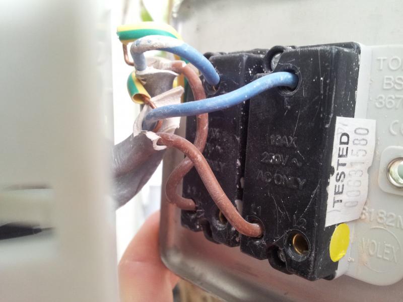

I have taken a picture of the downstairs switch, which is also a 2-gang switch, that operates the outside light from the right hand switch, and an internal 1-way light from the left hand switch.
The wiring for this 2-gang switch is just 2 separate twin and earth cables coming down the wall.
Cable 1:
Brown - L1 of the internal light terminal
Blue - L of the internal light terminal
Cable 2:
Brown - L1 of the outside light terminal
Blue - L of the outside light terminal
Picture here:
Does this make things any clearer?
And do you think there's a way to achieve what I want to?
Many thanks again
Phil
well it certainly explains why the 2 way switching doesn't work !
A little surprised to find you have different colours downstairs than upstairs.
Get yourself a connection terminal.
Upstairs on the outside light switch, put the wires from the common hole in the terminal, and then opposite put one wires from L1 & L2 into the terminal.
Check outside light works. That will do the job simply.
Then replace 2 gang with 1 gang
Thanks for the reply (I assume it's Andy).
When you say put the WIRES from the common HOLE on the outside light switch, do you mean the 2 red wires that are in the same hole (as these are on the bedroom light switch), or the black and red wires that are in separate holes on the outside light switch side?
Cheers
Phil
Sorry I didn't word that well.
Working On the outside light switch only
Connect the individual red with grey sleeve to the top red and black wires
So that all 3 wires on the outside light are connected together.
