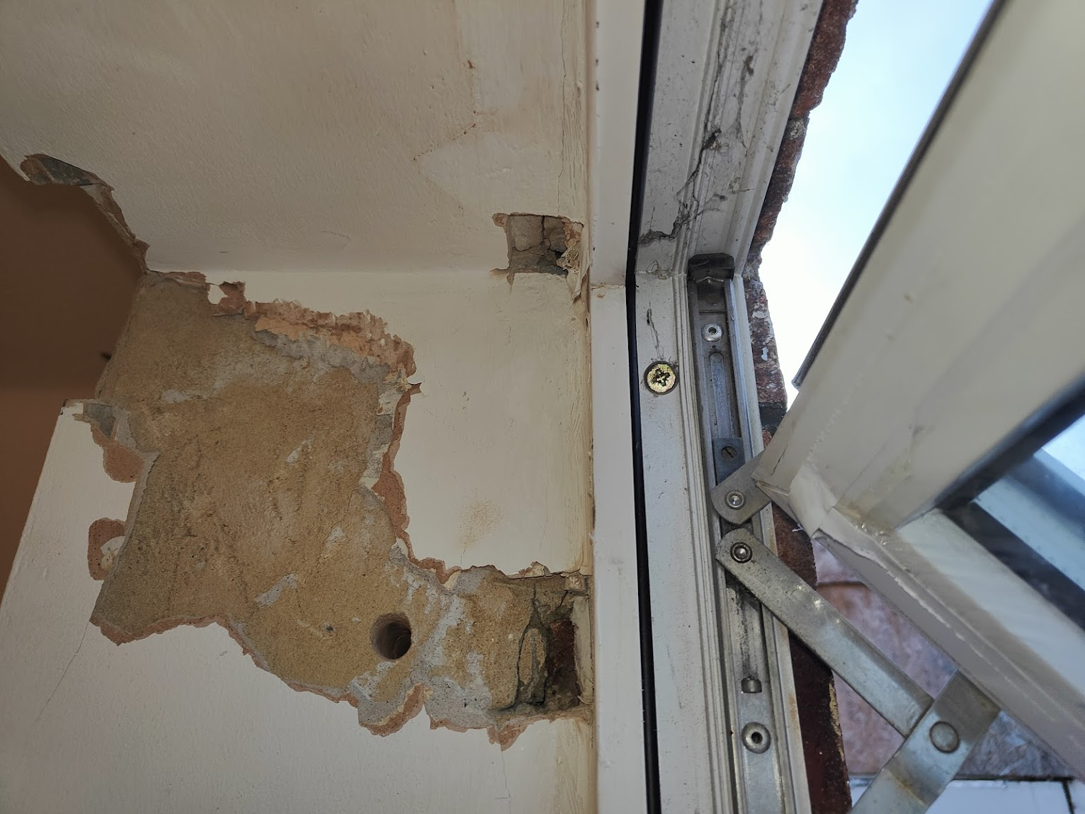

Hi, in my postwar (c.1950) ex-council house I'm looking to make a double door where there's an existing window - I've removed some plaster to try to understand what the current lintel setup is but have revealed only more questions.
The house is cavity wall (no insulation), c. 60mm, brick inner and outer, soldier courses above windows externally - no lintel visible externally but then windows are practically flush with outer face of brick.
There appears to be a concrete frame of sorts, looks in situ, about 60mm wide at jambs, roughly 260mm at head and extends into cavity, apparently closing it. Never seen the like and anyone I've described it to or shown photos of it to says the same.

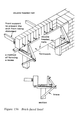

I now suspect there is no external lintel and the soldier course has ties into the lintel part of the in situ concrete - I found something that sounds like it in an old book about brickwork:
Some photos of where I've removed plaster:
Second photo, you can see the back edge of external brick, just inside the window frame.
Anyone encountered or aware of this type of construction around windows? As I say, totally new one on me.
