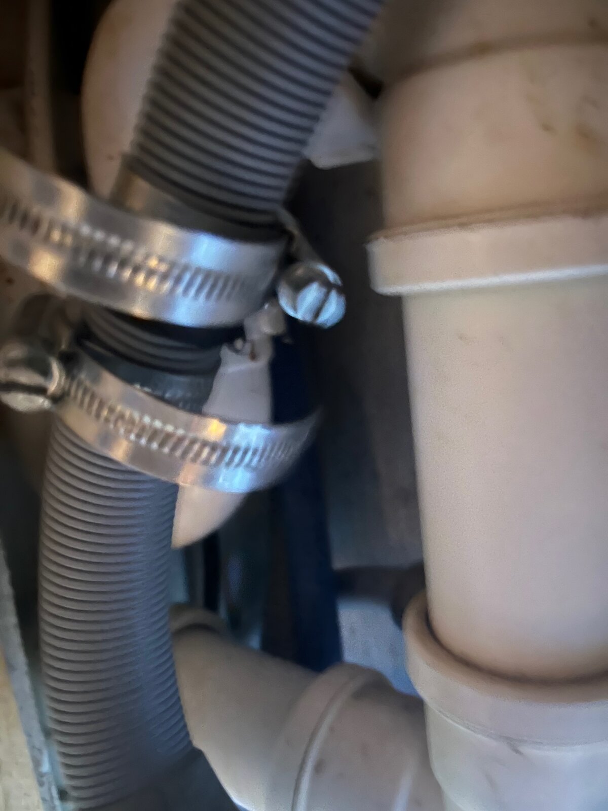

Hi
I live in a 400 year old stone house and these properties, as many will know, are always a compromise when installing modern plumbing/electrics etc.
I have a room in the house that has a split system air conditioning unit. The drip feed hose joins the main outlet to drain which it shares with dishwasher and washing machine waste. I never run washing machine and dishwasher at the same time in order not to overwhelm the waste pipe.
Recently when the dishwasher performs a drain, water has travelled up through the waste pipe up to the air con drip waste hose , which is about two meters long, and then spurted out at some pressure the air con unit when the unit is off. There is a good fall off on the air con hose. It’s only one spurt generally. It felt like air pressure was responsible. Im only guessing here
The original setup had a u bend trap at the bottom of the down pipe in the enclosed pic before it turns to the left and heads towards the main drain.
Steps taken
I called in an air con specialist who checked that the drip tray in the unit was not compromised and pipe was clear, and that the air con wasn’t causing the issue. He gave it a clean bill of health.
I then put a strong drain clearing product in to make sure there was no blockage in the waste. We took it to bits and also found no blockages. There was obviously water in the U bend/trap. We decided to try a non return valve in line further up the waste pipe and dispense with the U bend.
Running lots of dishwasher cycles to test there have been no further spurts of water out of the air con unit however I can still hear gurgling coming from the air con pipe at the unit end so Im nervous about it. Also there is a waste smell in the area the pipe work photographed resides. I was hopeful the non return valve might be ok by itself but Im looking for some ideas. Should I put the trap back in?

Is your a/c unit high on the wall? Does its condensate discharge into the top of the white tee?
How far does the wastewater have to travel horizontally from the base of your photo to the main drain (outside?)
In your photo which machine discharges into the high connection at the tee, and which to the lower connection?
Is the a/c condensate collection tray open to the atmosphere, and does the discharge from the tray flow continuously down to its discharge connection?
What are the arrangements to allow air to enter your discharge pipework?
Ideally each discharge pipe should have a u-bend trap to prevent foul air returning to each appliance, this includes the a/c condensate discharge.
There should also be an air admittance valve located above the white tee (it lets air in but not out).

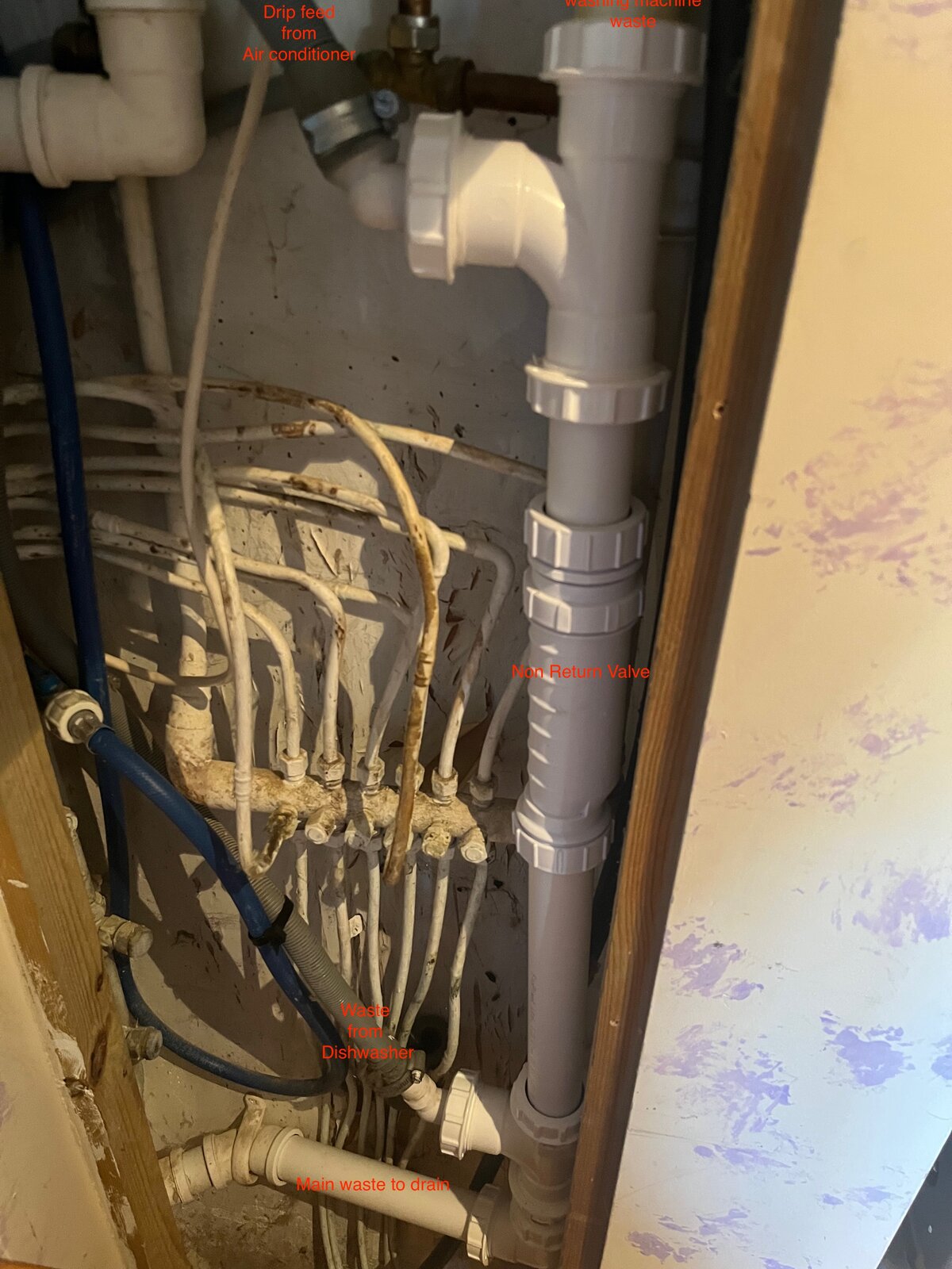

Hi MM
Thanks for your message.
Air con unit is higher than the hose . I have annotated in red which feed is which on the pic. The air con does not produce large volumes of water. The spurting issue has only happened when the machine is not in use. Air con is the top grey hose as annotated. dishwasher is far lower (second grey hose near bottom) . The waste only travels to the end of the pic horizontally - there is a fall off .....There are no arrangements for air discharge.
Which white T should the air admittance valve be above?
Your dishwasher is now connected below the trap, which is bad.
It seems to me that there must be a blockage or constriction downstream of what you have shown.
Hi - That was done as water/air was forced upwards when the dishwasher flushed out to the grey hose above. Thss is a small amount of water that came out in a single spurt at pressure. Theres no blockage - it's been taken to bits and checked twice in the last week. It's no longer happening following the non return valve addition. Theres gurgling and a localised smell now which needs addressing.
You've answered some of my questions, please have an attempt at the rest.
You have only one white tee that I can see, at the top of your photo.
If every outlet has a trap then foul air cannot escape and cause your drains smell.
The not return valve causes a small backpressure when the dishwasher discharges, possibly blowing a small amount of water back towards the a/c. The AAV is to stop the discharged water pulling the sealing water out of upstream traps.

Hi
The lower connection is the dishwasher. The A/C collection tray is within the wall unit. It's not visible without removing the housing and even then you would have to take it to bits to access it but there is a hole that feeds drips it to the outlet. It is not sealed. The air con engineer checked the flow of the tray that spans the width of the unit very carefully.- I am not sure of the drain run under the house.
There is a second tee further down where the dishwasher feed is marked in red.
I think that covers everything you have asked me....
Since the non return valve was installed there have been no further spurts however its gurgling and as we removed the trap which was at the bottom of the right hand pipe before the elbow turns left, there is a smell now. I can't see how a trap could be fitted to all those connections in the space. I can reintroduce the trap and add an air admittance valve?

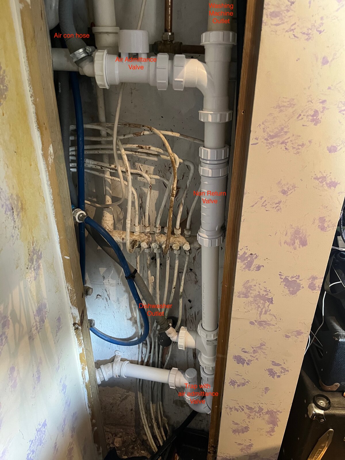

Hi
The scenario is close buy not quite correct in that the air con is off when these smells happen. The odur is to do with the piping and removing the trap
I have updated the piping to include an air admittance valve on the branch where the air con drip is located. I have reintroduced the trap at the bottom but now with another air admittance valve. Smell has now gone, and there was no blow back/spurt through the air con when I ran the dishwasher. However this morning I ran the washing machine and when that emptied I had a single spurt out of the air con unit. There is no room to add a trap to every device. I have today ordered two non return valves for flexible hoses for both dishwasher and air con feed. They will be here tomorrow. I would have thought that might stop it. Im enclosing an up to date pic of the changes...

How is the Washing Machine connected, it's not visible in the pictures?
Needs to be an air break where the Pumped appliances connect, I'd wager the washing machine is also on a sealed connection, you've a blockage downstream in the waste pipe, and when either the washing machine or dishwasher pumps out, the water cannot get away quickly enough and is blowing air and water back up the line, which is then exiting via the only route possible, the Air Con Unit.
Get rid of the AAV's they'll do nothing to help this situation. The issue is with positive pressure, not negative, as the water cannot get away quickly enough and is effectively trying to enter a sealed chamber, so is looking for a way to displace the equivalent volume of air from within that chamber.
Fit a Standard open standpipe, connect Washing machine and Dishwasher at the top using a McAlpine V33WM https://www.bes.co.uk/mcalpine-appliance-twin-connector-11-2-or-40mm-25172/ Couple your Air Con drain in just below the top using a Tee. Ensure the waste pipe is clear along it's full length, and there are no dips in it where water/crud can collect.
