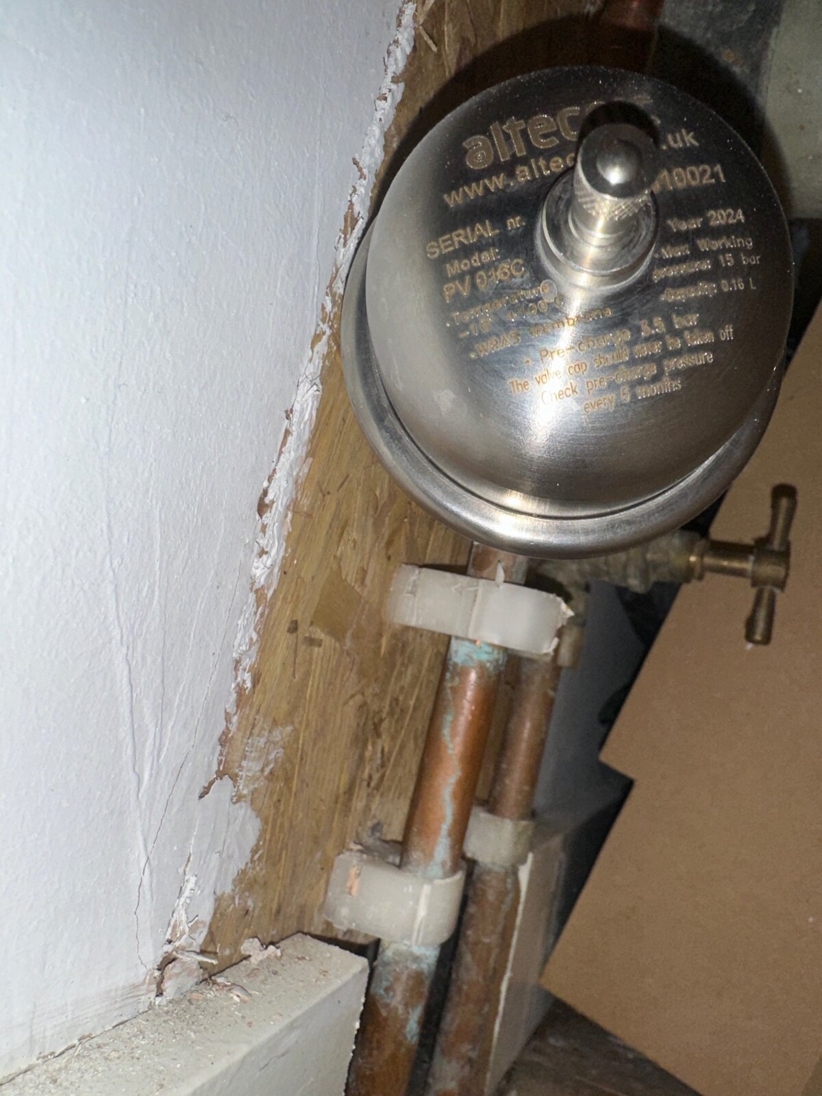

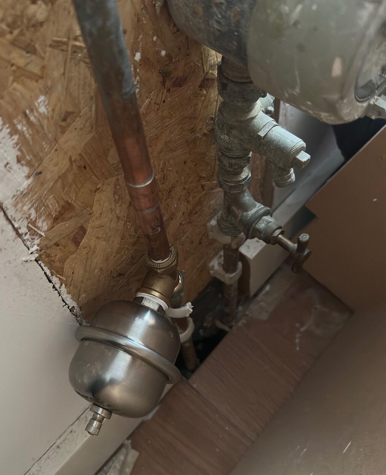

To try to fix, we asked a plumber to fit a ‘proper’ arrestor near the pipes close to the meter (see photo). The arrestor was fixed to a second pipe (pipe on the left) that previously also had a tap no it. We don’t know what purpose that tap served but the plumber thought it was pretty much redundant. The tap/valve on the right is the main stopcock.
Given the set-up and the fact that we now have a small screw-in arrestor on the back of the washing machine and a larger arrestor on the ‘second’ pipe next to the stop cock, can anyone suggest a next step? I read somewhere that I could try turning the valve to reduce flow of water coming in to the pipes and to the taps but that isn’t really solving the problem…

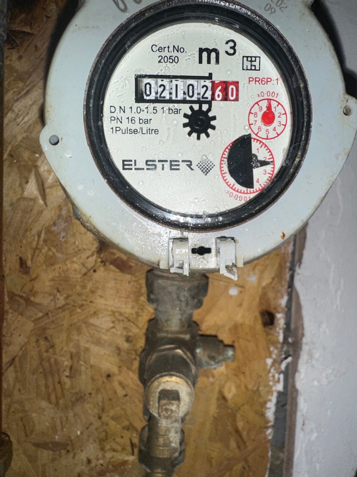

Apologies for the delay folks but I now have the photos and feedback to your questions - and thank you for your collective input thus far.
Firstly, see photos of the arrestor and my water meter which show pressures etc. I will def need your advice on what is suitable etc here.
FYI, I have turned the tap a quarter turn (to lessen flow according to the posts above) and I think that helped slightly with the hammer but its still very much there especially when washing machine is on!
Re: pipework, I have a feeling some of the pipework might be unclipped (knowing that the builders who built our extension some years ago fitted or moved those pipes close to the meter and cut corners in other areas) but I do not know for sure and it would mean ripping down sections of plasterboard walls to investigate. I'll do this if nothing else works but it is also worth remembering that the extension was completed some 5 years ago while the hammer is recent (unless the pipes have comes away from the clips over time due to the pressure?) and going back to my OP, the hammer (coincidently?) appeared after the water mains repairs.

Also, does anyone know why we had 2 taps originally (the plumber says he will remove the arrestor and refit a tap as the former hasn't worked)?

The 2 taps may have been down to 2 different supplies or may have been to isolate a separate outwards supply.
