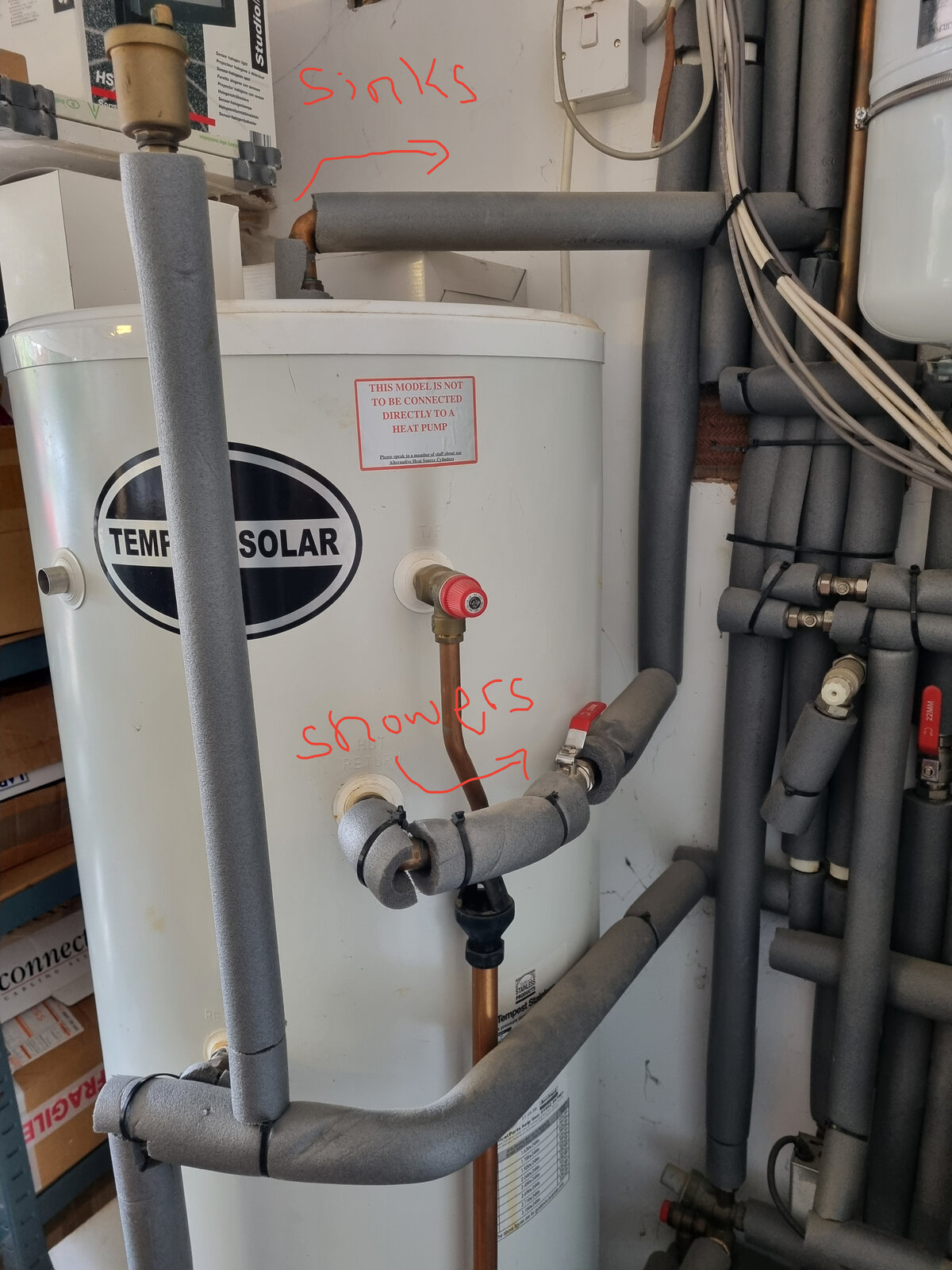

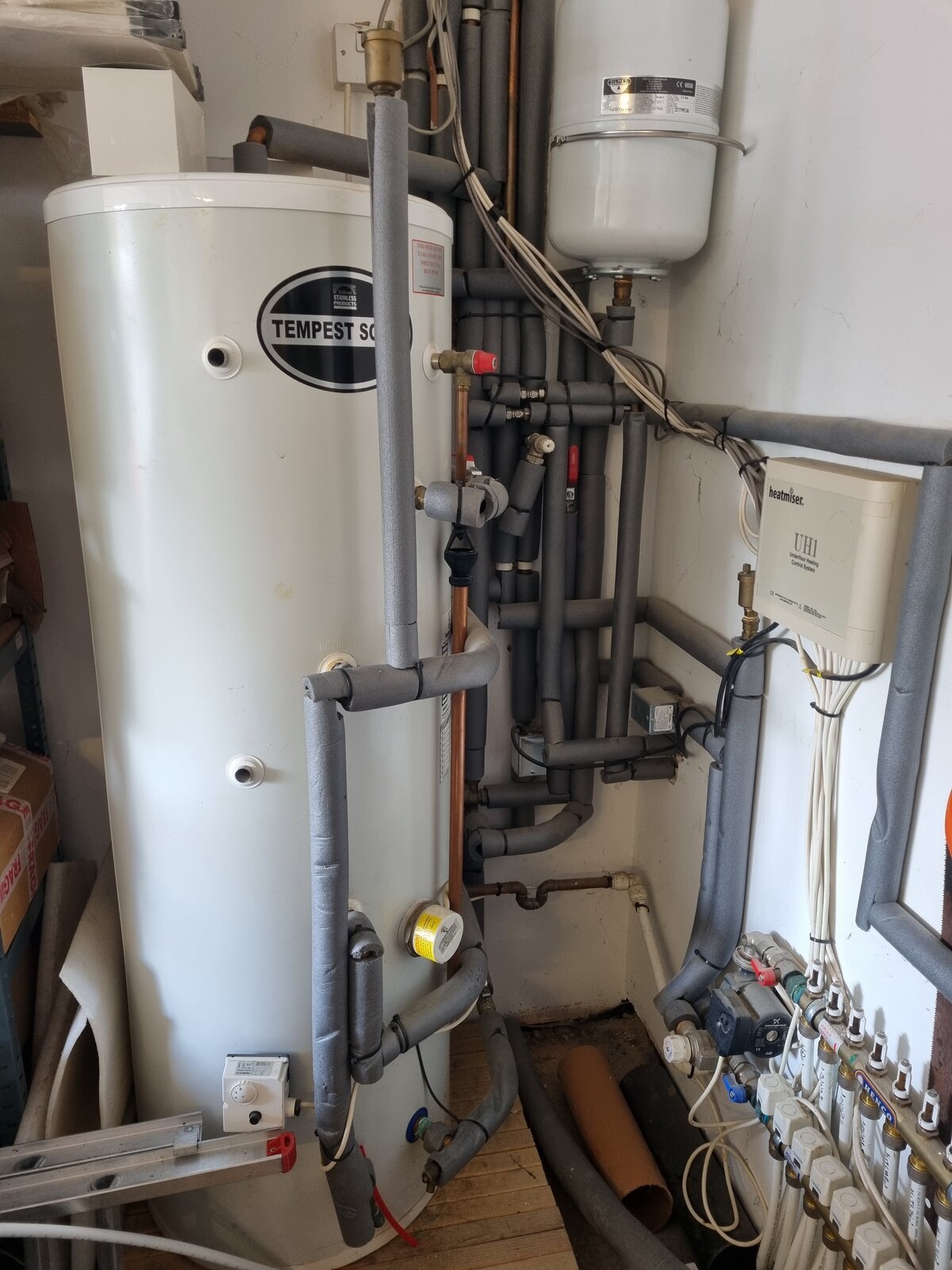

Hi there,
hopefully someone can help figure out this issue we've been having for a few weeks now. The system is 13 years old and has been fine up until now, nothing has changed.
We have a unvented cylinder as per pics, all the sinks in the house (kitchen, utility, wc, en-suite and master bathroom) take an age for the water to get hot, when (if) it eventually does get hot it goes cold again and remains cold. The showers in the house are absolutely fine and remain hot.
In the pic, the pipe to the showers (marked) from the cylinder are always hot, they only feed the showers. The pipe at the top of the cylinder feeds all the sinks and this pipe will be hot at first if the hot water has not been run for a while but quickly goes cold when a tap is run.
It does sound like an airlock of sorts but wouldnt know where to start.
Appreicate your thoughts.

Why are the HW take offs from two places??, one would think that the top one (sinks) should stay hotter longer than the shower (lower) take off as the cold water rises up through the cylinder on HW draw off.
One possibility worth investigating is to see if there is a secondary circulation pump. Such pumps are used to ensure hot water circulates all the time so that turning on a hot outlet results in (almost) immediate hot water flow.
Such a system requires a special pump (bronze of stainless steel) and is often time controlled to avoid running when there is little call for hot water (e.g. overnight). If the pump is faulty, or has been switched off, it might cause the symptoms described. It would also explain the two hot connections. The one coming off the top of the cylinder is the normal one to all hot outlets. The lower one (just above the tun dish) could be the return for secondary circulation.

Hi, no the hot water for the sinks is definitively coming from that pipe at the top as I can feel the water rushing through.
No idea, was fitted that way from the beginning. I recall the heating engineer saying he had separated the showers from everything else as it was beneficial, I can't recall why now.
Did look for one but there are no signs of it, cheers.
Yes, the shower HW take off actually is from the HOT RETURN, its stamped on it, below where you have written showers. You say the taps run cold after running hot after awhile. Is the top pipe still very hot a few feet along from the top?, just wondering if you have a mixing problem somewhere on the taps system.
As the top pipe comes out it starts hot and is hot if you follow it along but then cools down and becomes cold as you head back so as if cold water is being pushed into the cylinder.
I noticed this with the pipe to downstairs WC which is the nearest to the cylinder. I isolated the hot water feed to this and it's definitely made things better, the kitchen tap is hotter and stays hot longer but it does cool down, but still hot. Upstairs, they stay cold however.
A mixer problem sounds plausible now, on the weekend, I'll isolate all the taps one by one and see if I can track it down to more than 1 dodgy tap.
