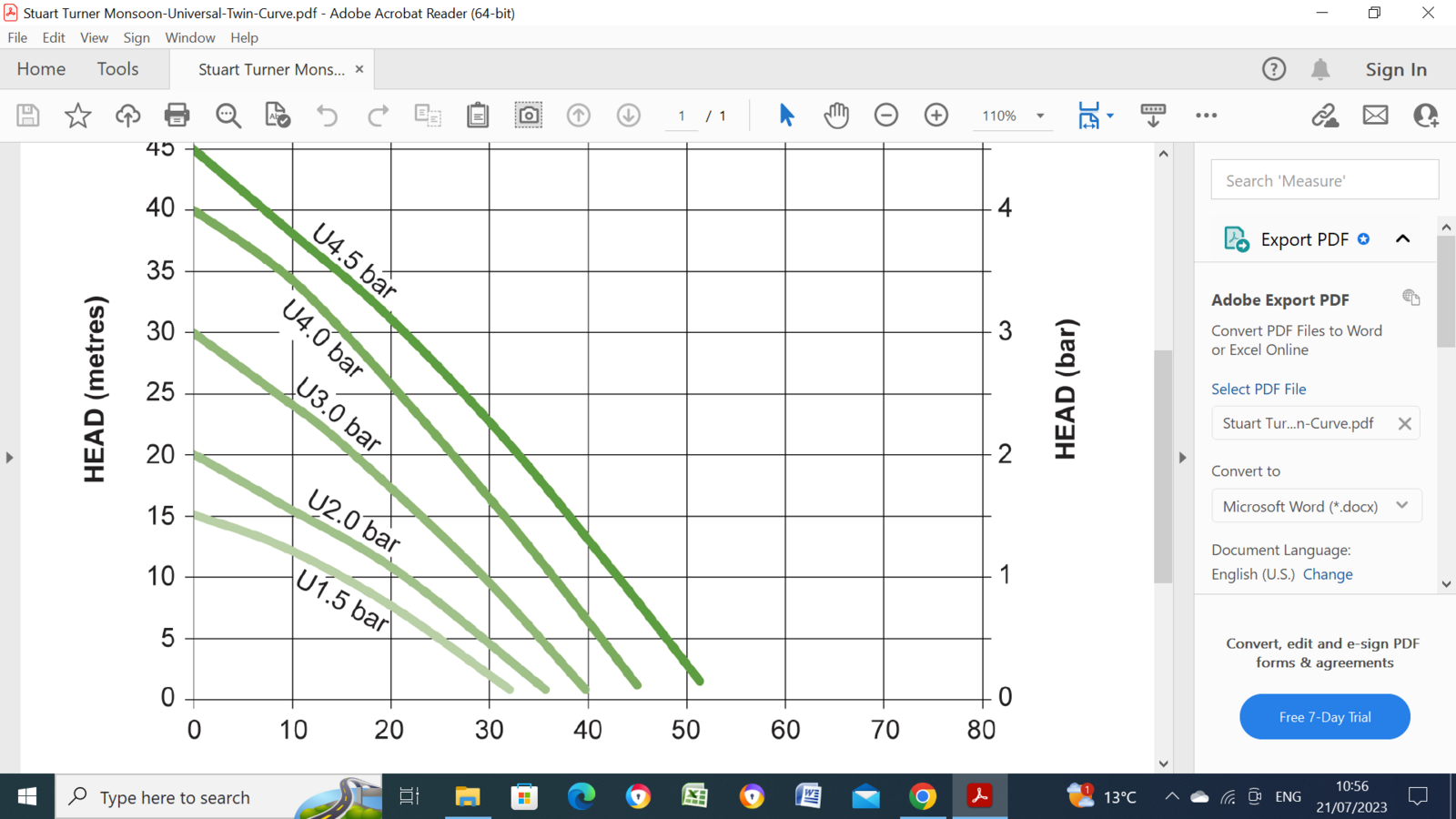

I have a four bed house with two showers - Over the last two months I have replaced the coffin tank in the loft, the vented indirect cylinder and now installed a Stuart Tunrer Monsoon 3.0 Bar Pump.

I have to say that I am not that happy and think I made a huge mistake - I should have had an unvented megaflo like system installed and got rid of all of this - It would have saved space and been cheaper and pressure would have been better and would have been more fancy. The pump is also noisy when it operates
My partner wants to remove it and have a MegaFlow installed
Did I make a mistake by keeping it simple and using a vented cylinder? What are the advantages of a vented cylinder and why would anyone buy one if they have good mains pressure

The 3 bar pump should still give 2.2bar with two showers in service at say a total flow of 30LPM or 15LPM per end, you will need a fairly good mains suppy to provide all this 30LPM at the same head, you could install a 4bar pump if you require a head of 3.0 bar if this head is required to give you that flowrate.
