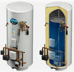

Never actually seen how one is made but it may be the same process of how other cylinders are made whereby a blank is pressed out of steel so it only has one open end, the coil etc is then installed and then base is welded on, therefore that's the weak point?
Good point, the top seems to be part of the extruded metal.

I found this, which would explain why the weakest point is going to be the bottom plate brazed/welded on.
But............ I had a look at a promotional video for Macdonalds water storage and it looks like the process they use welds/brazes side/top and bottom.
Just noticed now that this is the type with the expansion vessel in the body of the tank, so manufacture process is likely to be different.
I still don't know why/how they got it to fail at the bottom, there is likely to be a reason if not by design then by physics, I don't know what it is though.

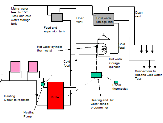

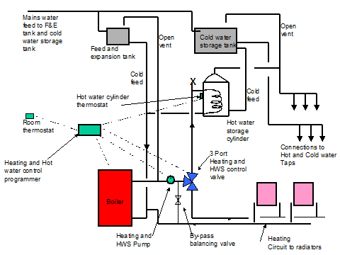

An UV HW cylinder can be heated by the same heat source that can heat an open vented HW cylinder. If the pump currently pumps the primary HW system and the CH circuit, i.e. they are on the same flow and return pipework but are separated by either 2x2 port valves or 1x3 port valve, then it would be classed as a fully pumped system.
Only when there are larger pipes coming from the other side of the boiler, separate to the CH pipework and only heats the HW primary circuit would it be classed as gravity HW.
Gravity HW with pumped CH ............................................................. Fully pumped Y plan ( 3 port valve - would be an S Plan with 2x2 port valves)
