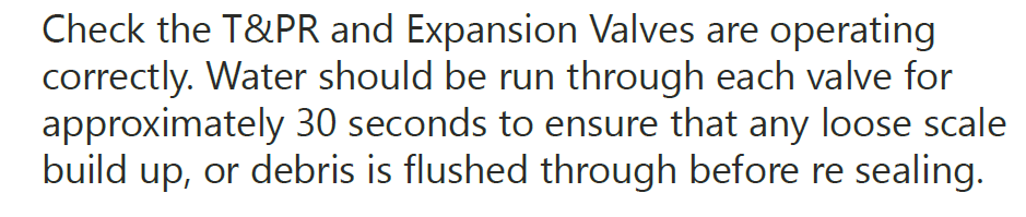

Re unvented cylinder testing, (see below) does this imply that you just lift the valve seat by means of turning the lifting knob on the top or are they meant to be pressure tested to ensure that they lift at their design pressure, is the operating temperature of the T&PRV ever tested. I wonder how many G3s actually do any of this?.
I had decades of marine & industrial experience of high and low pressure steam boilers and the safety valves on these had to be tested (lifted) every 12 to 16 months under operating conditions with a insurance inspector in attendance. Unvented HW cylinders are generally full of water (apart from the air bubble type) so the consequences of a cylinder failure is much reduced as water is by and large incompressible so no expansion effect to blow anything very far, unlike very high temperature hot water which can happen with electric heated HW cylinders, if such a cylinder ruptured at say even 5bar and the HW temperature had reached 160C due to a faulty stat then over 10% of the water will flash off into steam at atmospheric pressure and the expansion effect in falling from 5bar to 0 bar will certainly have a catastrophic effect. Thats why you see Utube videos of rupturing HW cylinders heading for Mars .
TPRV are anything up to about 100 quid and the trouble them is they do not always reseat so its a case of that valve that was ok before i touched it now needs changed
