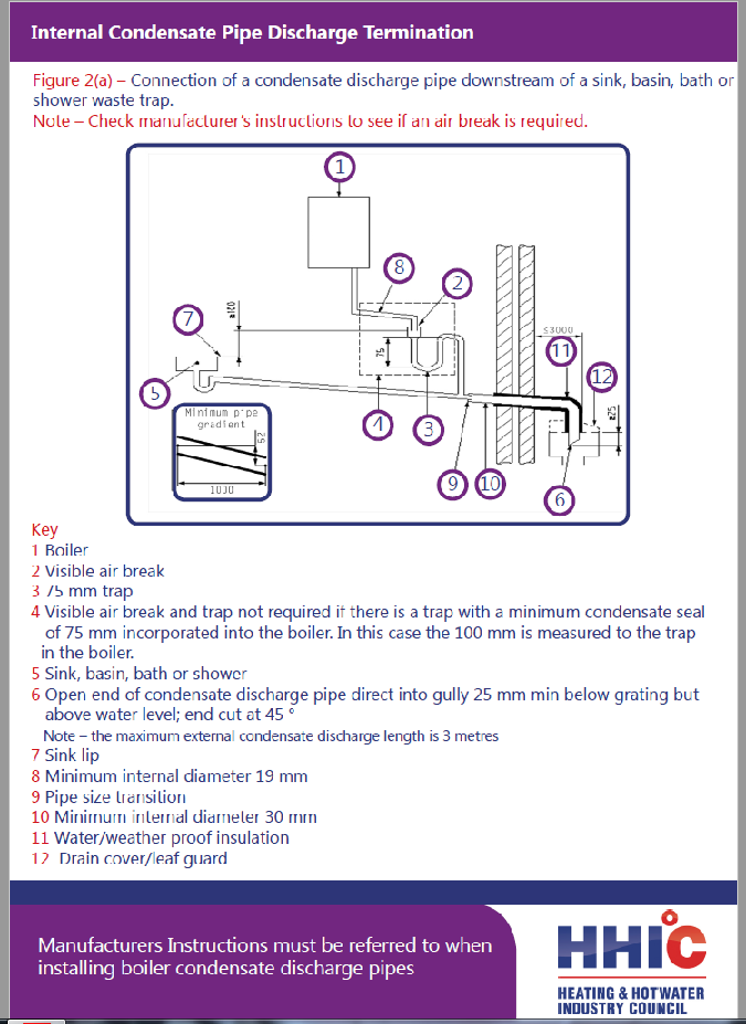

The discharge needs to be a dedicated pipe with no other appliances connected into it before it reaches the stack. It must be run in high temperature resistant pipe, via a dry trap such as a HepVo with a tundish adapter on it
Item 2 the visible air break is your tundish
Item 3 the 75 mm trap is what would have prevented sewer gas coming out of the tundish had the installer fitted it.

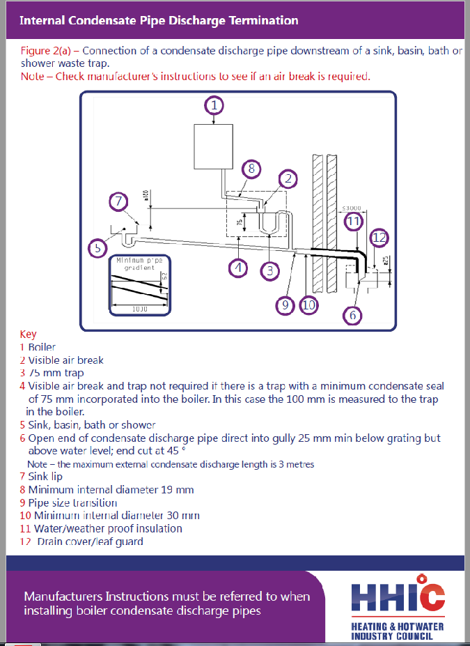

Wrong again Bernie - this is the discharge arrangement for a boiler condensate pipe. The OP is asking about the arrangement for an unvented cylinder discharge, which is very definitely not to be installed in the manner described in your post
