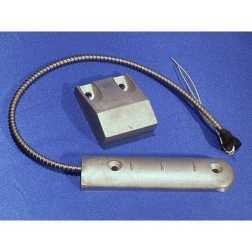

I currently have a bulldog garage door lock fitted to up and over door but after a speight of break-ins I'm looking to fit an alarm .I have power in garage so I'm looking to fit wired contacts to door and siren inside garage.I would rather have alarm go off as they are breaking in rather than pirs.Do I need to fit contacts to each corner of door? as I know they sometimes lever the doors up from the bottom or force the door in from the top.Is the a kit that does this or do I have to buy separates? I am diy capable any information advice gratefully received.
Thanks.
Search for a Roller Shutter Contact and fit one to the Up & Over, if it is a large one fit one at each ground level corner, one would be the norm.
The property belongs to housing association and they will not allow me to fit roller shutter.
I think Europlex means to fit a roller shutter door contact to your up and over door, not to change the door.
I have a couple of these on the floor/door of each vehicular access door.
