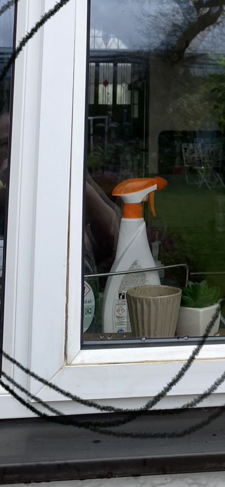

UPBC window loose
31 Oct 2013
116
3
Birmingham
Hi, the white plastic beading on the exterior of our double glazed window has come a bit loose. Can this just be stuck back in place and if so, what would you recommend using? Or does it need replacing please?
I’ve attached a photo as my description isn’t very good.
Thank you
Jay
Those beads normally have an L shaped protrusion at the back and a ridge with a slight lip at the front. The back edge slots into a similar L on the window frame and the front of the bead then clips in. A slight compression keeps everything in plce
It looks like the front ridge has broken off your bead, so you may well need to replace it if you can find out what profile your window uses (if you remove the window it may be printed on the window frame)
Alternatively you can look to pin it in place with a small screw in the right place but I'd point out a couple of things;
1) it's possible that the plastic has degraded and become brittle so you might cause further problems, and you might also experience similar bead breakages in the future
2) this window appears to be beaded on the outside, which is something of a security risk - all that is needed to remove a pane of glass from this window and gain easy, silent access to the house is to lever the beads off with a scraper or wood chisel. You might consider changing the window out for one that is beaded internally
That was my first thought, the beading was on the wrong side.
Sadly, for the OP, the whole window, and any others in the same way round, really needs taking out and reversing to the correct orientation. You may have problems with your insurance if burglars get in by removing the trim and glass.
As atemporary measure, you could try a squirt of super glue to keep it in place and remove the visual signs.
I'm afraid you make it sound as if the window has been installed the wrong way around.
Many uPVC windows have external beading - early ones do pose a security risk, whereas modern ones have an interior wedge gasket, that must be extracted, before the beading can be removed.
Simply reversing a window, that is meant to be externally beaded, could cause issues with water ingress.
In this case, it does appear as if the beading is damaged/decayed, and if lucky, could be matched and replaced.

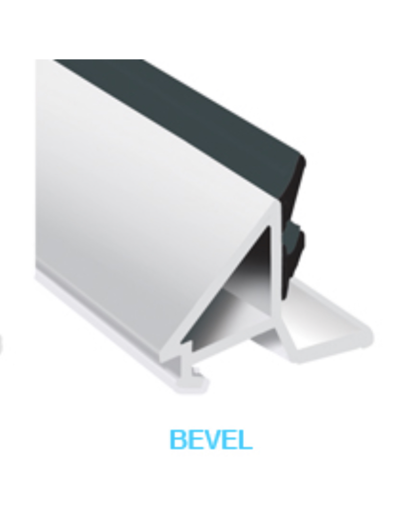

Agree about the bevel on the outside...I had a couple like that in my old house. Fortunately they were on the upper floor. Glue them in if need to keep them. Gorilla glue
