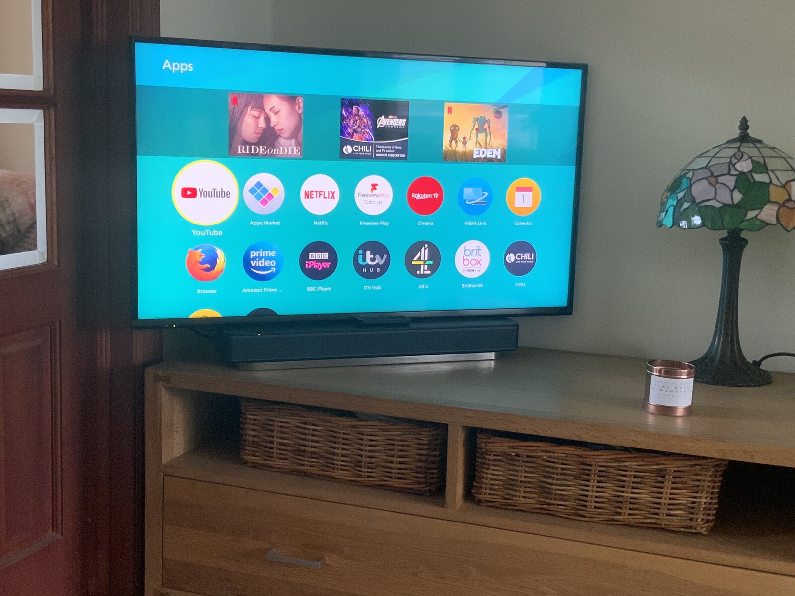

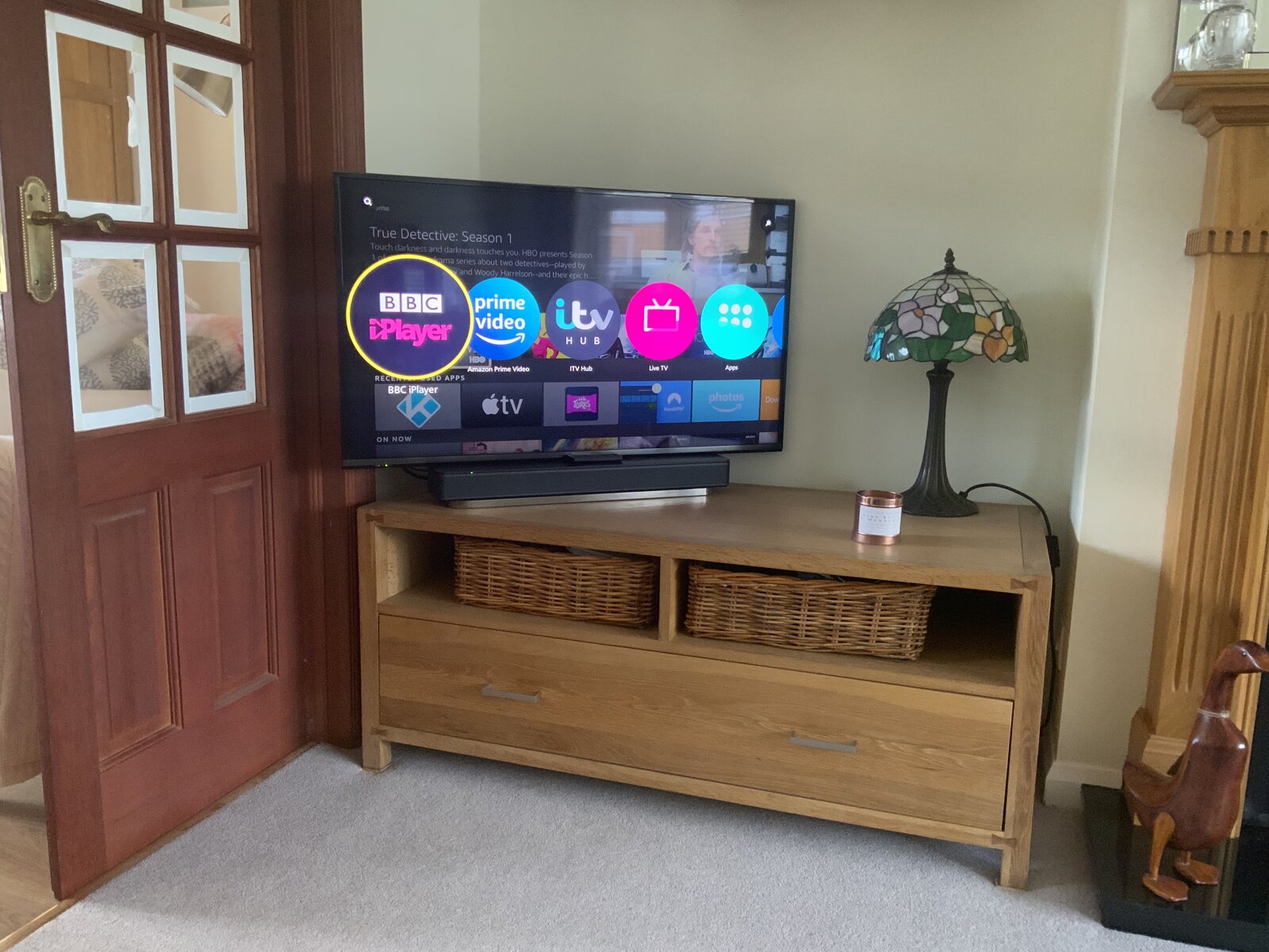

No aerial. Just connected to an ethernet cable. I have the same setup at work - no aerial. Depends what you put on your home channel. I can watch any channel I like and that’s on a fairly ancient smart TV. Could even do it with no ethernet but ethernet is a quicker more stable source.
