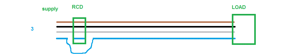

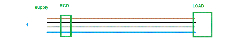

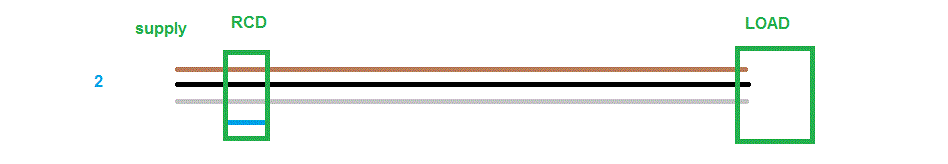

OK like so many of these threads I think we are at crossed purposes.
Hopefully this will clear the confusion:
No.1 is a multicore cable with a neutral. The CABLE and the RCD will be balanced regardless of the balance of the PHASES
No.2 is a multicore cable without a neutral. The CABLE and the RCD will be balanced regardless of the balance of the PHASES
No.3 is a multicore cable with a neutral. The CABLE will be balanced regardless of the balance of the PHASES, but the RCD will trip if there is any sort of imbalance of the PHASES .

OK like so many of these threads I think we are at crossed purposes. .....
No.1 is a multicore cable with a neutral. The CABLE and the RCD will be balanced regardless of the balance of the PHASES...
Agreed.
I don't really get that one. Unless the currents in the three phases are identical, there will surely be a finite vector sum of the currents, won't there (i.e. the cable is 'not balanced'). Think of fairly extreme situations, in which there iis little or no current in one or two of the phases. In such a situation, if only the three phases ( but not neutral) went through the RCD (per your diagram), the RCD would trip, wouldn't it?
In any event, an RCD which had only phase conductors going through it would surely serve no useful purpose - since it would not detect phase-neutral imbalanceds due to faults to earth?
Kind Regards, John
Agreed.
Doesn't the magnitude of the vector sum of the currents in the 3 phases always equal zero in this case?
Edit - 'cos, referring to EFLI's post below - if there is no neutral then there is nowhere for any unbalanced current to flow. You can't connect a load between phase and neutral if there is no neutral, so all loads must be phase-phase.
Re: #2
If there is a neutral not running through the RCD, it would, but not if there is no neutral.

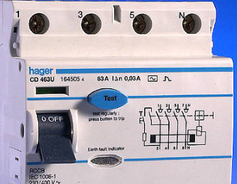

Surely it will still detect residual current.
The test button on three phase RCDs does not use the neutral.

I was using this for information:
On further investigation, I find some which do (or show they do) connect the test button circuit to the neutral, so ...
Dunno. I've never used them, let alone taken one apart (I use separate L+N RCDs for each phase in my house). What does the test button do, then?
If you have no neutral, and no current in two phases, where is the circuit which you need for there to be current in the third phase?
But you were not talking about that situation in your reply to Sunray.
Look at the drawing, and compare it to #3 & #4.
#2 is not "a situation in which there was a neutral, but not in the same cable as the phase conductors", that's #s 3 & 4.
#2 is the situation where there is no neutral anywhere.
