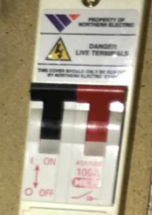

Upgrading 60A main fuse to 100A

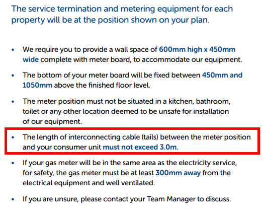

It's just that for longer than 3m, the DNO stipulate a fuse switch
Not in this case:
unless the CU was moved several m after that was installed....
It seems to me that this 3 metre “requirement” is of much greater importance to the burghers of this forum, than to the DNO!
they wouldn't have measured the length of the tails though would they??!!!
Probably not literally, although they would probably have noticed if the distance from meter to CU was 'unusually long'.
Having said that, I don't think a DNO (or supplier) would normally fit a switch-fuse, even if/when they deemed one to be necessary - that being a job for the consumer's electrician. It could be that they fitted that isolator to facilitate that, informing the consumer that he ';should' have a switch-fuse installed immediately downstream of the isolator.

No but as TTC said "It seems to me that this 3 metre “requirement” is of much greater importance to the burghers of this forum, than to the DNO!" perhaps it's just another myth because of someone misreading 434.
Mmmm. Somewhat restricting for flats.
No mention of any exceptions nor the requirement for a switch fuse.
That refers to new installations but I don't see that being any less restricting.
It's certainly not (or, at least, was not in the past) a complete myth since, over the years, I have seen several instances of a supply (cutout) and meter being moved (during refurbishments) such that the meter-CU distance was quite long, with the DNO saying that they would not connect the moved supply until an electrician had installed a switch fuse.
Kind Regards, John
So, they do refer to BS7671, possibly misinterpreting 434, which governs the consumer's tails - or they make up their own rules and demand a fuse even if it's the same rating as their own for some unknown reason.
Which bit of 434 do you think can be misread to create a 3m limit?
How challenged would someone have to be to not spot that that limit is in the context of a reduction in conductor size?
