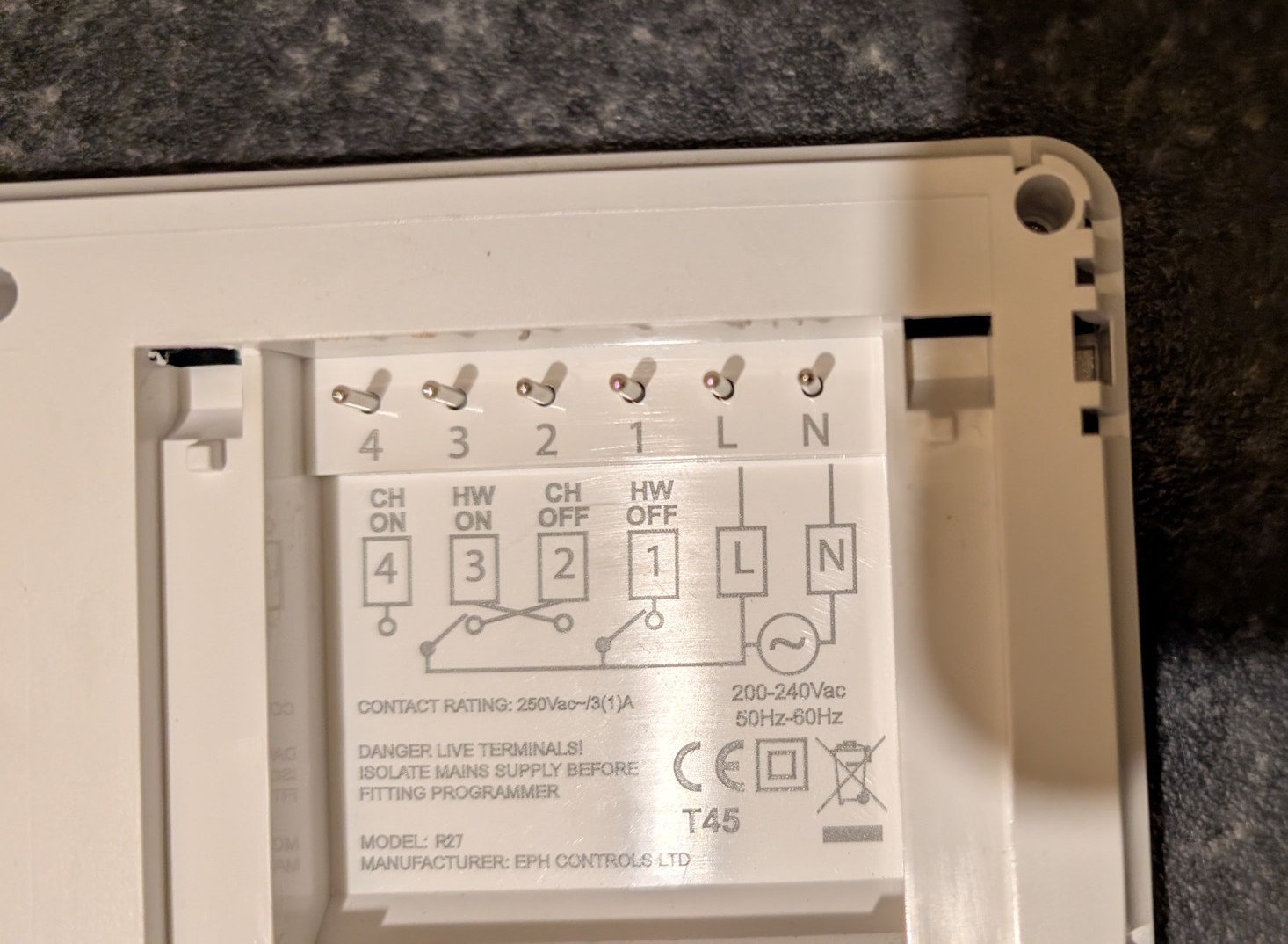

I'm hoping to switch my old Electronic Programmer from an EPH R27 over to a Drayton Wiser 2-Channel Kit.
I thought it would just be a case or removing the old EPH Programmer and popping on the new Drayton Smart Hub.
But it seems things are backwards in terms of functionality when I do.
Turning on the Hot Water on the Hub starts the HW + CH
Turning on the Central Heating on the Hub starts the HW (no CH)
My existing Electronic Programmer has two Zone buttons on it. Zone 1 and Zone 2.
They weren't specifically labelled as HW and CH on the buttons or LCD display, but when I removed it and looked at the back of the programmer they are for the pins that connect to the Backplate
When Zone 1 is powered on, it runs the CH (+HW)
When Zone 2 is powered on by itself, it runs the HW only
When both Zone buttons are activated, it is the same as just running Zone 1 as it does both HW+CH anyway
It seems like maybe that the HW should actually be Zone 1 and CH Zone 2

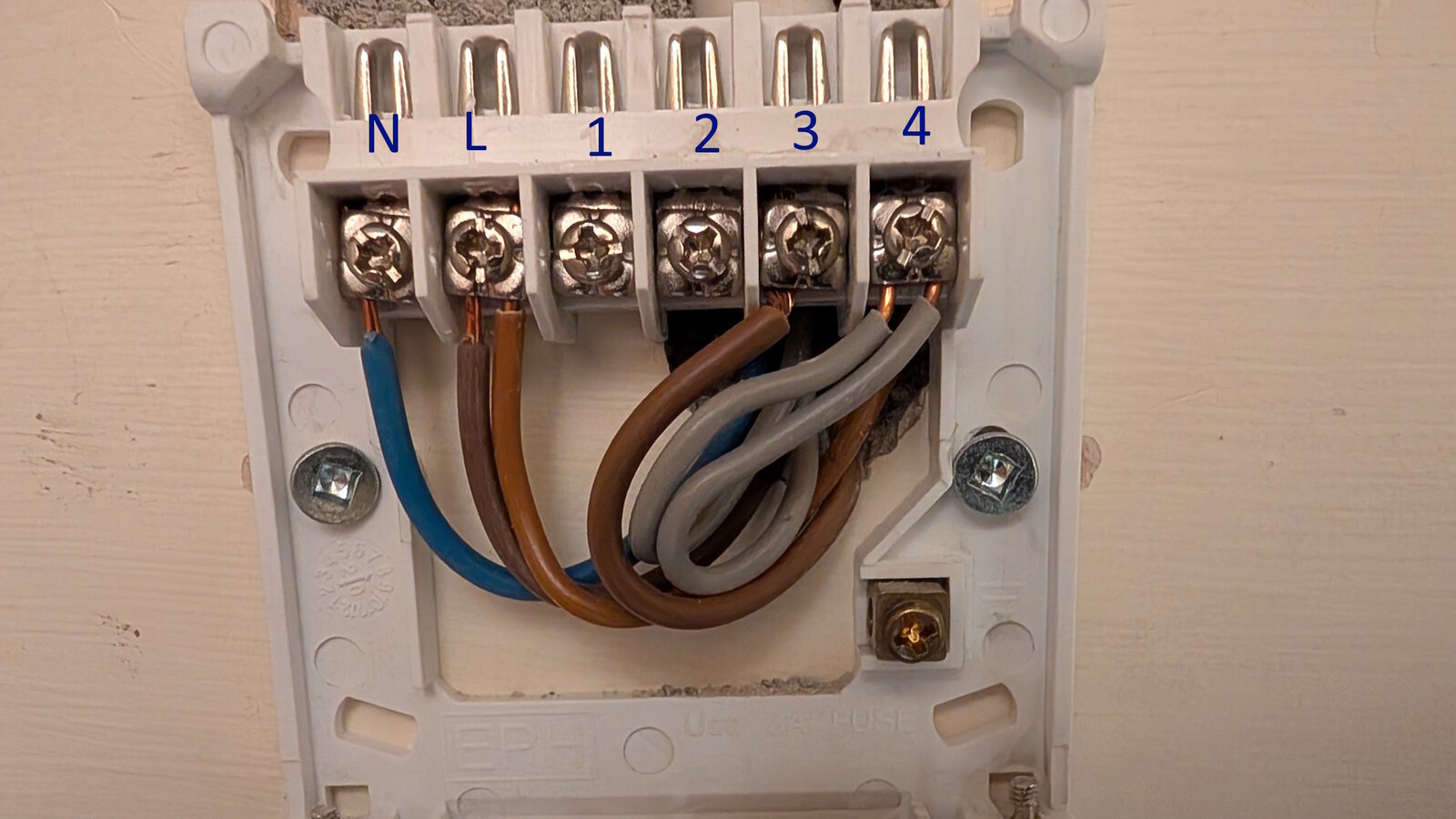

I'm not sure if my Electrician wired up the programmer incorrectly when he fit it.
I switched from an ancient Firebird Super-Q 5-90 Boiler that had two switches. HW and HW+CH and replaced with a new Warmflow Condensing Boiler.
When the electronic programmer went in, the Electrician labelled Zone 1 as HW and Zone 2 as CH but that was never the case.
They were actually backwards when the buttons were activated. I just put it down to him labelling them incorrectly but now I suspect that maybe he wired 3 (HW) into 4 (CH), and 4 (CH) into 3 (HW)
The Backplate is wired into a fused switch also.
Would it just be a case of me switching the wires going into 3 and 4 respectively?
Taking the 2 grey wires in #4 and putting them in #3, then putting the brown wire in #3 into #4
Or is it best just to get an electrician back?
Thanks in advance.
