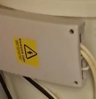

And sorry, you haven't showed us behind this panel yet, either...
I suspect your new build had a ready built, pre-wired system installed - everything from the zone-valves to wiring centre was supplied ready mounted to the cylinder.
This makes for a much simplified install for the builders.
I am not familiar with the system, but there could possibly be a built-in wireless receiver, that would make installing the stats even simpler?

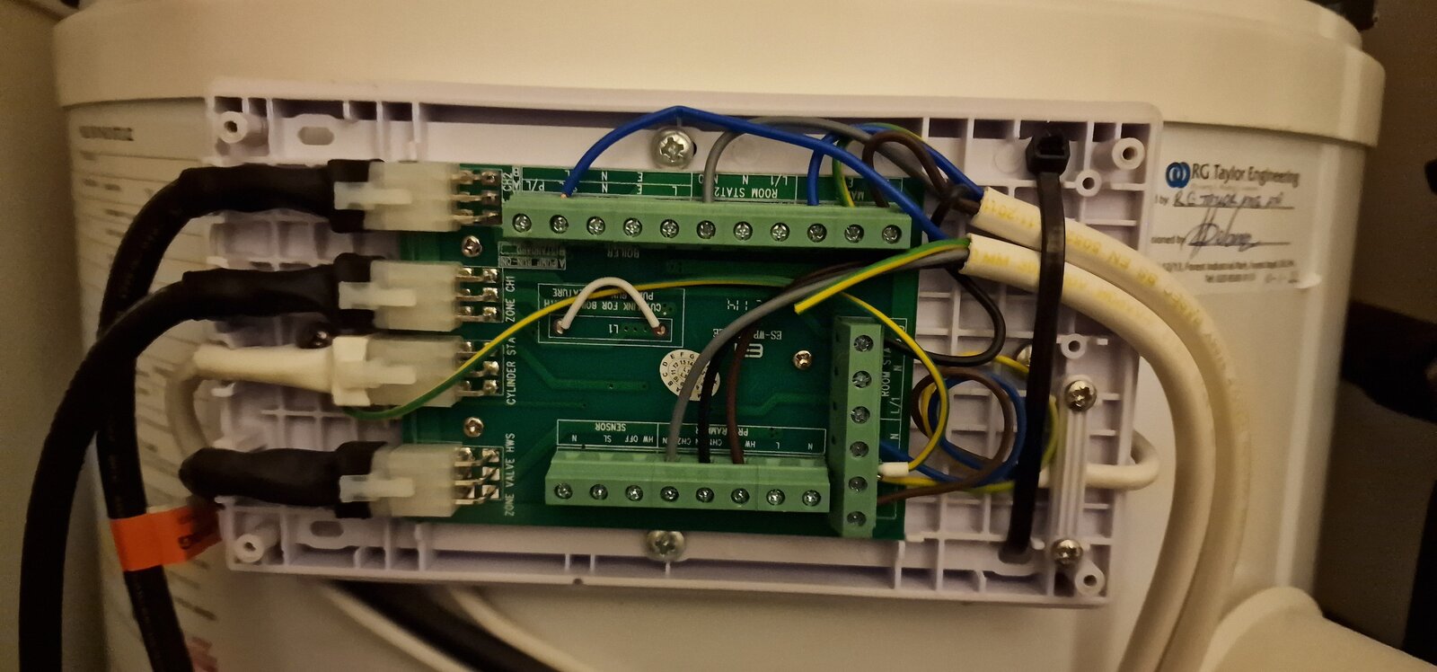

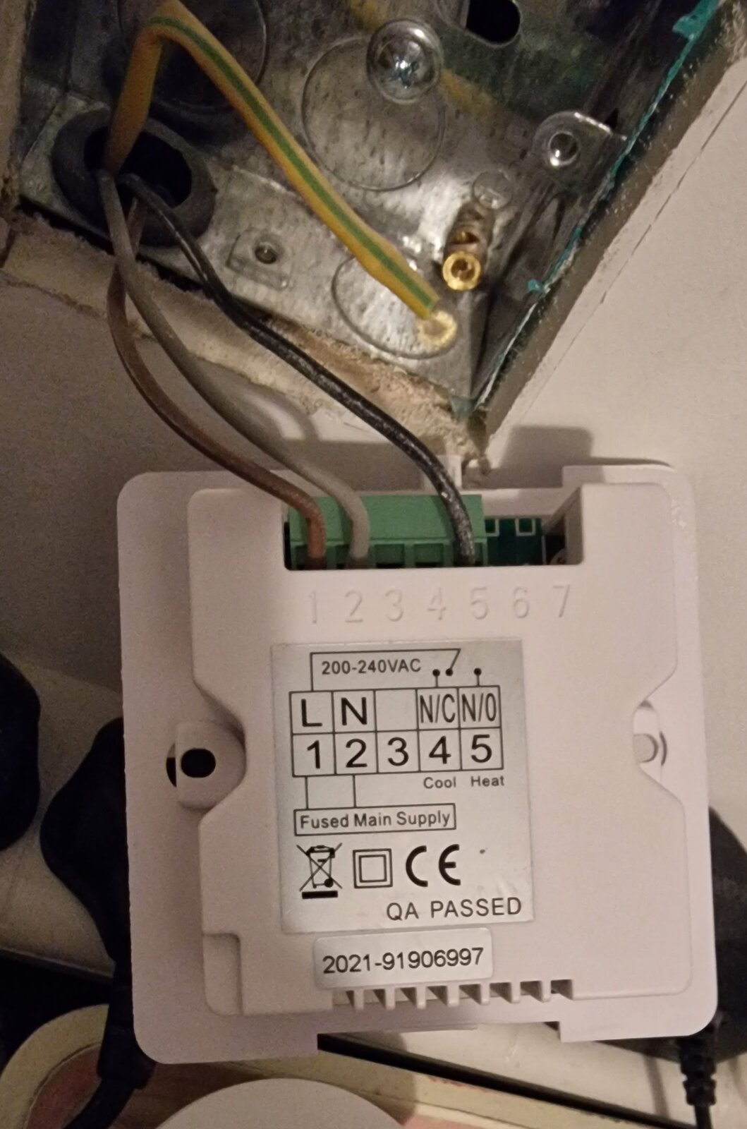

okey dokey , inside of my room thermostat, and that extra controller on cylinder
Ok, great, there's no extra logic going on in the cylinder wiring centre.
Behind the old backplate, (with power isolated), move the brown wire into terminal 5, along with the black wire.
Hopefully, your new stat should then have full control.

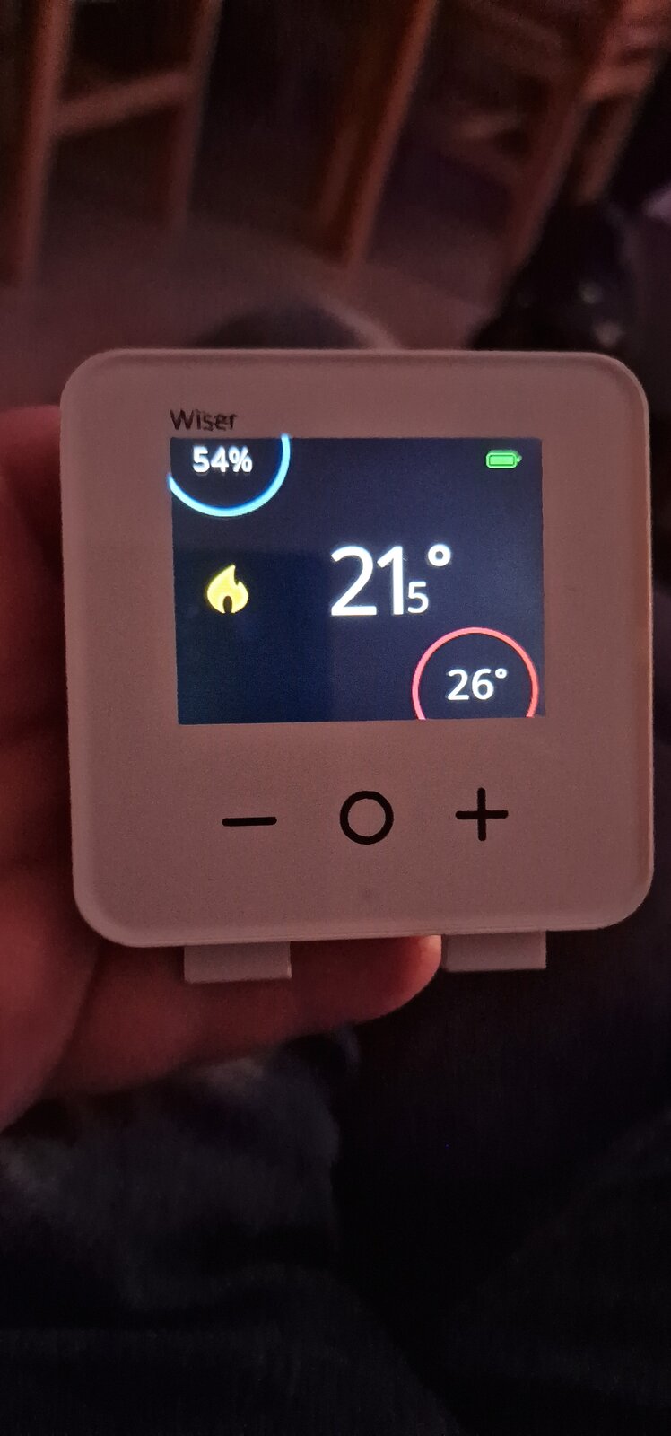

actually update, it does seem to turn on eventually, but only after i hit boost and then it doesn't turn off! :(
I believe the default boost duration is an hour on the Wiser.
Did you change the setting, or wait out the hour?
You need a bit of patience when testing the Wiser. The stat makes a call for heat to the hub but the hub does not respond immediately. It might take 10 minutes for the heating to come on. Also when the room reaches the required temperature the heating will stay on, often until the temperature overshoots the target by 0.4 degrees. There is a bit of inbuilt logic that might not seem logical at the time.
