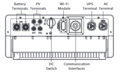

If using a 13 amp fuse I would think ELI 2.42 Ω or 95 amp is needed to rupture it within the time allowed, or it would need RCD protection or some protection within the inverter but then there would be some thing to reset or a fuse to replace this
does not show any reset button, and I can't see an inverter giving out 95 amp to blow 13 amp fuse. And no built in RCD again there would need to be some way to reset if there was.
Am I going daft?
If using a 13 amp fuse I would think ELI 2.42 Ω or 95 amp is needed to rupture it within the time allowed, or it would need RCD protection or some protection within the inverter ...
Glancing at the curves for a 13A BS1362 fuse (which I presume is what you are talking about), it looks as if a bit less than 95A (maybe about 80A) might be adequate to achieve required disconnection times, but what you say is certainly in the right sort of ballpark.
You are talking about a UPS. The question then arises as to whether or not the UPS is capable of supplying 95A (or 80A, or whatever). If not, then fault protection would presumably have to be provided by an RCD (with, of course, the output of the UPS earth-referenced).
Kind Regards, John

There is an earth rod, so there is an earth even when no connection to DNO supply, there is a 3.5 kWh battery and solar panels so between them there could be quite a high current, but the instructions for the inverter are not clear as to how much power could be drawn.
Noted some odd displays where although battery not fully charged still exporting, so there may be some limits.
I expected one RCBO feeding all UPS outlets, this would also mean easy to isolate outlets, but this is not the case, so trying to arm myself with reasons why the central heating supply should be RCD protected.
Regardless of the capacity of the battery, do you really think that the inverter would be capable of delivering 80A+ at around 230V (i.e. enough to rapidly blow a 13A fuse)?
I suspect that, under near-short-circuit conditions, the inverter would just stop, either because of built-in 'short-circuit protection' or, even in the absence of such protection, just because it was 'overwhelmed' by the load.
Kind Regards, John
