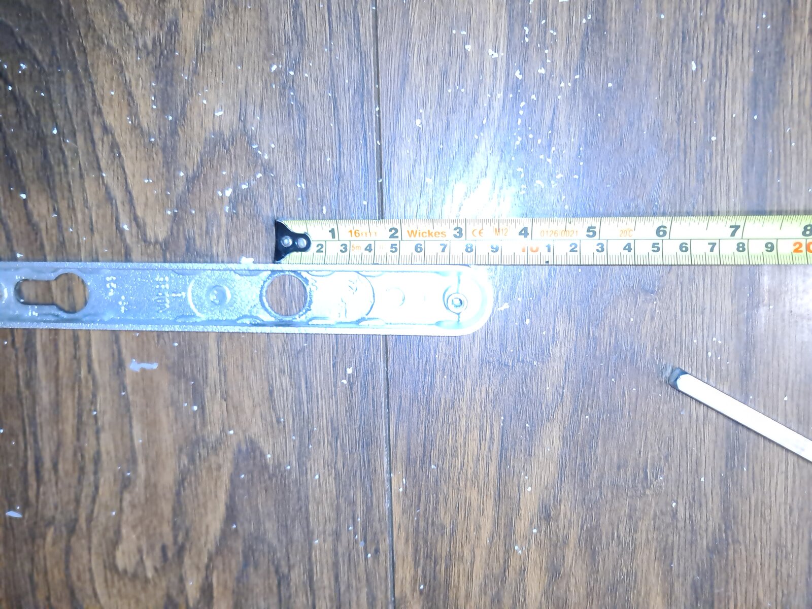

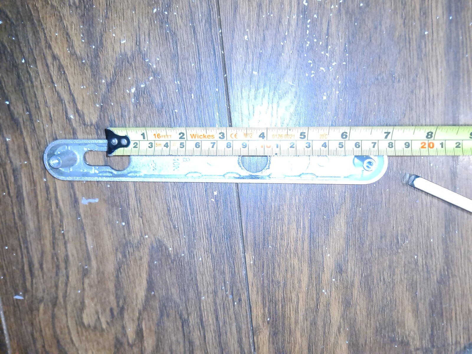

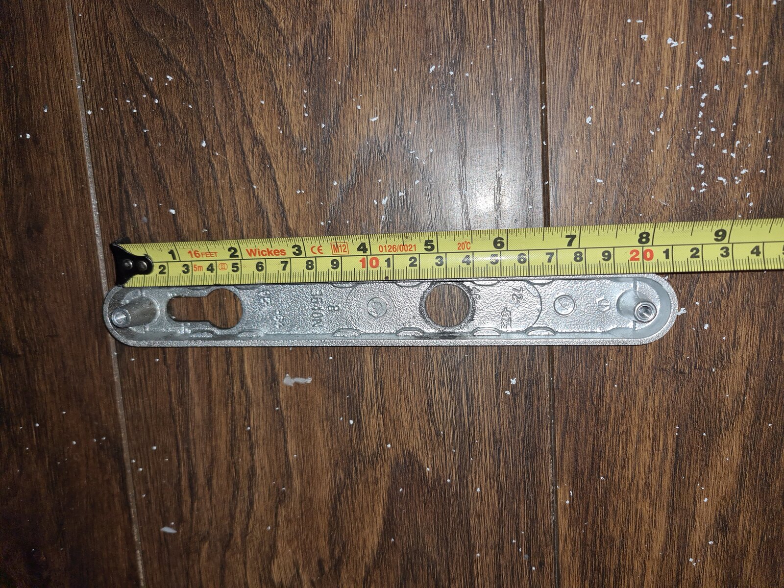

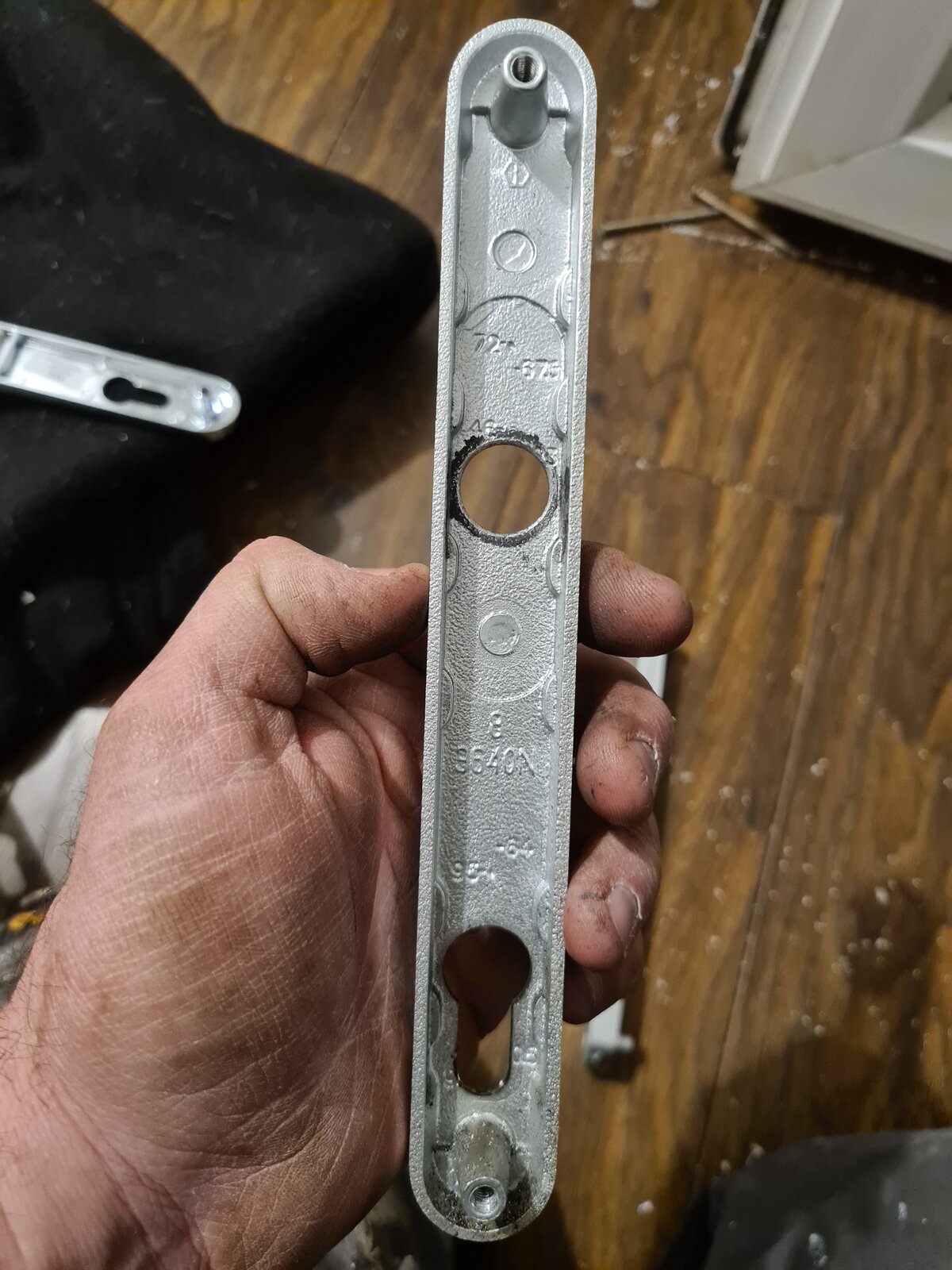

Can't find this handle anywhere,sorry about rubbish photos,any one know where it's available plz .
Can't quite make out the measurements exactly, but looks like 200mm screw to screw, 92mm centre of spindle to centre of circular part of barrel ( 92pz) and 70mm from top screw to centre of spindle ... if so this may well be it

Cheers photos are not the best I worked it out at between 87 and 92 .need a metal ruler next time
The hexagonal mark in the casting inside the handle suggests it's a 'Hoppe', googling Hoppe 3640N also returns results as a Hoppe Atlanta which is quite a common handle but has various variations i.e. 3 fixing or 2, yours appears to be a 92mm PZ as well

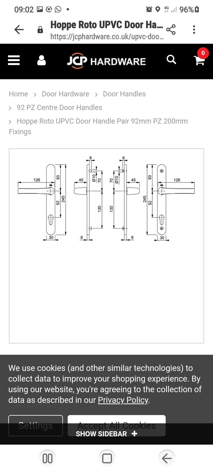

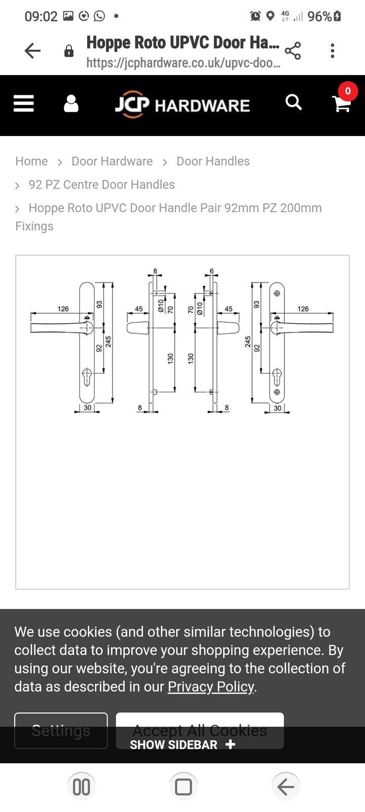

Thanks for that ,looking at this screen shot ,do you think this handle will fit ..thanks

Well that one is 245mm long, yours is 210mm however if all the other measurements line up then there's nothing stopping you drilling new fixing holes further apart
I thought with fixing holes in same place it should fit as 200 centres I was thinking possibly just more handle after screw top k bottom making handle longer ,but I'm new to all this so I'm not sure
Sorry my bad, the screw centres appear to be the same as well as all the other dimensions, yes go for it

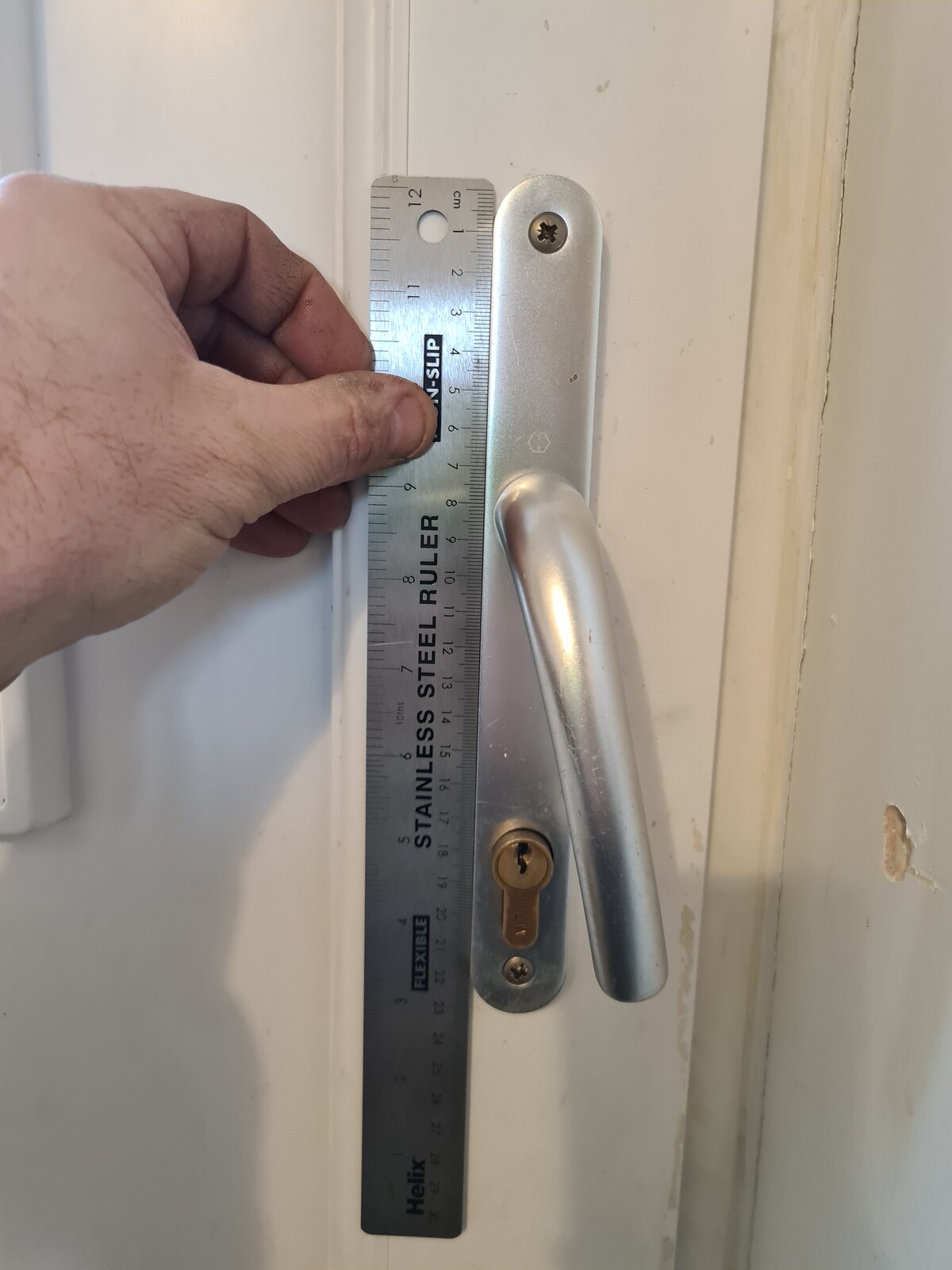

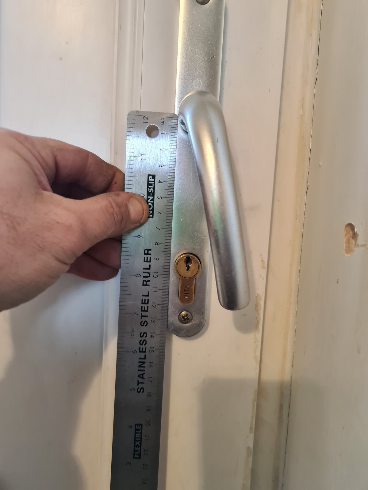

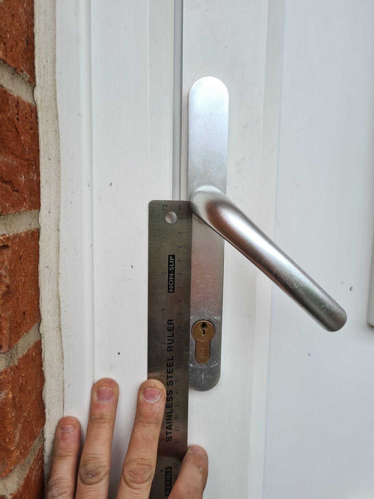

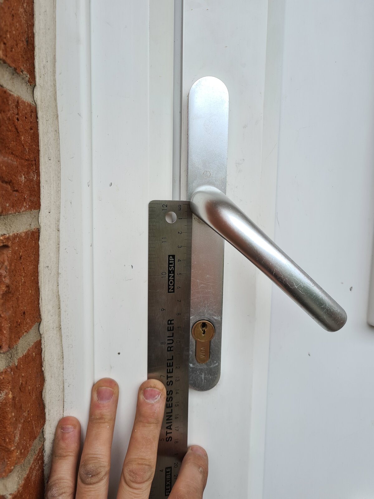

Hi taken new photos with metal ruler,looks like 95pz now and 202mm or 203 mm screw centre any ideas plz on which handle will fit
In 20 years of doing this, I've never come across a 95pz...I'd be pretty sure that's still a 92pz
From reading up only handle that is 95pz is one that fits a Millenco locking mechanism
I tried two 92pz handles,when putting one side on it pulls the spindle up.on the other side then the spindle and lock won't fit ,ot then looks out by a few mm
I see what you are saying and a trick to get the 92pz handle to fit is to leave the barrel screw loose whilst you put the handle on. From your own pictures of the original handle , as Crank said, it's a Hoppe 3640N , which is an Atlanta. With extra measurements you said its 202/3 mm from screw to screw, which fits the Atlantic perfectly. You have said only Millenco do a pz95 ( as I said in 20yrs never come across that yet , so fairly rare...). So therefore as Hoppe don't make a 95pz , it has to be a 92pz and the old handle identification tells us what it is. All the evidence points to the handle that I linked to from DgSupplyline in my post 2 posts ago
