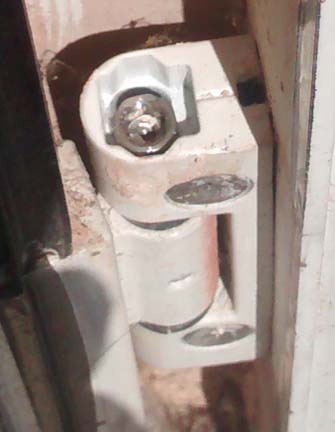

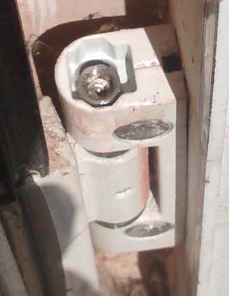

I need to take my back door off to fit the last piece of laminate floor but I don't know how to remove the hinge pin. Looking on youtube etc shows removing the security grub screw and prising the pin out of the top with a small screwdriver. this pin has an allen head which on turning has a cam effect on the hinge.
Could someone please tell me how to remove it.

Its called a butthinge but there are lots of makes that are all slightly different.
If you keep turning the bolts anti clockwise they may come out. It is likely just an oval shape at the top for additional adjustment

The hinges were wrecked in removal unfortunately. The bottom hinge section has a top hat that prevents the hinge pin from being tapped up from the bottom. I screwed the 5mm hex bolt in fully from the bottom - this raises the hinge pin to the point it can be grabbed or levered up from the top. In levering it up I wrecked the top hinge section, maybe needle nose pliers could do it neater. Anyway the hinges required replacement so I wasnt that bothered.

The rebates are different for each manufacturer, each profile section so my suggestion is just to use the hinge pins
