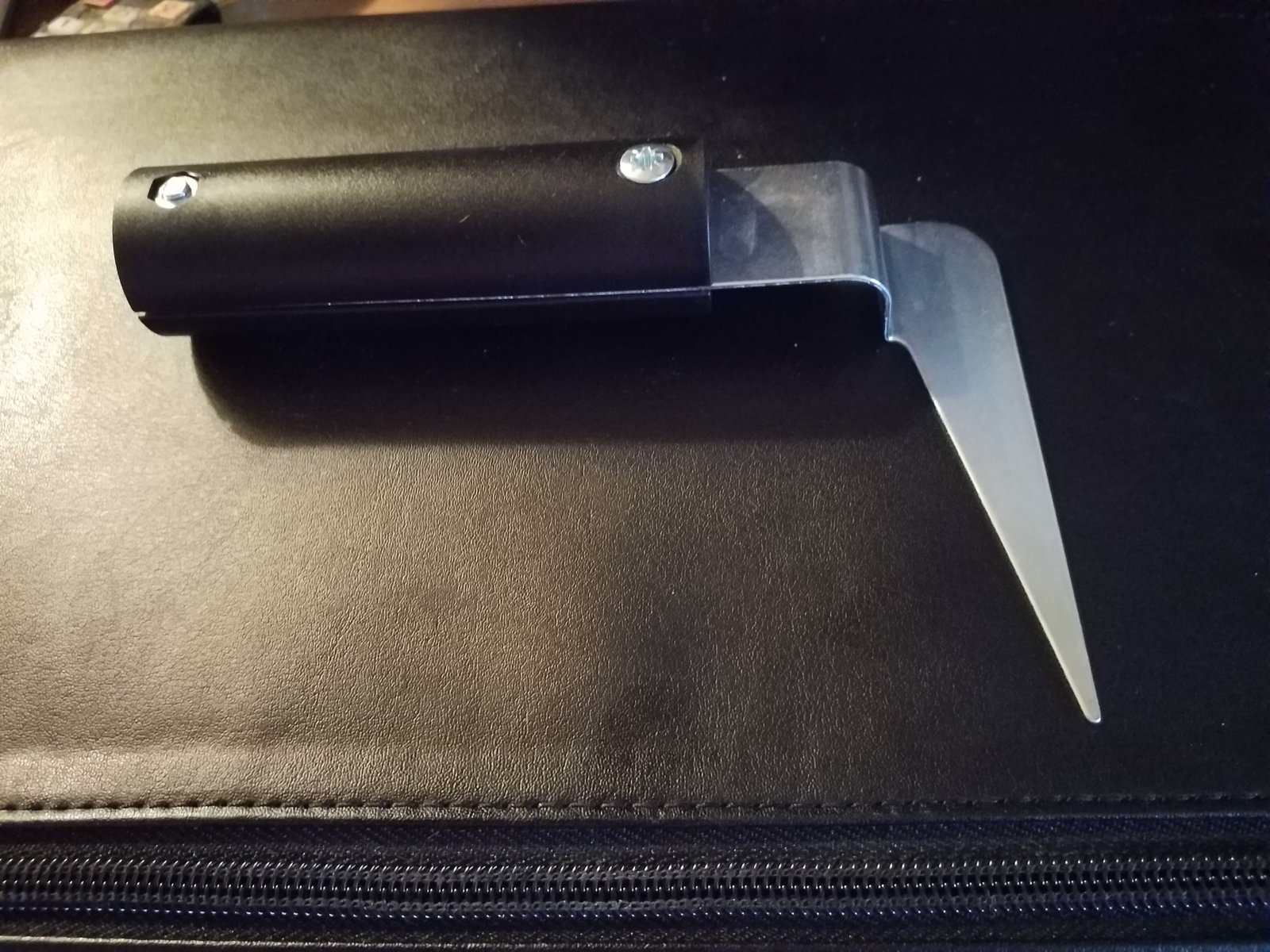

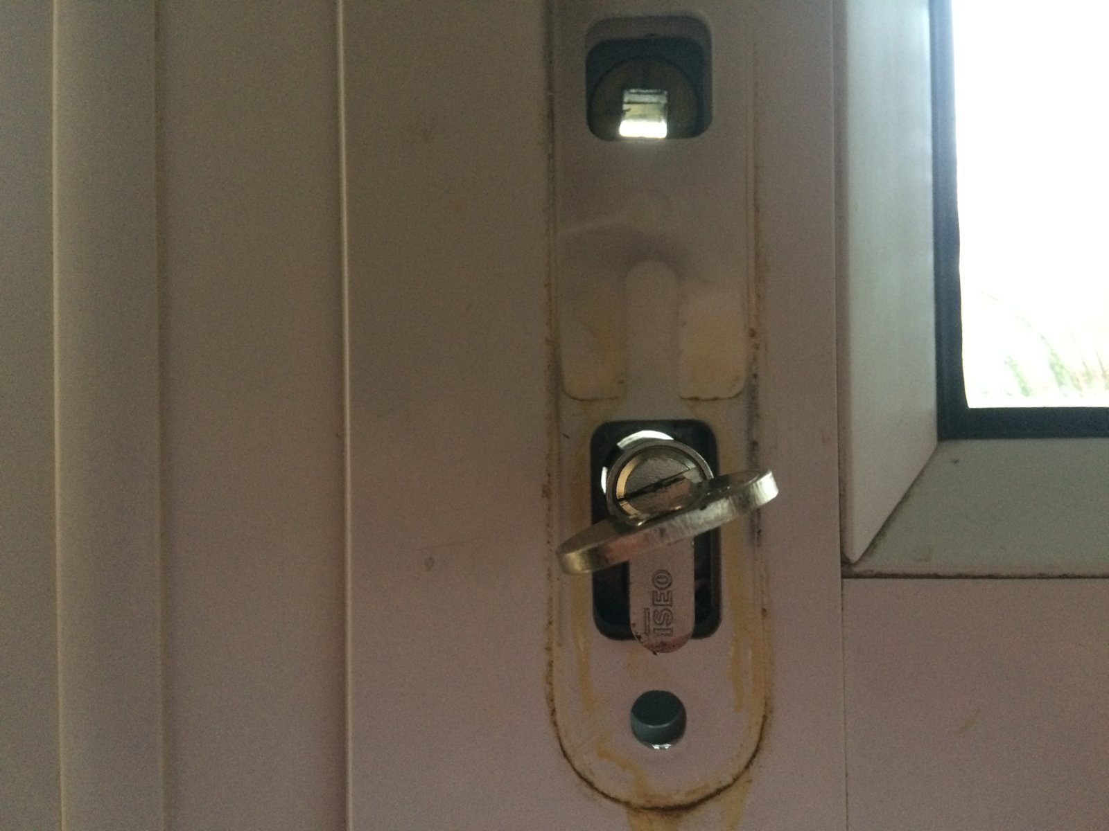

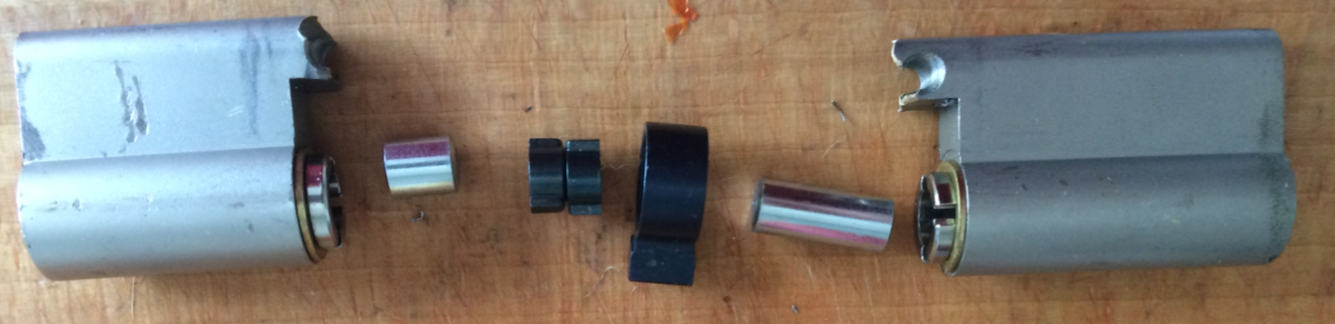

I've added three images: The first shows the cam in the position at which it jams, turning clockwise. You can see the cam between the barrel and the lock. The second shows the barrel in installation position, with the cam in line with the levers. The third is an image of the hinge, showing the inaccessible grub screws. The adjusting cap heads are 2.5mm Allen.
The barrel works fine, so I can turn the cam to the installation position and sheer the retaining screw without damaging the barrel (theoretically). However, I have my doubts as to whether or not I'll be able to open the door with an allen key, since the cam on the barrel is essentially doing anyway. I may try this regardless, since I have a spare retaining screw and it will at least get me closer to the lock. Failing that, any thoughts on removing the hinge pins?

You're a prince amongst men! I ended up snapping the lock. Anti-snap my ass - two swings with an adjustable spanner and it snapped off (from the inside).
So I took the mechanism apart, and have found the issue. Part A on the image below should return completely, pushed back by the spring. It is not returning completely because the grease is set solid - it's like plastic. This last bit of movement ensures that the deadlock pushes home completely, and that did not happen. This resulted in the cam not engaging the slot correctly, but instead hit up against B marked on the image below. There's no additional sign of wear on the lock. So I've left it soaking in some GT-85, and will clean it all up after a couple of hours and regrease it when I get back from the locksmith with the new barrel.
