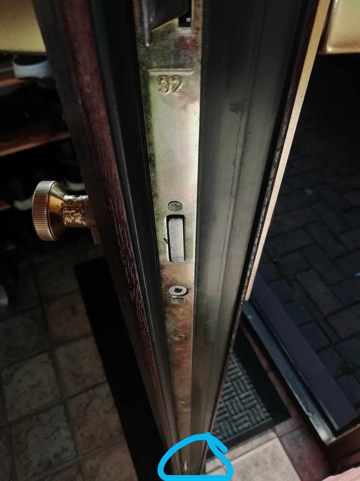

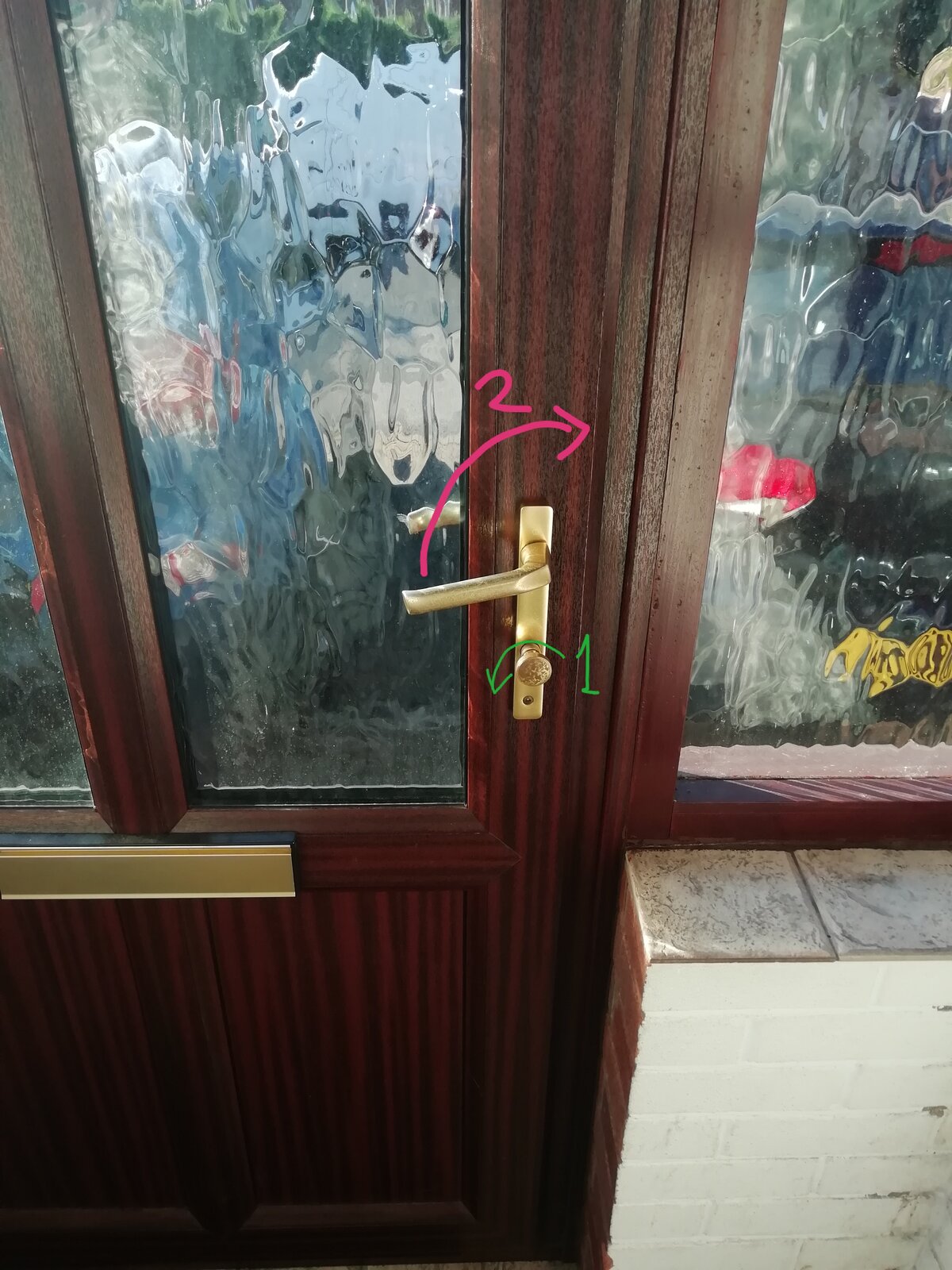

My uPVC front door keeps jamming (won't open to let me out).
Opening the door is a two-step process...1. turn the knob anticlockwise. 2. Lift up the handle.(see picture)

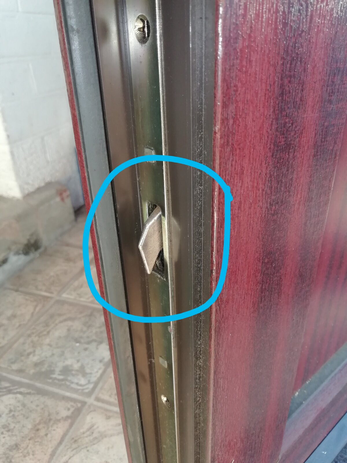

However, when I lift the handle, the "claws" (one near the top of the frame and one near the bottom) in the door frame don't fully retract (see picture) & it takes several attempts of lifting/lowering the handle to retract the claws.
Don't see this getting any better with time, so does anyone know a fix? I could try removing the brass strip down the edge although I'm not sure what I'd find doing that. Maybe put oil on it or something.
Any help appreciated.

Step 2...raising the handle should retract the claw into the body of the door. But what's happening is that the claw remains partially exposed, meaning the door won't open when you press the handle downwards.
I know the manufacturer so I might contact them or look closer at the brass panel see if there's an identifier.
Edit....just had a look and the locking mechanism is made by WINKHAUS.

You are correct. I made a daft mistake in my initial description...to open the door does NOT require lifting the handle....you just turn the knob anticlockwise and push down on the handle. This push down should be enough to retract the claws into the door, but they remain partially exposed (and jammed into the frame) When this happens, I need to lift the handle up and down a few times to get the claw to retract.

The fact that both the upper and lower claws don't retract, it might just be the central gearbox you need - The assembly with the lock and handle. Rather than the claw sections as well.

Yes, neither claw retracts fully and, in fact, are left exposed by more or less the same amount. Good detective work, maybe it's just the gearbox that needs changing. Cheers

If the claws remain partially engaged i.e. not fully retracting then it points to wear in the either the centre gearbox OR both hook/claw gearboxes

To open the door, I turn the knob anticlockwise, then push the handle DOWN. This should work but doesn't...the claws are still partially embedded in the door frame. To coax the claws into fully retracting, I have to raise/lower the handle a few times. Eventually the claws retract and I can open the door to get out.
Yes definately wear in the gearboxes then

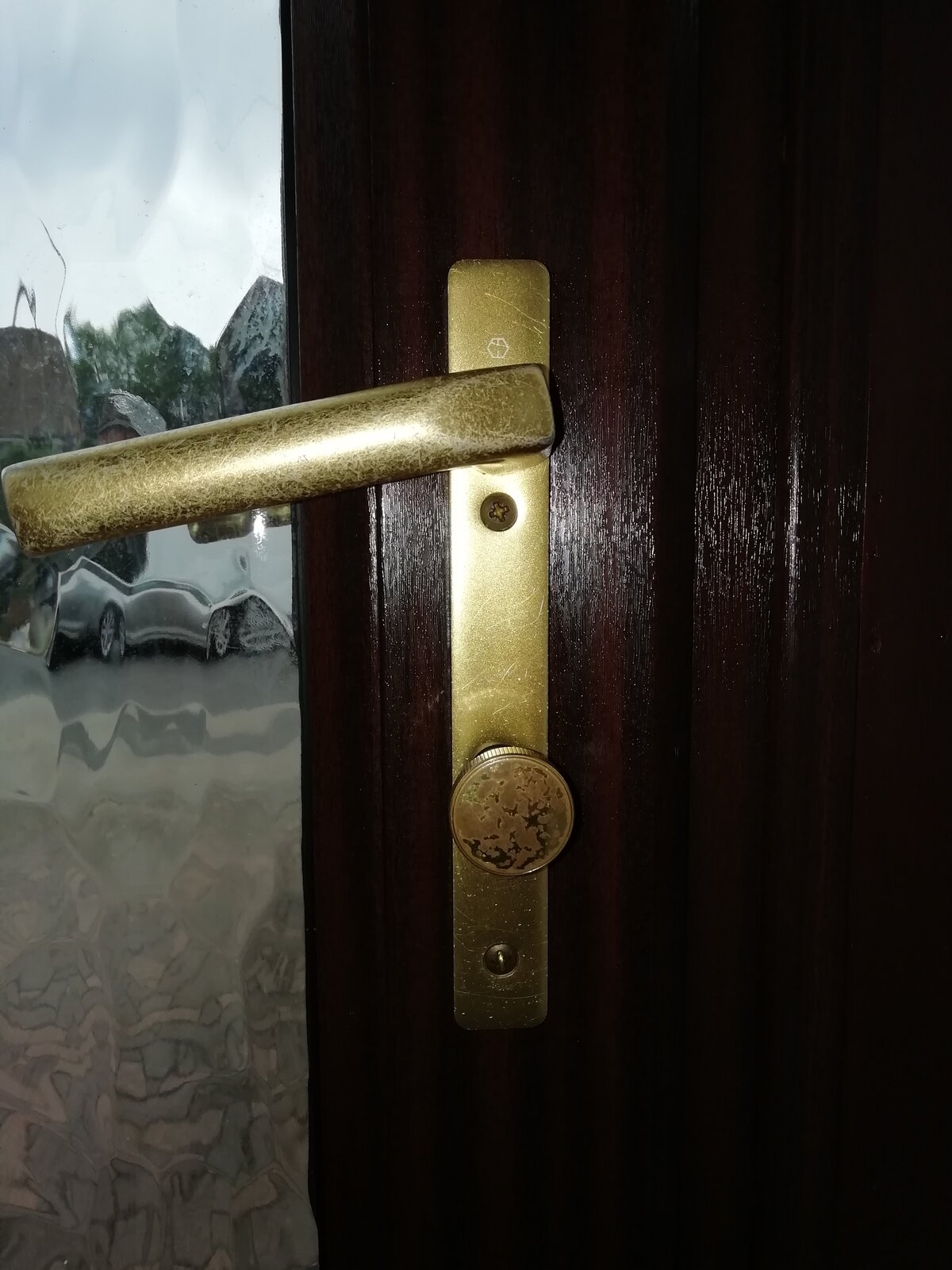

I notice that when the door is closed and locked, the handle sags downwards rather than being horizontal. Maybe that also implicates the gearbox.
