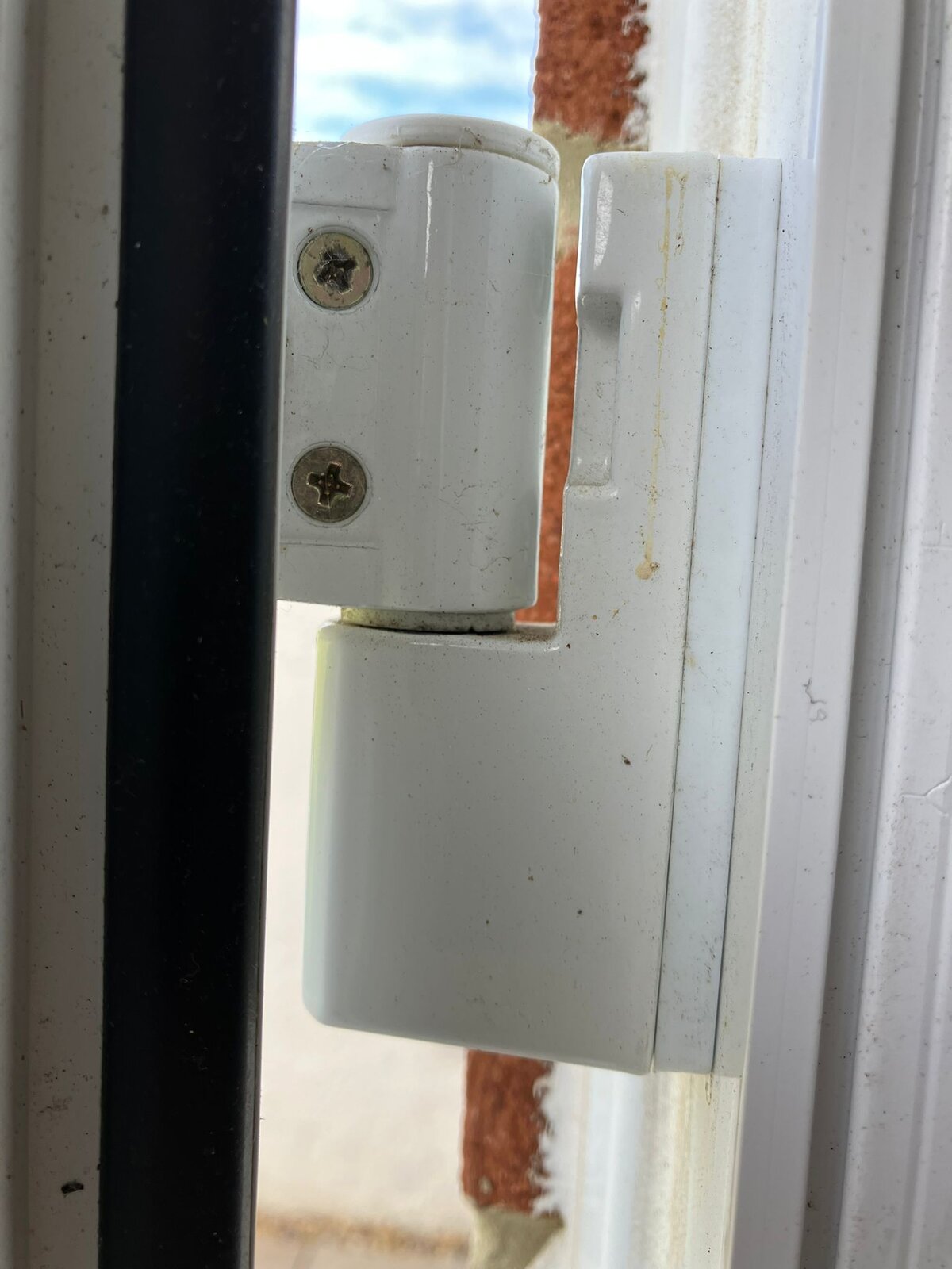

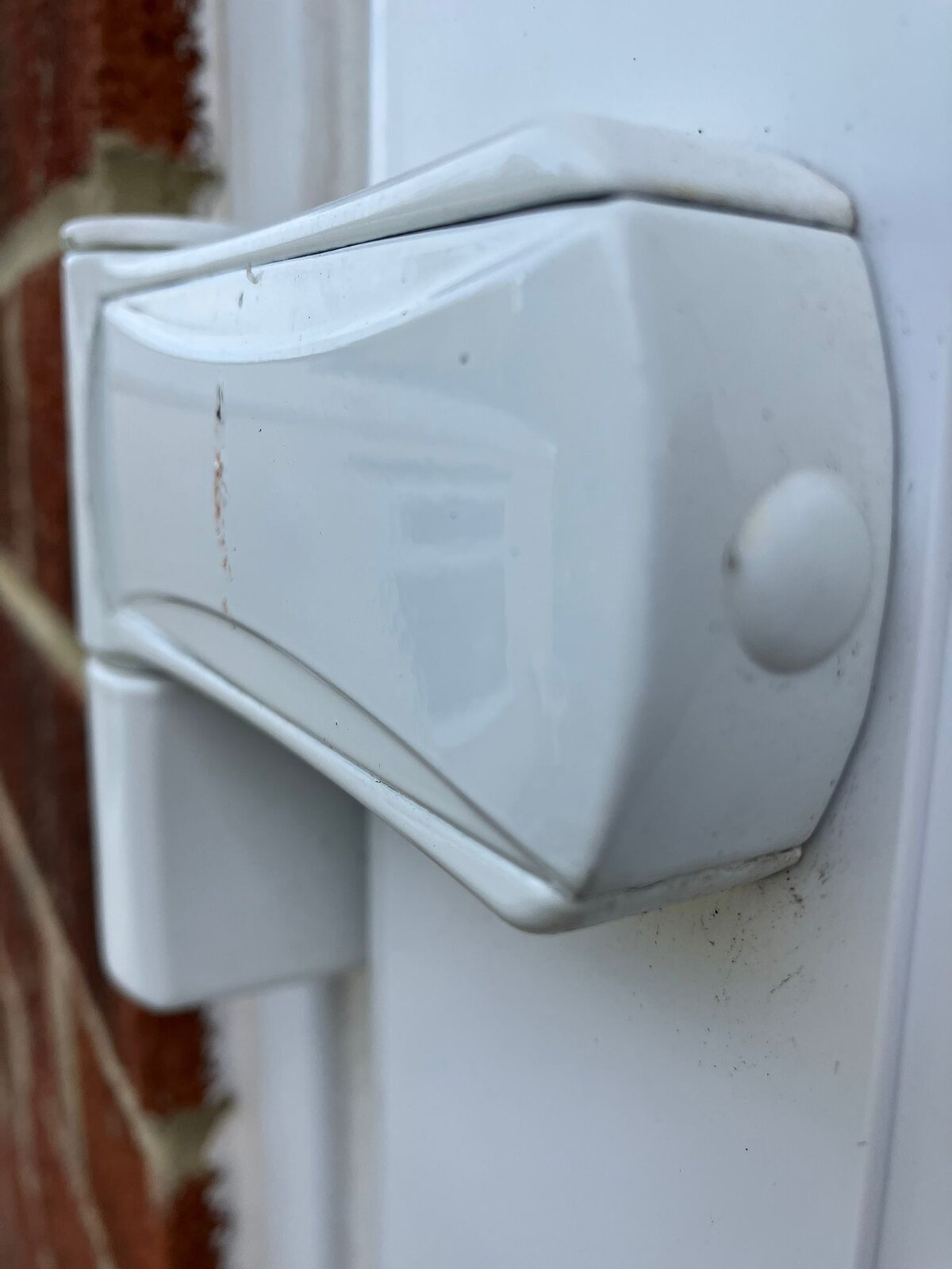

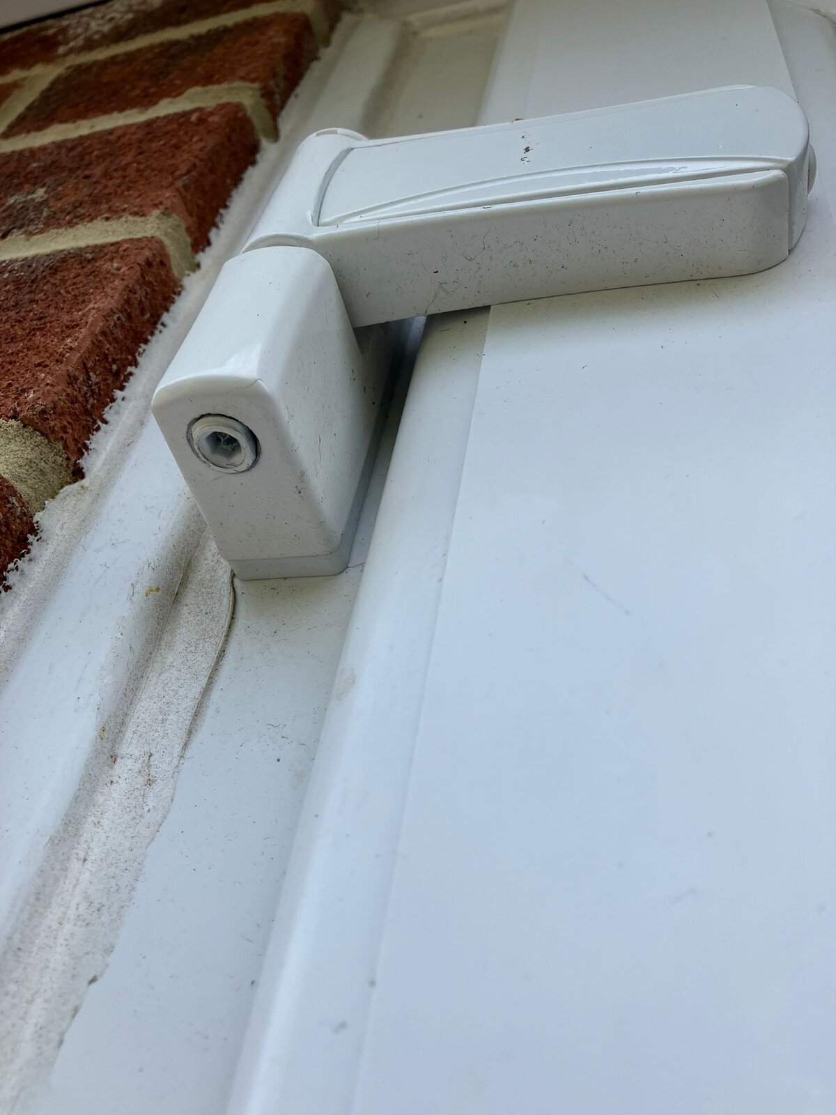

Many thanks everyone. All sorted now. Now to try and work out how to align the door. Will try searching for some videos on how to adjust this. Any suggestions on guidance videos?
here are the photos....
grateful for any help
Prise off the white cap on the end and you should see an Allen key hole. Will be one on all three hinges, they will.adjust the door laterally. Under the hinge on the frame is another Allen key which will adjust the height. Mark where the door is sitting with a pencil.in a few places before you start ( so you have a datum point if all goes wrong ) and only adjust by a quarter turn at a time
