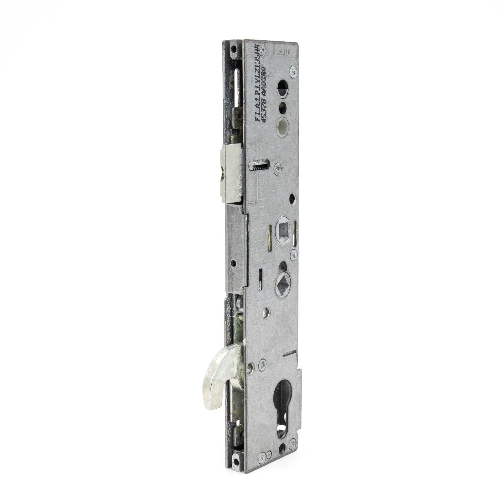

Hinges seem fine , noticed even with door open the centre hook does not fully retract, stays out around 10mm , worn mechanism?
Yes very much so, depending on the mechanism you could potentially just replace the gearbox
It’s a lockmaster bar in the door , looked at a video , seem to be I remove bar , Philips head screws, (the torx head appear to hold in the lock)? And the replace with something like this.
How do I ensure I get correct replacement ?
Are there key measurements?
Only really the 35mm backset and the 92mm PZ
But make sure the replacement gearbox has the hook going the same as your original, some hooks point up, some down, its an easy oversight
Thanks.Replacement next week .
