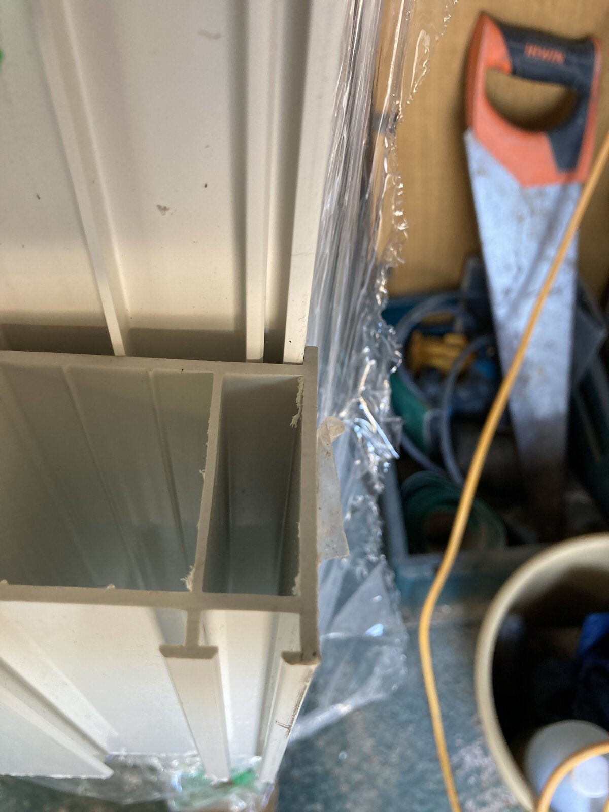

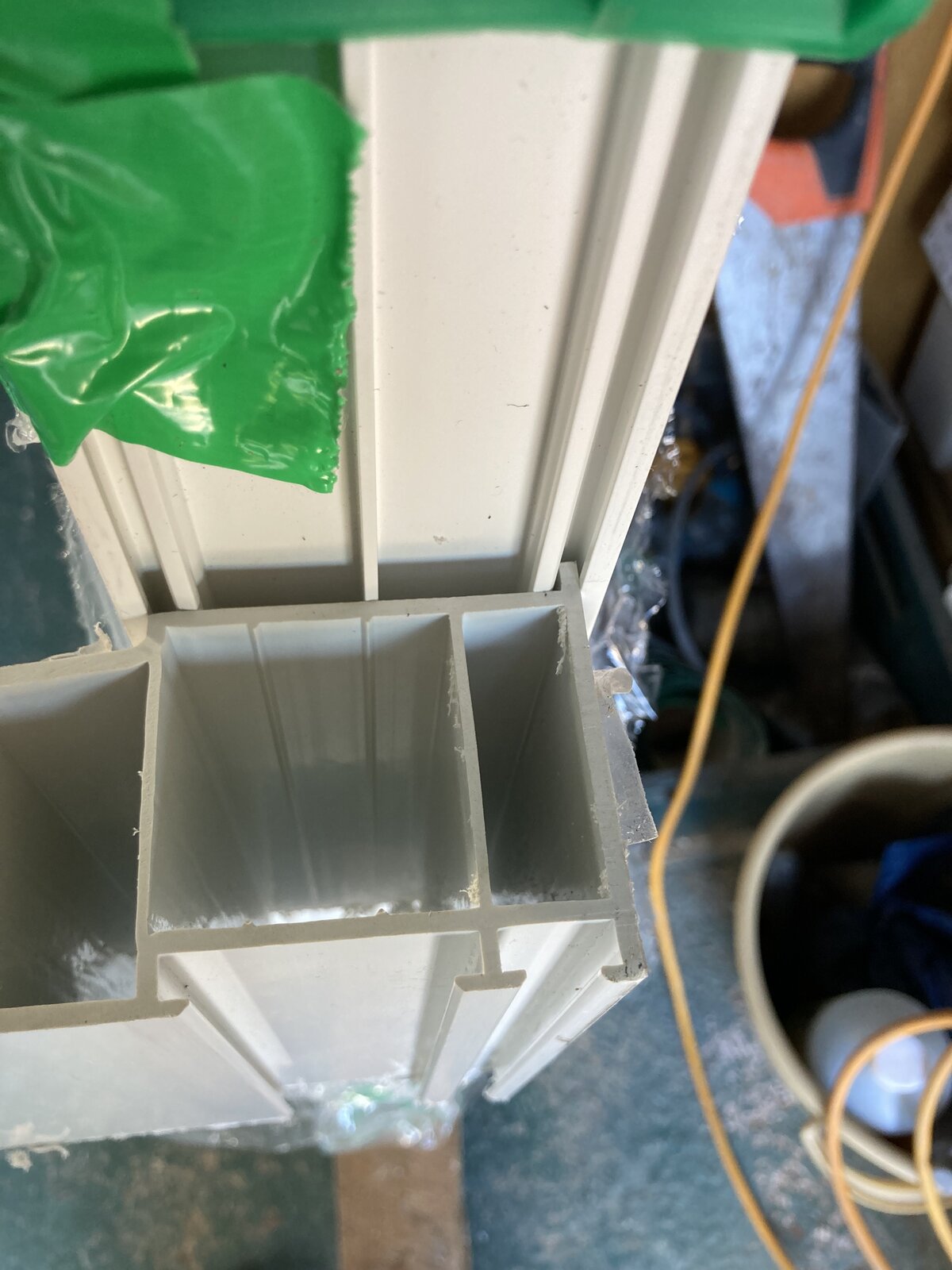

After laying the cill I am looking at how the door sits on it.
Seems I can rest it just inside a raised lip or use a rebate in the door to slot on to the cill. See photos.
My question is which one is right in the rebate or inside the lip.
I have used an off cut from the cill in the pictures.
15A46B42-A9EE-4182-AE97-96951030AC21.jpeg 17FF0362-16F5-4ABC-B322-8B2ACF95C27B.jpeg
As per first picture, note how the outer groove on the door frame overhangs the flat on the cill, within that groove is the concealed drainage, if you fitted as per second picture the drainage slots would be obstructed

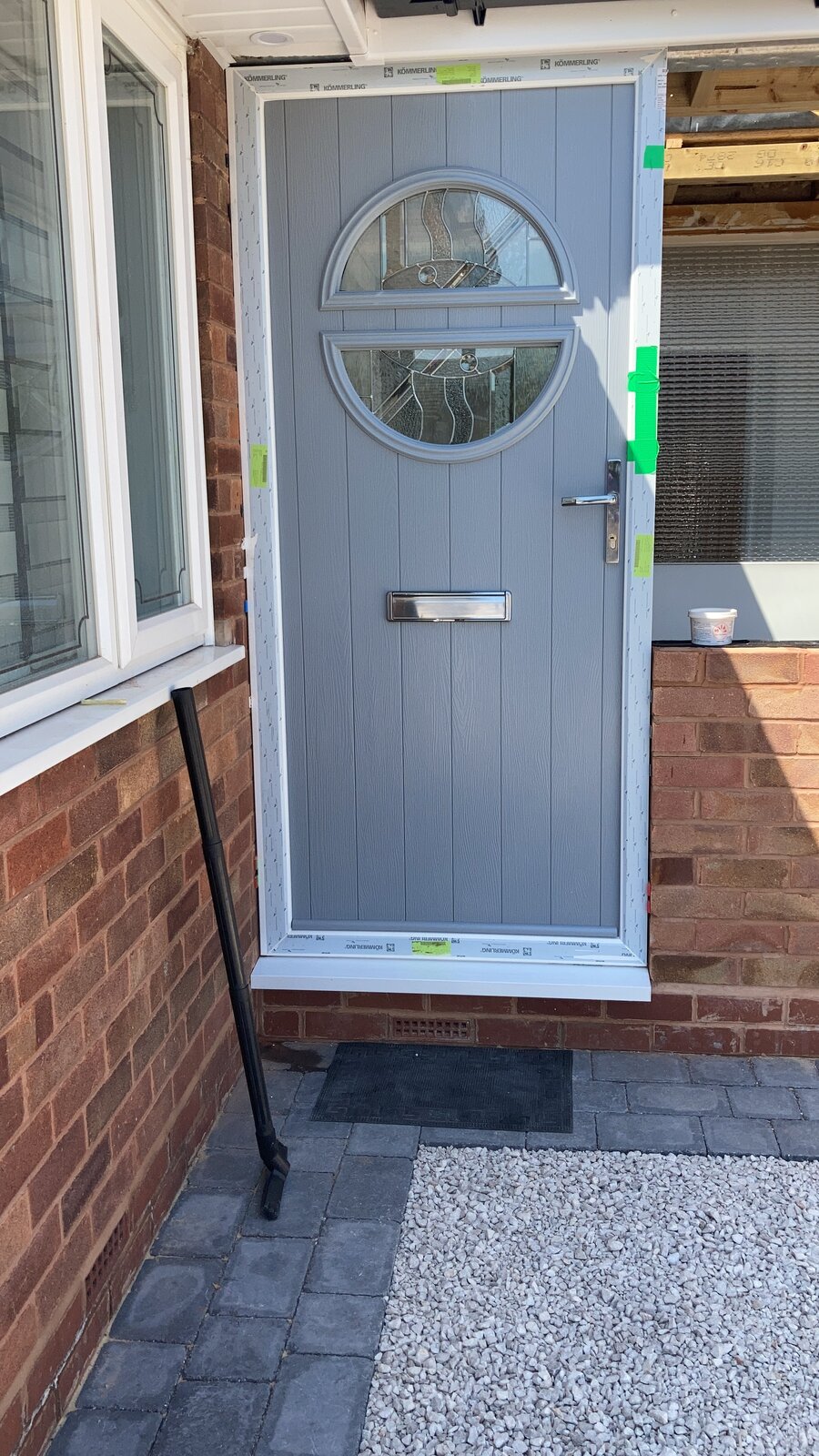

We got the door fitted. Thank you again Crank39.
we are looking at the window now and apparently I need a coupler and some trim to join the window to the door.
What shop would sell couplers and coupler trim?
West Midlands area
Have you already got the window? Coupler depends if you've accounted for it, if you already have the window will there be a gap between the two to fit a coupler?
To buy one try where you bought the door from, or there's online places like window ware, truly pvc to name just two, there are various types of coupler, basic plastic H section right through to heavy duty aluminum ones with white clip on covers which can be quite thick, they stop the door frame 'whipping' when closing
Thank you. I didn’t want to order the window until I saw the door in and couplers ready so I can measure the gap.
I think now it’s the metal ones with covers I need. So will try those online places mentioned. TimerCompositeDoors doesn’t do the couplers.
