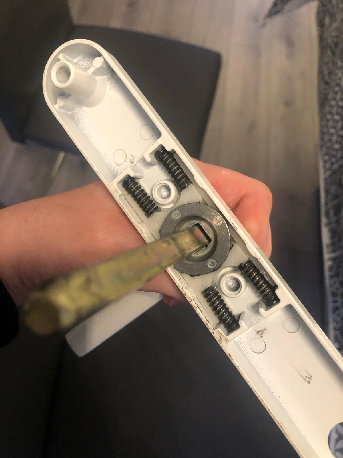

Hi all
My upvc patio door handle is not working properly (it doesn’t ‘spring’ and makes a crunch noise) when moving the handle to open/close. The lock works fine, however, i’m keen to fix it properly.
I have attached an in image of the spring component. Does anyone have any advice on where I could find a replacement part (assuming this is the what needs to be fixed) as I have not been able to find one online. Any other advice or suggestions what could be broken would be welcomed and appreciated. The door is 3 years old.
Cheers Paul

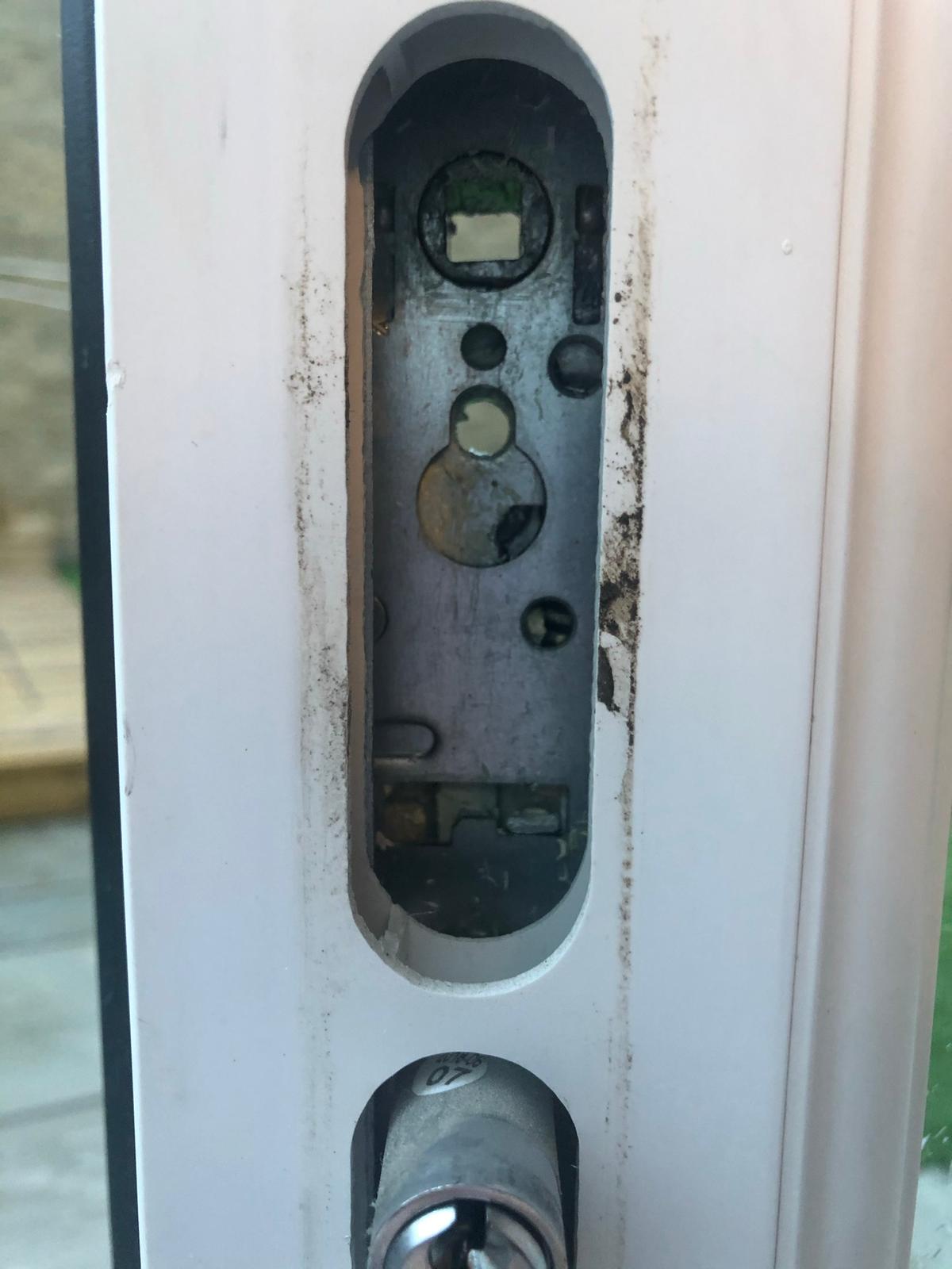

Doesnt look much wrong there, whats the one on the other side of the door like?
Thanks - I have added some additional pictures. I think it may be the actual handle rather than the springs.

When the handle are in your hand does it work smoothly, if so its probably the gearbox. Link is just to show an example.
I took the handle off and it still made the noise and wasn’t working properly - looks like it is the handle that needs replaced.
Thanks again for your help lostinthelight
