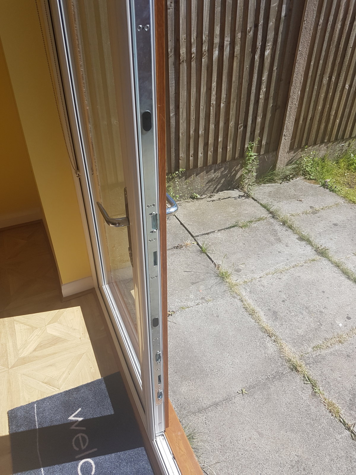

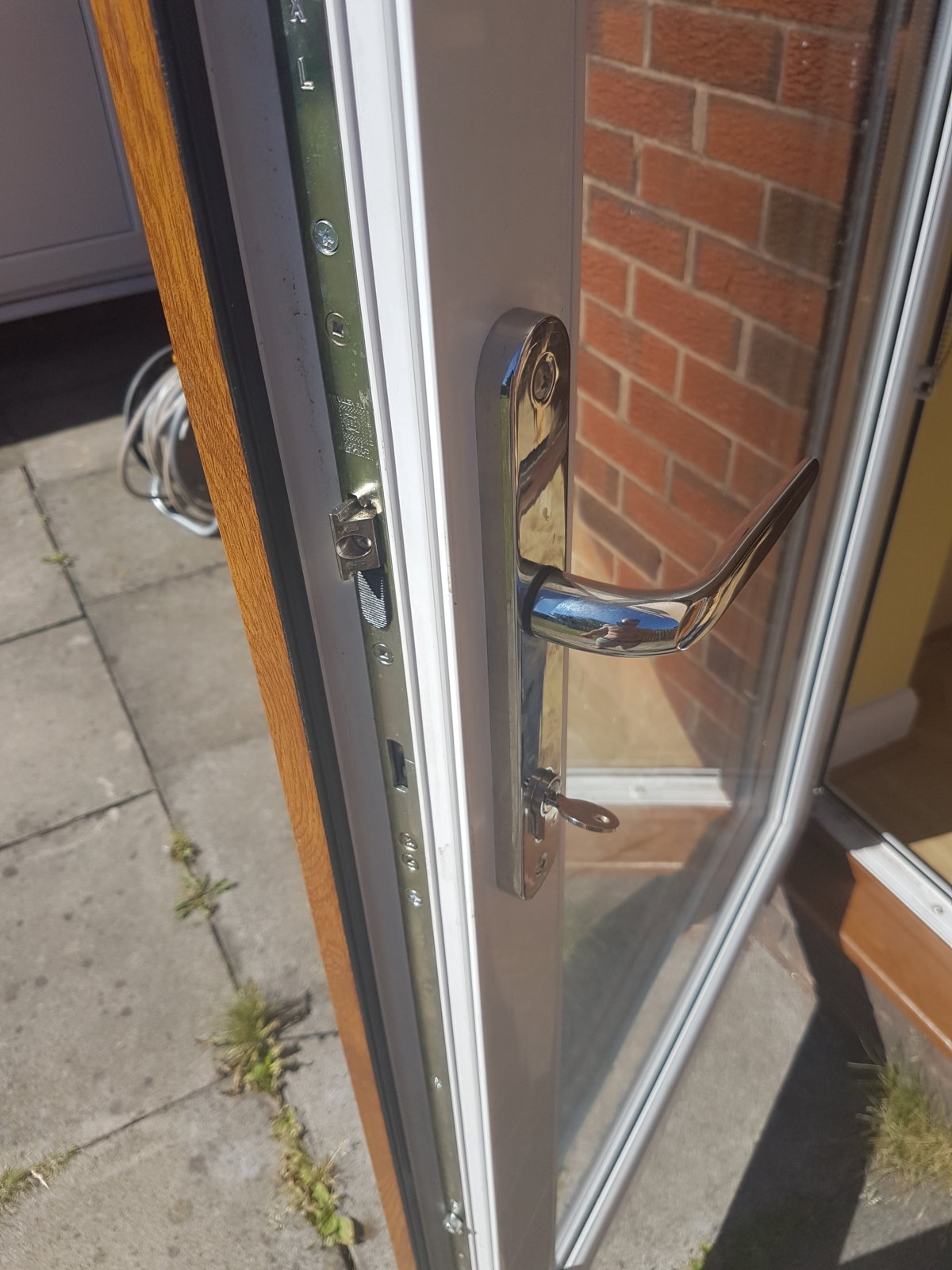

Hi everyone. Upvc patio doors in my house are a pain to lock. I have to not only hold the handle up but really push it up hard to enable me turn the key to lock it. Question is what's worn, damaged or out of adjustment. I should surely just be able to shut the door, lift the handle to engage the mechanism, release the handle then turn the mey to lock. Any help welcome

Fell at the first hurdle they're french doors. Pics attached

I expect the strike / hooks arent engaging in the strike plate, it stops the mechanism moving up enough for the euro cylinder lug to turn.
Easy to confirm - does the door handle raise and lock easily if done with door open.
As above if they operate and lock easily when in the open position then the doors have probably dropped and just need adjusting or "toe & healing"
They look pretty new, Will the fitters not come back and adjust them under guarantee? Best to give them a shout first.
Its a 10min job for someone who knows what they are doing
I suspected that as the bottom of the door wasnt fitting up and engaging the latch to pull it in. Ive adjusted that but no difference. If i open the door and try to lock its exactly the same. Cheers for response so far. Im a curious guy so like to tackle this myself if possible
