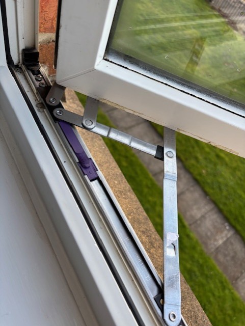

I have a 2 panel UPVC window, the left hand panel opens from the centre out to the left.
Unfortunately when it is closed although it appears tight against the seal where the handle is the other end has a large gap.
I attached a picture of the bottom hinge (the top is the same) but a cant see how there is any adjustment in it. I,m guessing it requires a toe and heel adjustment to pull that end tight?
Any instruction on this would be greatly appreciated.

Toe and heel is only for lifting the handle side up in case of settlement, the hinge side can't drop as it's fixed, if you mean there's a gap against the gasket on hinge side even when it's closed then it's very likely worn hinges and will need replacing as a pair
Crank thanks for that very useful info. And i am correct in thinking these types of hinges have no adjustment?
And yes you are a correct theirs a gap against the gasket on the hinge side.

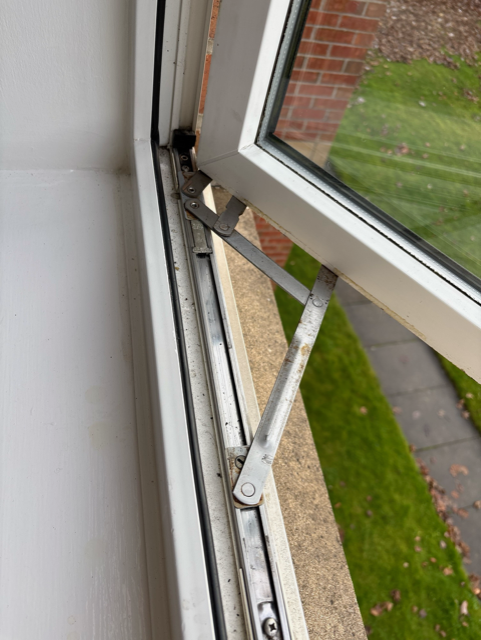

Its difficult to see any ware on the hinges, i cant imagine this particular window has had much use apart from just being cracked open a few inches. Any thoughts on that gents?

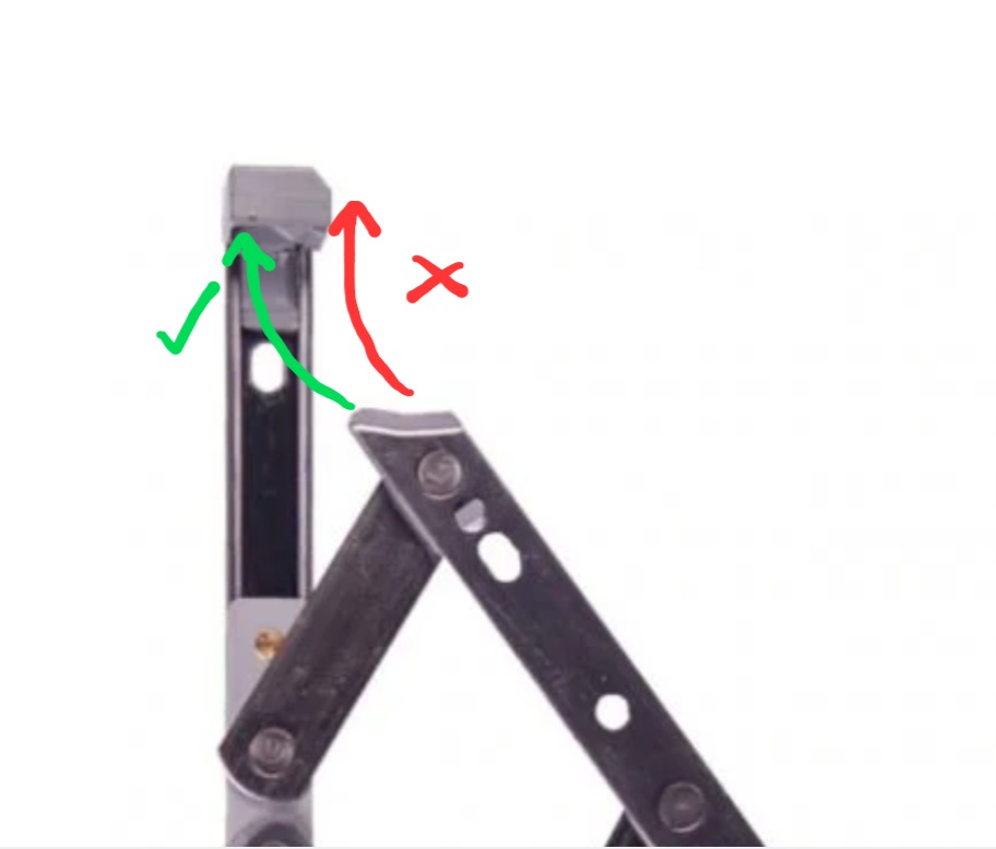

The wear will be be throughout the guides and rivets which in turn causes this V point not to locate in the corresponding V cup and it rides outside hence the gap you get, sometimes a smear of vaseline in the cup can help. Close the window till you can barely see the V going in the cup and you most likely see it's not locating

You cant see the wear but if you open the window fully and grip it on the outer and inner side frames and give it a hard pull&push you will soon see and hear if there is wear.
