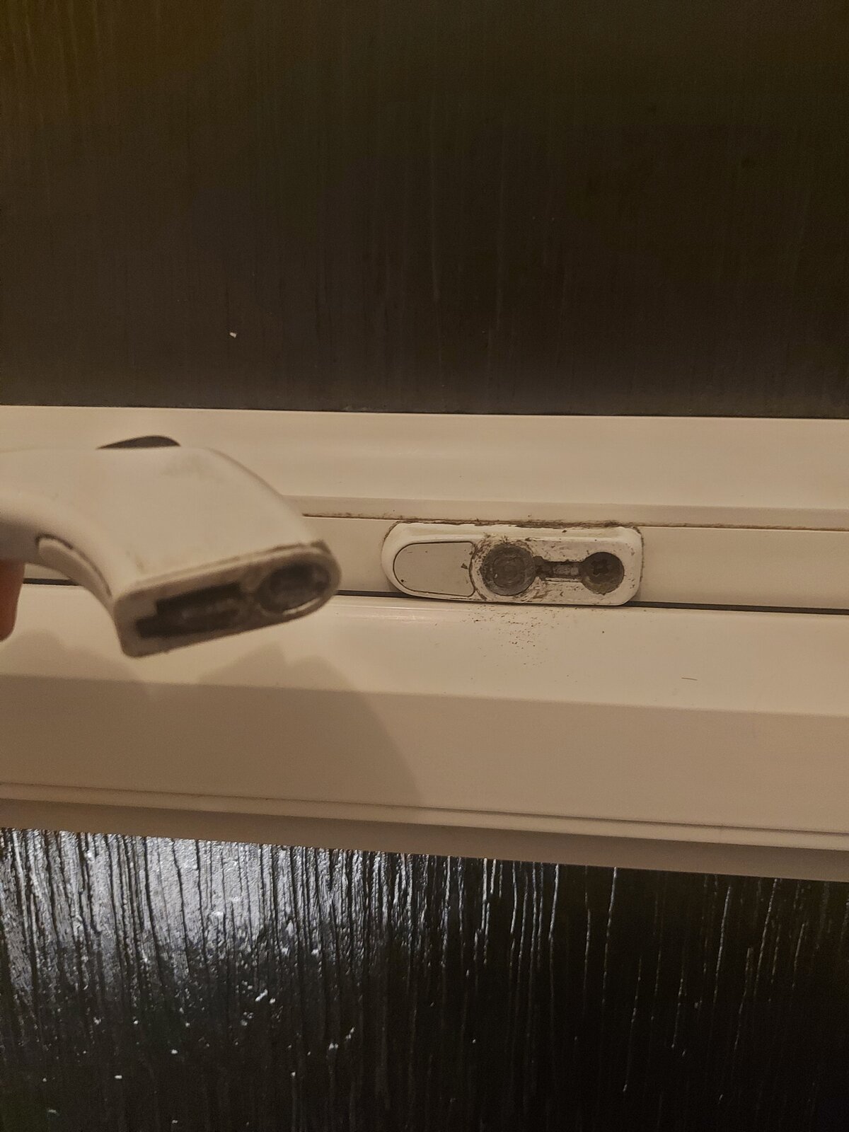

Hi
Please can someone help my window handle just snapped off I dont even know what type it is

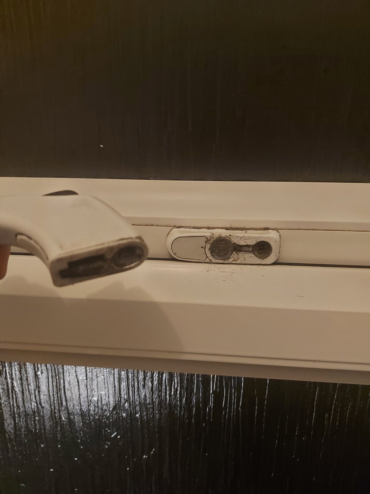

Hi
Your handle doesn't have an offset, something like this may do:
https://www.screwfix.com/p/smith-locke-lh-rh-prolinea-espagnolette-window-handle-white/2599G
My preference would still be for a R/H offset, as above - it has a positive stop in the closed position and gives more space for your hand to grip the handle.
However, for you and for @Croftie , if you have broken handles, this might suggest that the force needed to open and close the windows could be too great.
You may wish to look at lubricating, adjusting and checking the mechanisms for damage.
